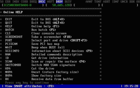

Your 32MB capacity issue is sometimes reported by users after attaching a 1TB drive, of any brand, to a Gigabyte motherboard with an Xpress Recovery BIOS. In such cases the full native capacity will be restored by HDAT2. HDAT2 should also tell you that a HPA is active.
If the above scenario exists, then any replacement drive of 1TB capacity or greater will also be truncated by the same BIOS bug.

I have the same problem, my WD 1Tb "green" drive shows as 30mb, randomly. I'm pretty sure it is an HPA problem.
I'm having trouble restoring it's capacity because it is the only HDD on the system and I have since zero'd it out using killdisk (in an attempt to resolve the problem).
I have been using a flash drive to try different boot-up programs to remove the HPA (I use my laptop to set up the flash drive). I've seen multiple posts saying how ultimateboodcd or MHDD programs have resolved their issue (the same issue i'm having). However, these posts will just read, "SUCCESS - MHDD resolved my problem! THANKS" and are very uninformative from that point.
I've tried both of these programs and once I boot to them I cannot figure out what commands they are running to identify max LBA and how to set it to max. I just see a bunch of menu items that mean nothing to me.
I cannot use HDD capacity recovery tool since I do not currently have an OS. Also, all my boot programs must be ran from a flash drive h2dat seems to not work with flash drives, I've tried the CD image and the floppy image seperately.
Could someone explain how to navigate in either ultimatebootcd or MHDD to remove my HPA? I'm fairly literate, but these programs bring a whole new level of difficulty without having thorough guides for menu items, commands, and how to execute.
Note: I'm not concerned about data recovery. I would only like to recover a 1Tb drive to continue using it

In MHDD, hit F1 to get a list of possible commands. Or, you know, read the documentation.

Here is what I want to do, but I'm not sure how to do it:
1) boot up with MHDD
2) select my HDD
3) read its max size
4) set its max size
My 1TB HDD only displays as 30mb and I feel an HPA has somehow hidden the rest.

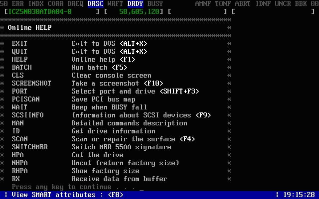

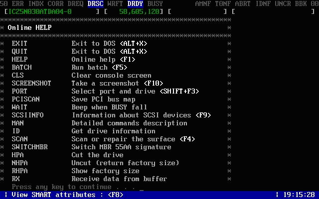

Since it looks like the previous pic host is having issues, here is that picture again. It shows a list of commands that MHDD has and what they do. If you can't figure out how to get where you want to go with that, then maybe it would be a good idea to get a more computer-oriented friend to help you out.
