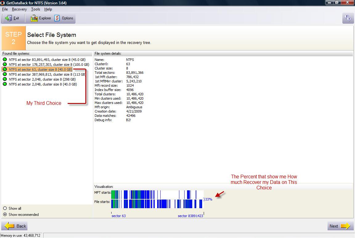

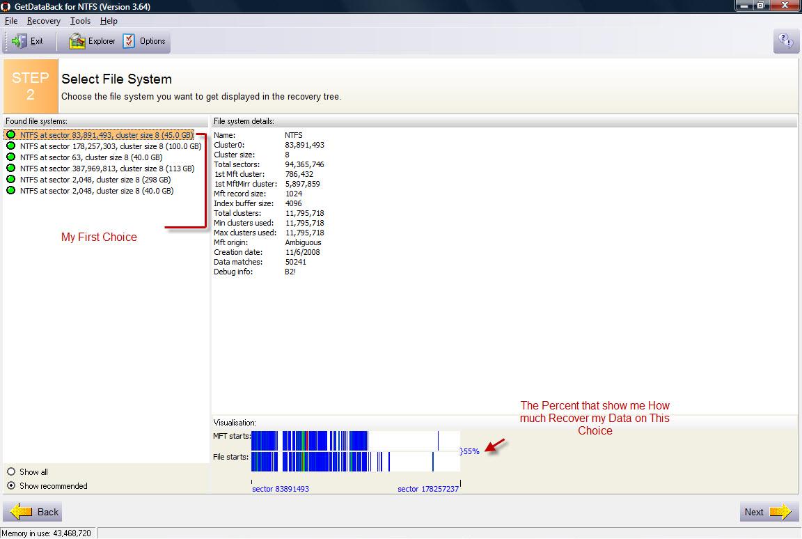

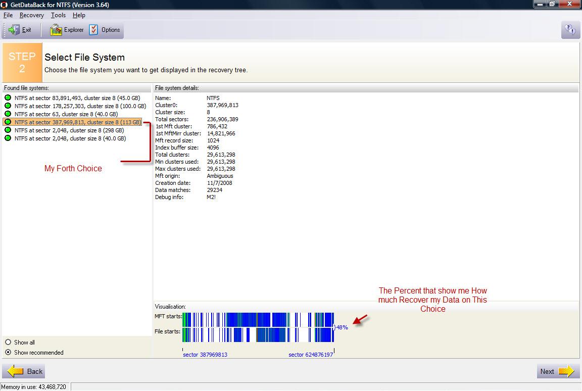

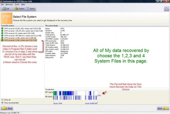

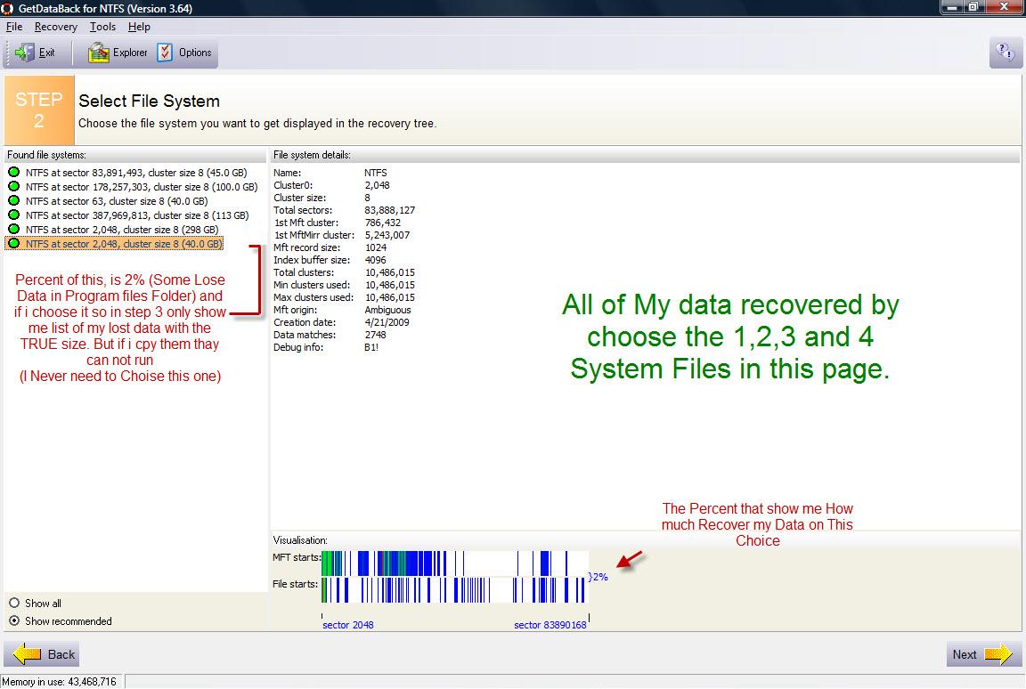

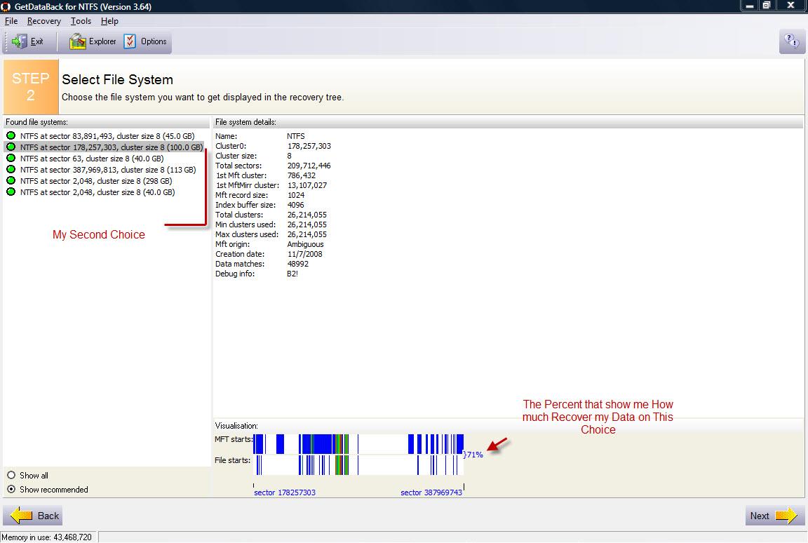

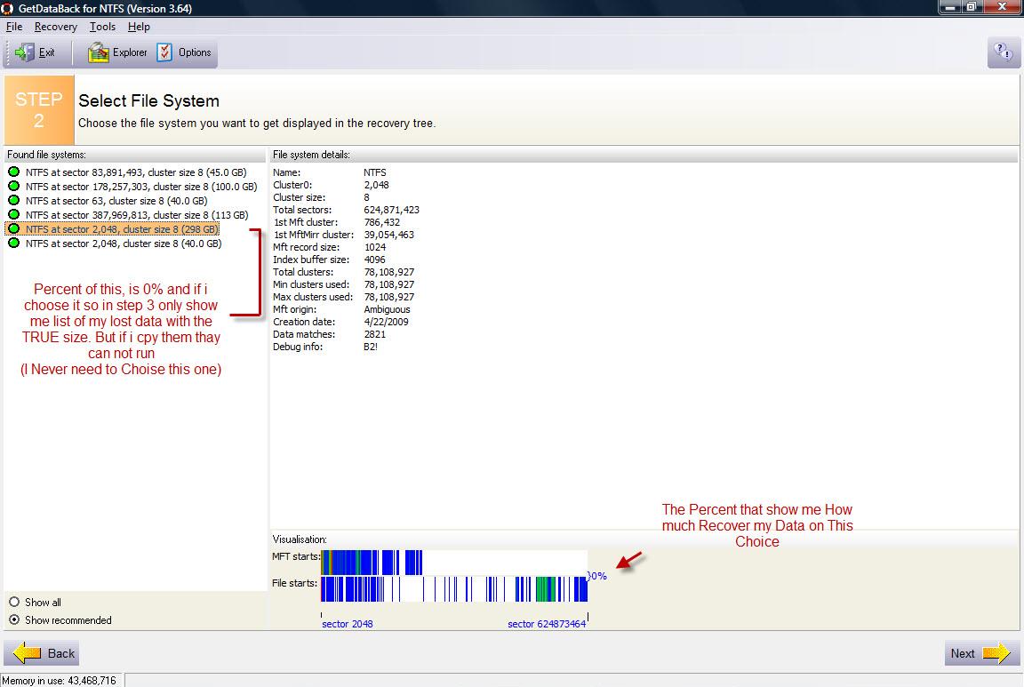

Dear Spildit, Dear poehere and Dear beto,
Thank you very very much,
I can recover and copy all of my 320 GB Lost data in original files and folders location with GetDataBack 3.64 :P
I scan my HDD with GetDataBack in step 1
and in step 2 i saw that i can choose the file system to get display of recovery tree. at the first i choose that one show me all 298 GB, But now i know that it choice can recover 0% of my data. So i understand one thing. back to step 2 and this time i understand that i can recover my HDD by Percent between MFT Starts and File Starts. that percent means is all of my data can recover in multi sections. so in step 2 i choose the titles that show me most percent and in the every choice i go to step 3 and copy a piece of my data into my new HDD. Finally i could recover (Copy) all of my data in 4 Section in my new HDD in the Original Files and folders location.
I think my english is not so good. so i upload this pictures for better understanding.
and now i really recommend GetDataBack to every one for recover lost data. It's very very powerfull. i can't belive it that can Restore 320 GB of my Lost data.
thank you so much again friends
