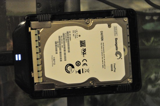

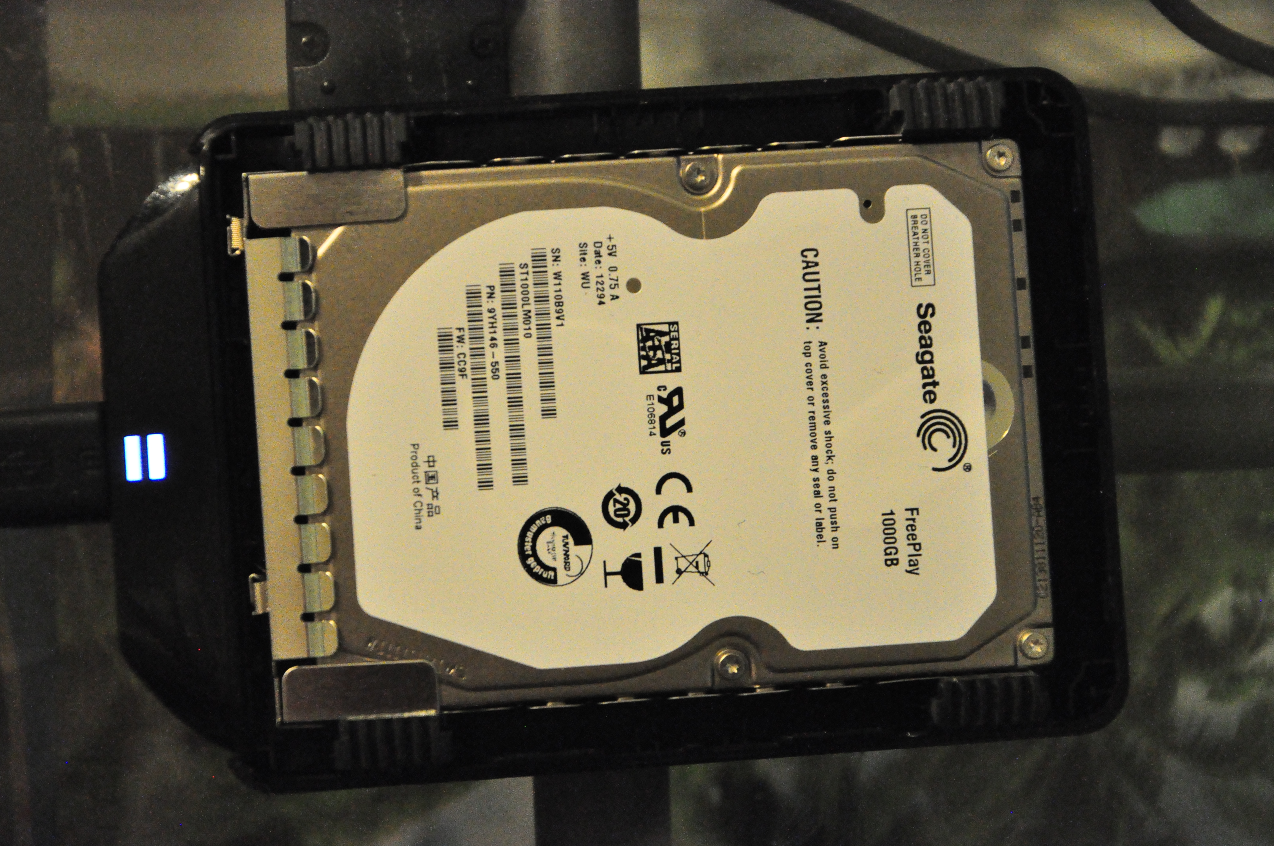

It sudenlly happens, I noticed that the bios and explorer in win 7 did not detect these external HDD, I only used for photos and picasa as a viewer/manager.
I notice that device and printers detect the "Y" adapter as seagate goflex, one led on the adapter turns ON and I can feel the HDD spining but no strange noises.
Tried to connect it using a sata and power cable to Main board and still not showing on explorer.
Please if someone have any input, let me know.

Try taking the drive out of the chassis and connecting via SATA.
See if it s connected by the PC BIOS.
Also,you can download MHDD from this site and test with that.

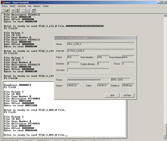

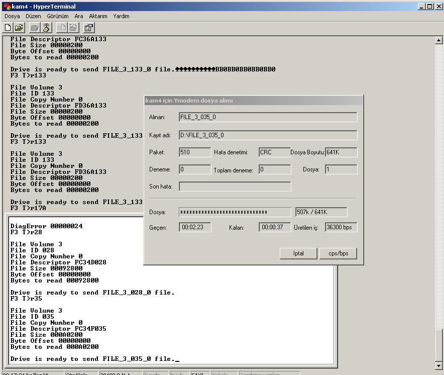

i got same issue but i solved.
"Sim error 1009"
i rewrite sys17a and sys133 file with Y-modem..
it resurrected.
 Post subject: Re: Seagate ST1000LM010 not detected
PostPosted: December 27th, 2015, 5:35
Posts: 210
Location: istanbul
r-read
w- write
i read some files from proper same model hard drive. with " r17A" "r133" "r28" "r35"
and after "w" it. w17A, .......
i use Hyperterminal's Y-modem..

excellent Mikail13.
But to a novice hyperterminal Y modem........ and the process of r and w please explain in detail.......
also, can the same treatment applied to other model of HDD having SIM error.
we have high expectation from U...Mikail13.
