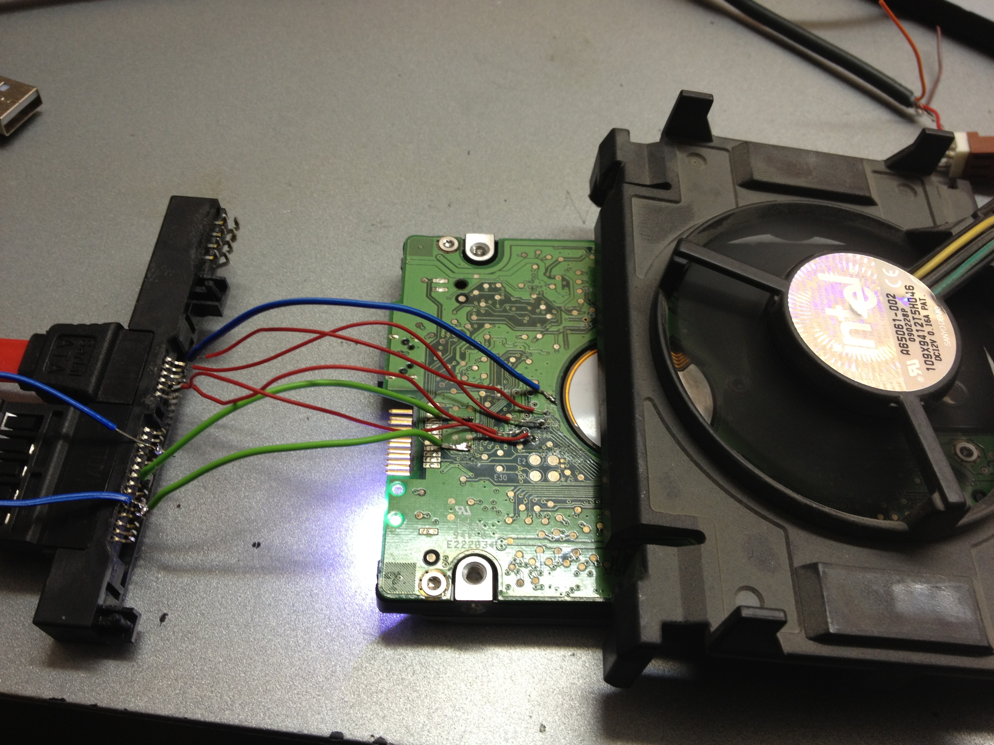

Hi, i have the same HDD, and i managed to rescue data from it. I removed 4 capacitors to disable controler, and connect it to external SATA. Then Win recognized HDD and i was able to extract data with tool "Get Data Back" it was slow but i have patience.
I put vent to cool it, because HDD was getting hot.

 Post subject: Re: WD5000BMVV connector
PostPosted: May 16th, 2013, 2:33
Posts: 7864
No encryption?
PostPosted: May 16th, 2013, 16:56
Posts: 511
Location: Austin, TX
don't all integrated USB port on WD laptop drives have encryption. I have yet to see one that did not. Not sure how he got data from the bypass
PostPosted: May 16th, 2013, 17:36
Posts: 16960
AIUI, Elements drives are not encrypted:
viewtopic.php?f=1&t=25627
Whats the full model number?
