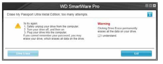

If you Never Locked/set your drive password, and you got similar message as this:
"Too Many Password Attempts - Locked Out" (usually with USB2.0 old types)
then you are also welcome. this will cost you 500$
Send your drive Locked, and have your Data Unlocked (copied to new drive)

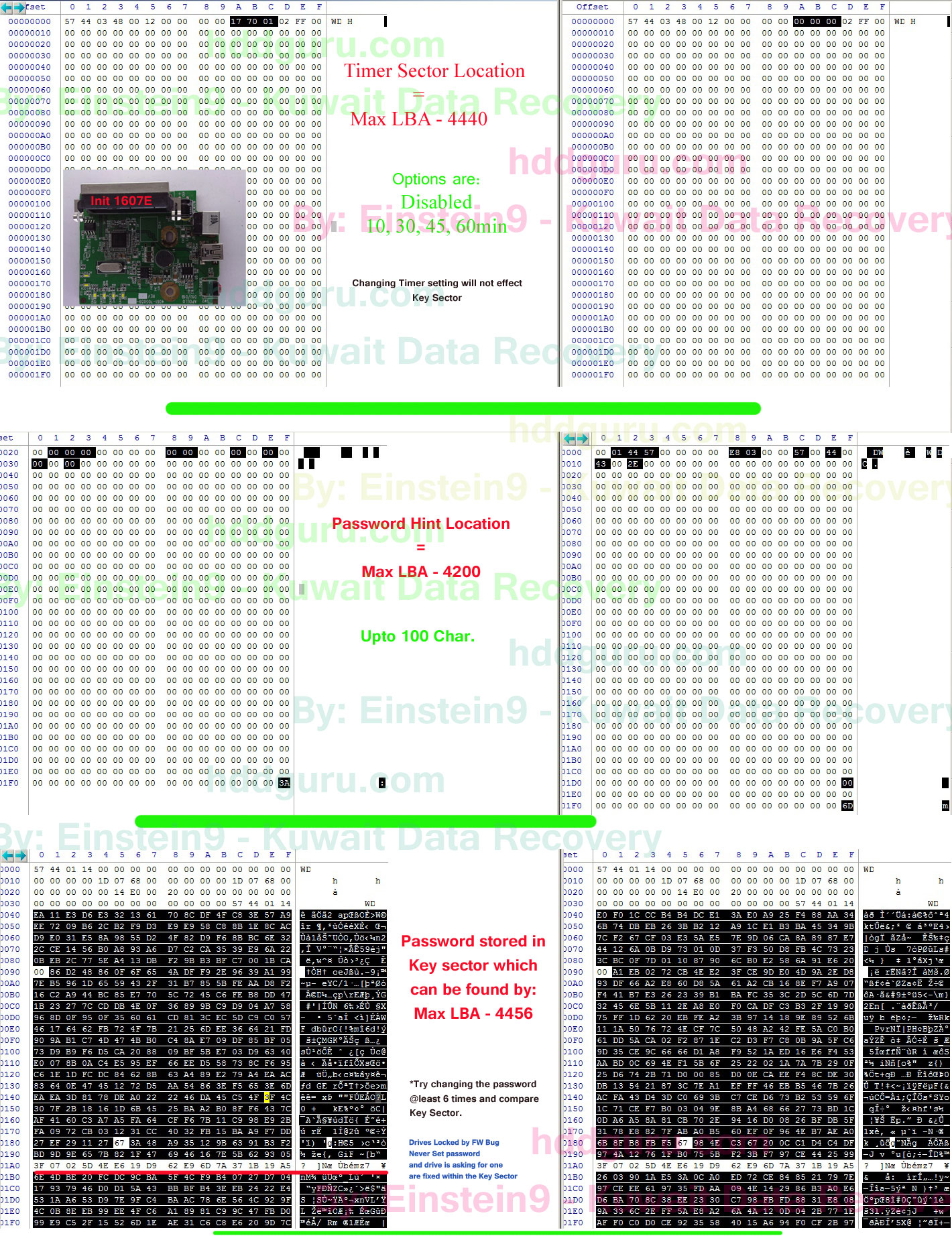

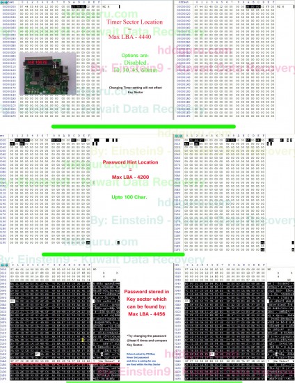

for the new 2017 i would like to post some of the research we made here
from here you can apply the same method to the rest.
good luck
*Zoom in for more details

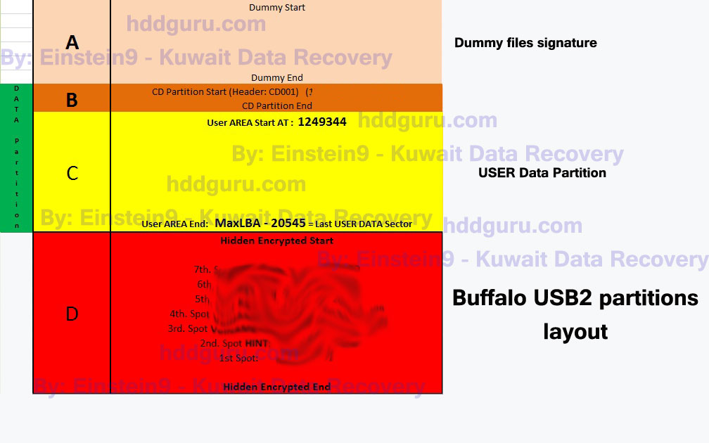

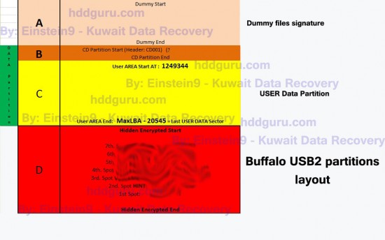

And here is the Buffalo partitions layout for USB2 drives
you may fill the missing parts by linking it to the prev. post.
