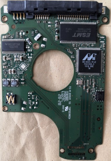

Can you upload a photo of your original PCB? There are a few voltage test points you could measure.

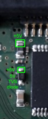

Here are the supply voltage test points.
