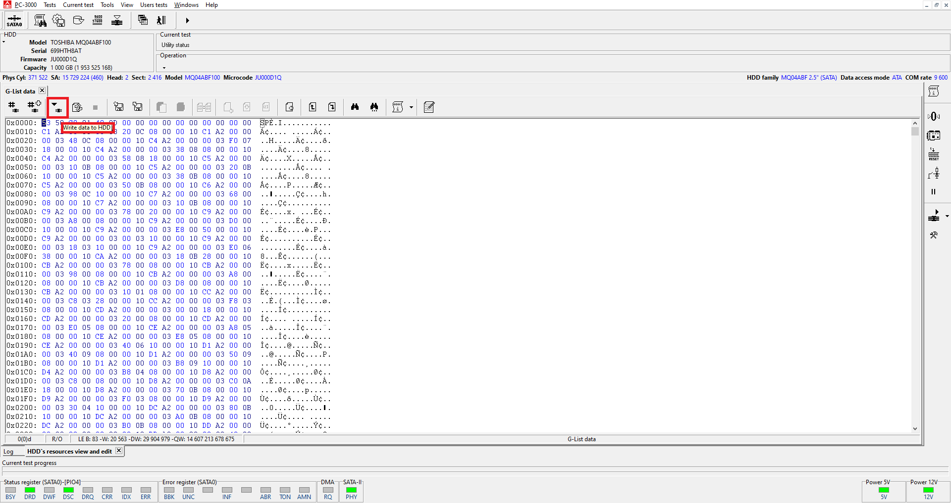

To clear the G-list, simply edit the first 16 bytes as follows:
Offset(h) 00   02   04   06   08   0A   0C   0E
00000000  5350 0000 0000 0000 0000 0000 0000 0000  SP..............
I edited as per your instructions. I press write button, says ok, but when read back still the same data as before.
Don't know if this particular drive has or not writing capability, or acelab button does nothing on this model.
Need to further test this on a good drive but do not have one right now. Maybe someone else can test this.
Where are you trying to write from ? I assume you don't have the menu options to work with the defects lists? If the list hasn't overflowed there shouldn't be a need to clear it.

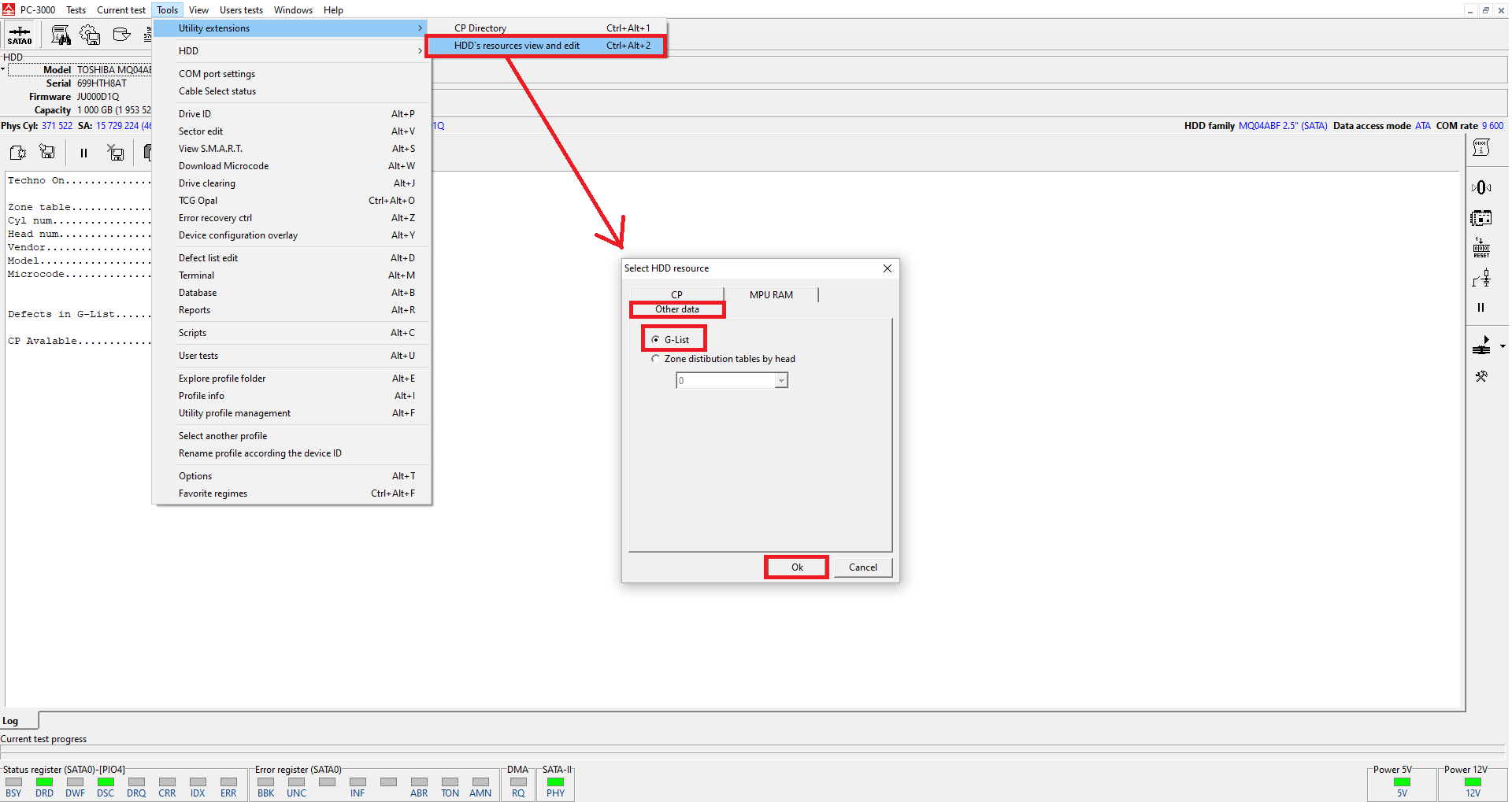

I tried on the same drive to write a modification in DD module which of course is on the platters and it works. So drive has writing capability.
This means Acelab write button for G-list is not working on MQ04. Maybe just a leftover from previous MQ01 in the utility.

MasterT You can't edit the g-list from there (or at least I couldn't find a way to) I also checked across multiple families in case it was just this drive. Take a look at the service tracks. Are you doing DR or just R&D on this drive ?
