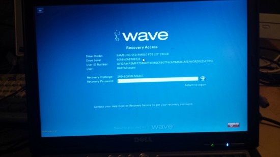

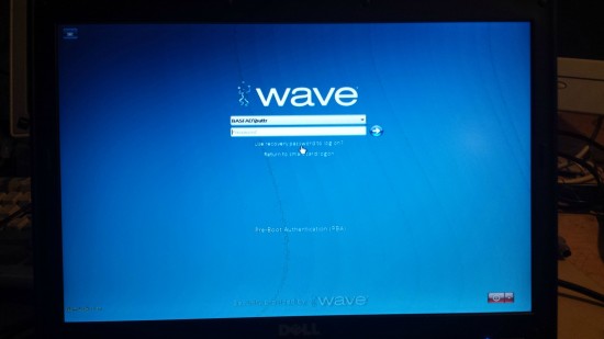

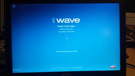

hi everyone ... i have SSD marque Samsung 256GB model: MZ-5PA2560/0D7
encrypted by Wave Smart Card ... if can be someone help me to unlock it
this is Pic of what i get when i put on desktop
SSD from DELL Laptop (idk which model)
PSID not printed on SSD

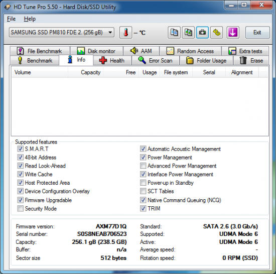

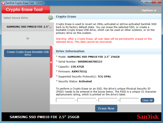

this my ssd info

Crypto Erase tool says "it is for Sandisk...". Should work on other SSDs as well?
Hard Disk Drive, SSD, USB Drive and RAID Data Recovery Specialist in Massachusetts
 Post subject: Re: Samsung SSD Smart Card Logon
PostPosted: October 24th, 2014, 11:56
Joined: October 24th, 2014, 4:56
I've read some docs and this apps(Sandisk, Samsung, Dell Protection.., Wave ESC) should work on all OPAL based security drives.
Issue is that we don't have PSID required to perform this Crypto Erase function.

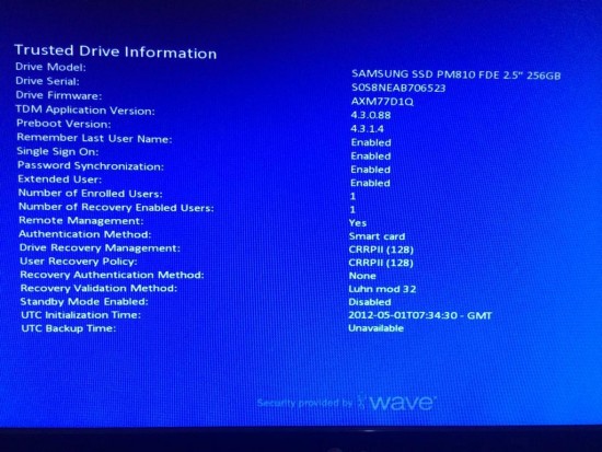

Wave contact me for some info
i got this picture from SSD after Boot using "Ctrl+D"
about PSID i use some but with no luck
waiting if it help in some way

Exactly the same situation for a drive I bought on a site similar to ebay. First time I test this drive it wasn't recognized by BIOS on any PC / Laptop, not even with MHDD or any other tool like Victoria. After fighting I found a way to bring it back to life, I'm not quite sure under what situations but it seems that this drive (Samsung SSD PM810) doesn't like to be hot unplugged, this can cause to the drive not being recognized anymore unless I use the freezer "trick", YES putting the drive inside the freezer for 10 minutes seems to bring this drive back to life.
Unfortunately the drive is locked with this same ("pre-boot"?) Wave Embassy software and I didn't find a way (yet) to format it. Gpart, Parted Magic, DBAN (even if it's not recommended) and almost any tool seems to not work (I/O Error).
Things I tried and results:
-Samsung Magician not recognized the drive as a Samsung SSD...
-Samsung DOS flash updater recognize the drive but update failed with a wrong directory or wrong file names, I'm working on alternatives to flash the firmware as I found in a korean/japanese forum a way to un-encrypt the Samsung files in order to force flash the drive with another firmware.
-DBAN and all the tools inside Hiren's to erase hard drives ends with an I/O error.
-MHDD and Victoria can change LBA and allow me to set the HPA and almost anything those tools can do expect to erase the drive.
-DISKPART tool shows the drive, I also found that under the attributes of the disk it was set to read-only but nothings changes after I turned it off. But after clean all = I/O error.
-PSID revert tool asked me for the password in order to secure erase the disk and I insert the only visible 32 char in the disk label but that doesn't work. After 2 tries this tool doesn't work anymore.
-Using a DELL laptop with pre-boot capabilities seems to do nothing as it don't let me set a disk password.
The drive is not dead, it boots and also ask for the smart card authentication, Wave tools to recover the drive also didn't work as it will ask you to contact your administrator.
I will keep putting my efforts trying to force flash the firmware to check if that works. The current firmware of my drive is AXM77D1Q the latest firmware from Samsung should be AXM09B1Q for this drive as the PM810 it's quite similiar to 470 Series (in many ways).
