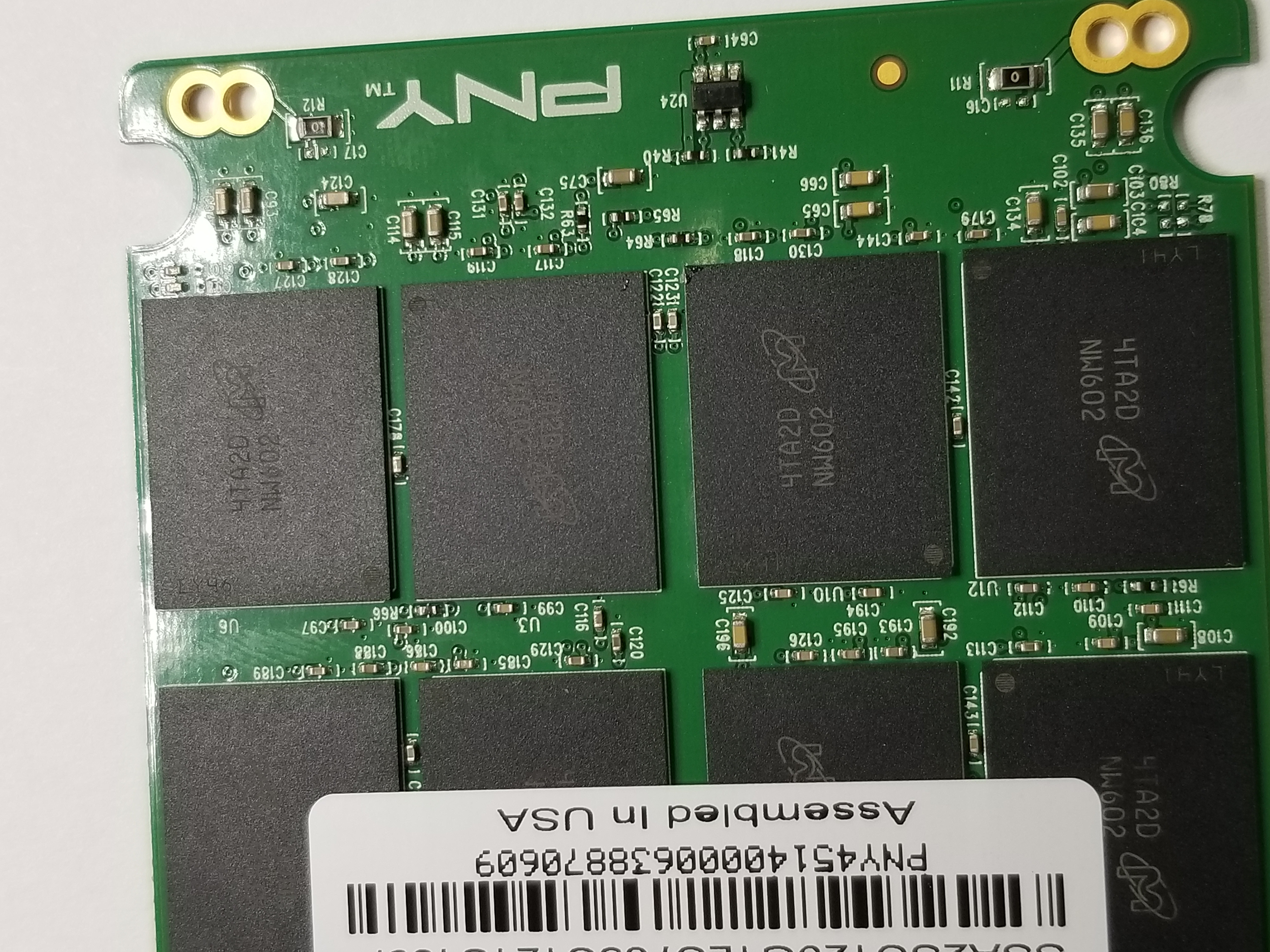

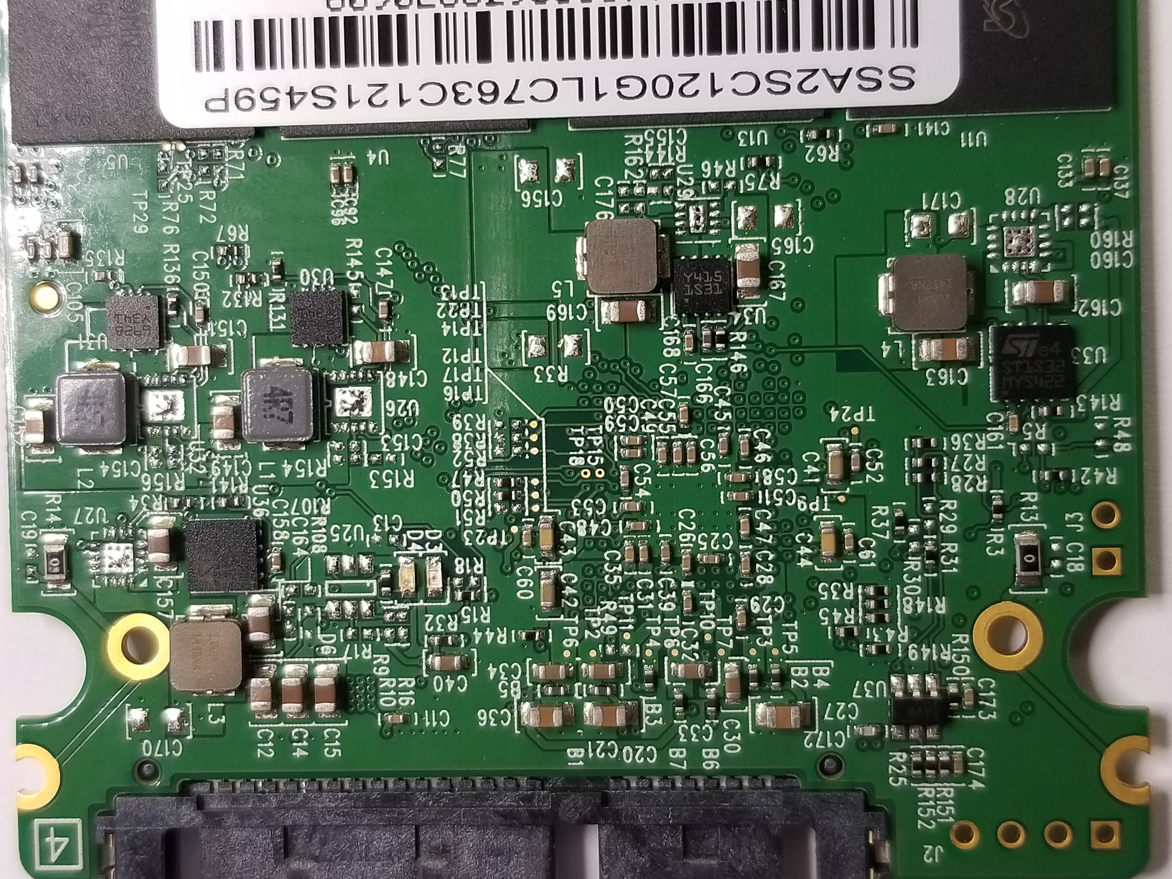

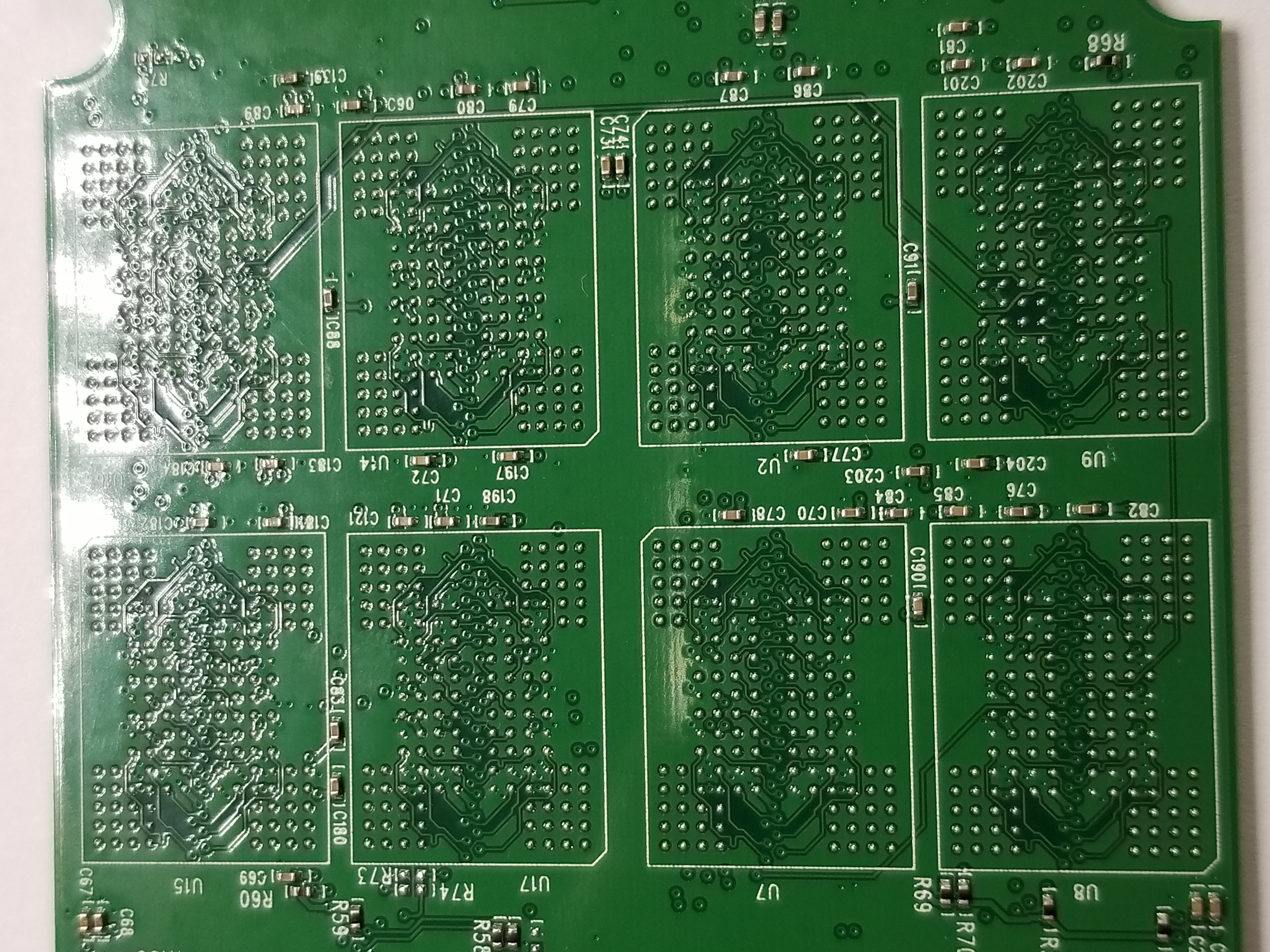

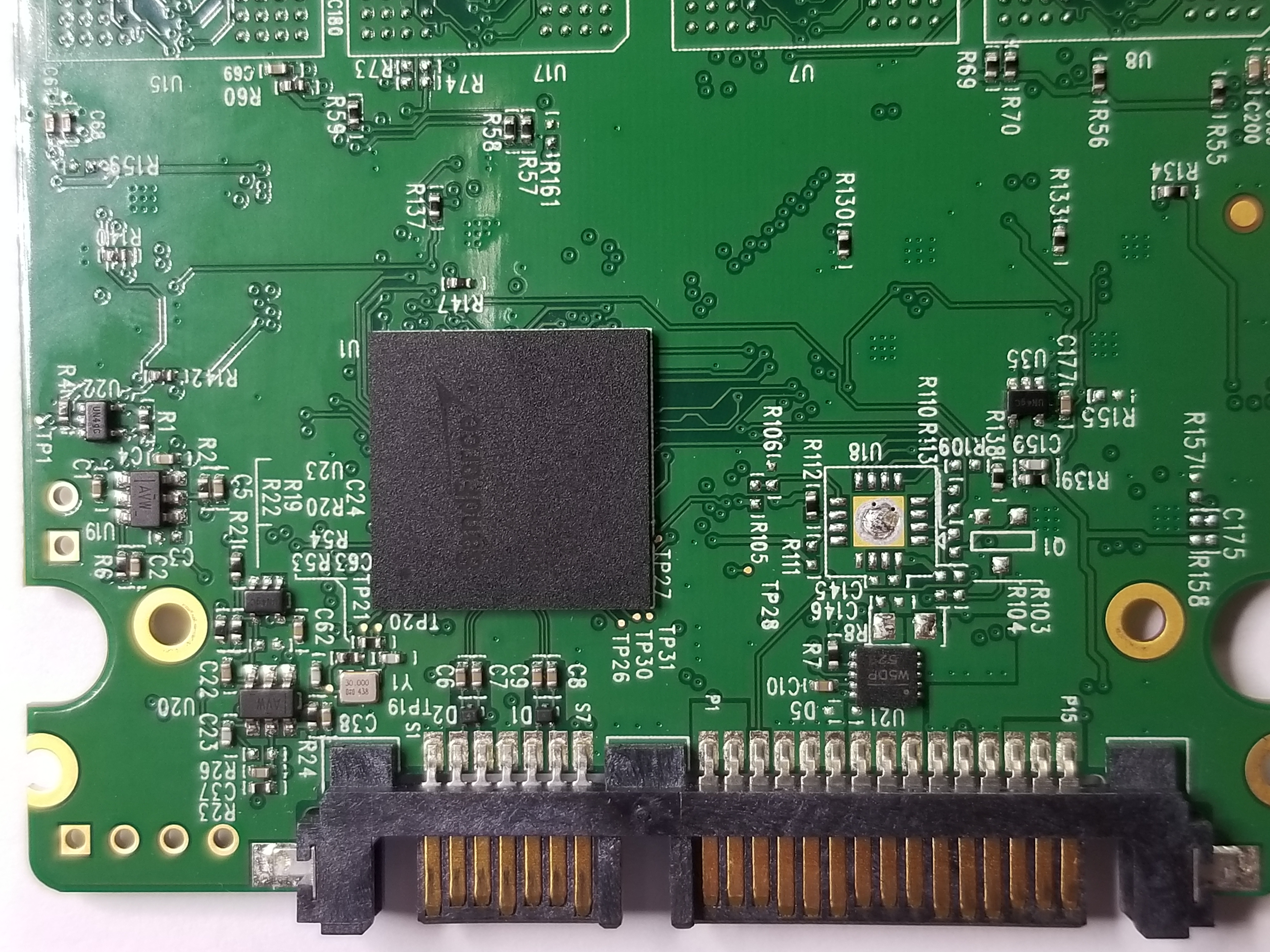

This SSD was subject to a power outage.
It has a SandForce controller so the amount we can do with it is limited. Power light on PC3000 show both 5v and 12v power going to the board, but the status register lights are out. Visual inspection of the board shows no signs of damaged or burnt out components. So the outage may have taken out the controller but wanted to run some basic tests on the board to see if I can isolate a failed component. By the way, the controller does get warm so is received power. Any help would be appreciated.
Images attached.

I would confirm that +5V is present at the input and output of U21 (MP5001DQ).
Also measure the voltages at inductors L1 - L5.
U21 - 5v
L1 - 1.v
L5 - 1.8v
Seem pretty normal?

I meant L1 to L5, ie L1, L2, L3, L4 and L5.
 Post subject: Re: PNY XLR8 SSD Issues
PostPosted: July 7th, 2018, 16:14
Posts: 1710
Location: Phoenix, AZ USA
Sorry LOL, dumb as a rock here...
L1 - 1v
L2 - 2.88v
L3 - 1v
L4 - 2.85
L5 - 1.8v
PostPosted: July 7th, 2018, 16:42
Posts: 15531
Those voltages look OK (they are similar to those in another SF-2281 thread).

There is no terminal port on this drive. I did experiment and found the short points to get the drive into safe mode. However as its SandForce it doesn't really help.
Many thanks for the help as always.
PostPosted: July 7th, 2018, 18:43
Posts: 15531
The following thread discusses an Adata S510 which is based on a SandForce SF-2281VB1-SDC controller. The voltages are the same as yours.
https://www.eevblog.com/forum/repair/ssd-recovery-(adata-s510-128gb)/
At least something is alive - by shorting J3 (as mentioned in https://geektimes.ru/post/263876/) I can activate the "developer mode" which appears in Device manager as "mass storage device". Also hooked my USB-UART dongle to J4 TX pin and found out that the firmware doesn't load properly.
PostPosted: July 7th, 2018, 19:12
Posts: 1710
Now I have safe mode activated (called developer mode in that post) I can see that the FW is not loading in PC3K. Would be nice if Ace Labs can get this one sorted one day.
