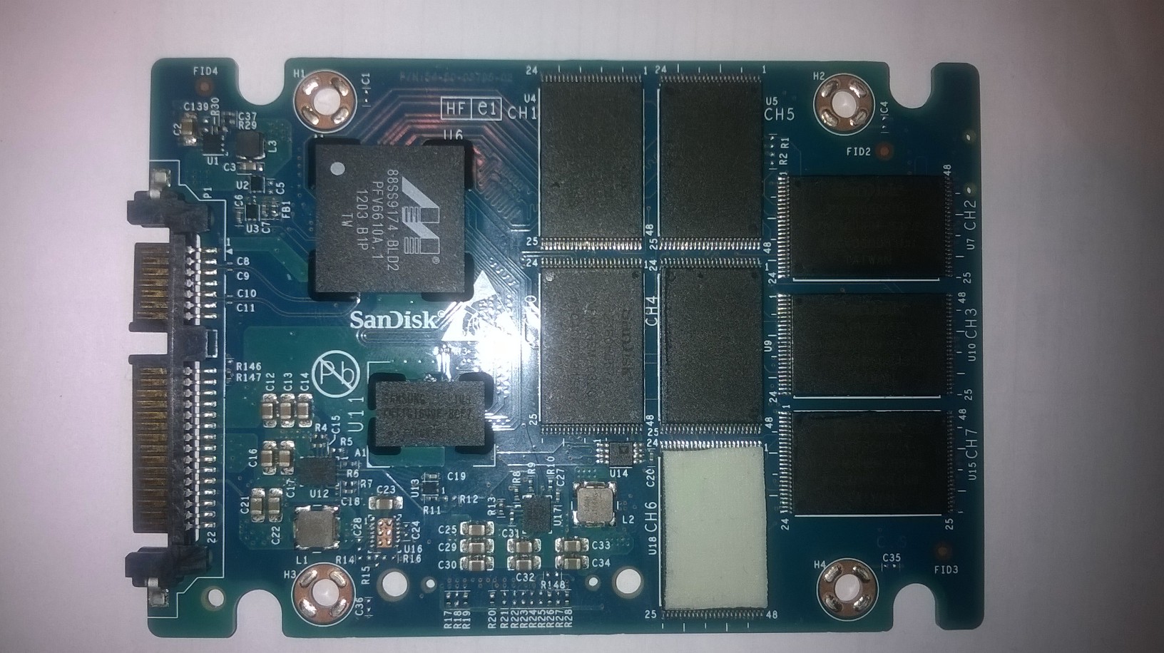

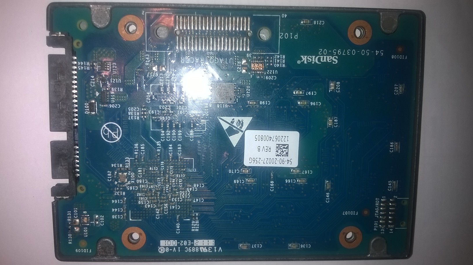

Hello, i've this SSD which isn't detected in the BIOS.
SanDisk X100
SD5SB2-256G-100BE
FW: CS.03.00
Probably it's a PCB issue, can you help me to find important points for voltage measure?
I checked FB1 and D100, they are good.

U11 is an SDRAM. Its datasheet sheet should tell you its supply voltage, possibly 1.8V, 2,5V or 3.3V.
Coils L1, L2 and L3 suggest that there are 3 switchmode regulators. The Marvell controller (U6) needs Vcore and Vio supplies. I expect that the NAND flash array would be powered from 3.3V.
I would measure the voltages across C33 and C34, C21 and C22, and C3. These would be the output voltages of each of the regulators. The other capacitors would be filtering the +5V rail. It would help to know the markings on U12, U17 and U1. These would be the PWM controllers.
D100 looks like it might be a TVS diode. U119, U121 and U123 look interesting but I can't guess as to what they might be. U118 and U120 look like they might be power chips (PSU monitor ?), but I can't make out their markings.

U11: SAMSUNG 149
K4T1G164QF-BCF7
U1: 0AL
1BJ
PJ7V
U12: MG77
00A3P
126AK
U17: MG77
00A3P
126AK

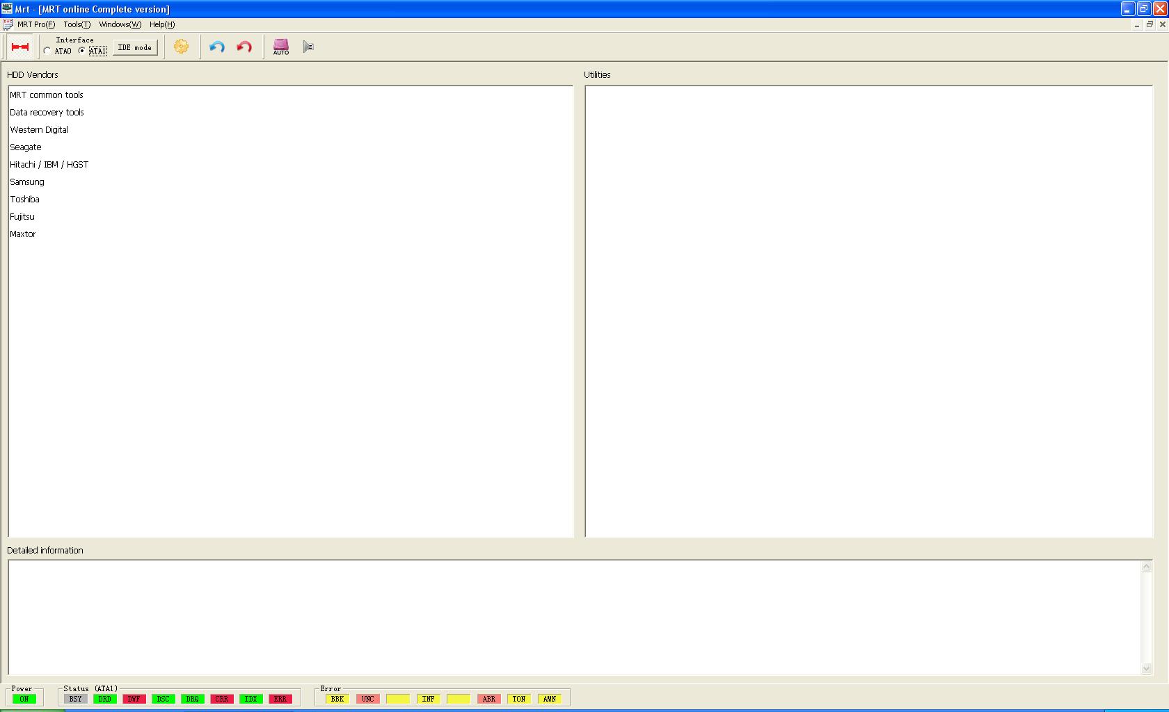

 Post subject: Re: SanDisk X100 256G no BIOS detection
PostPosted: February 13th, 2015, 7:15
Posts: 1626
Location: Italy
I checked registers also with MRT, i get the same result as MHDD (no changing from power off to power on).
All registers lights are on, exept BSY
Does it mean that there is a firmware corruption?
My firmware database:
https://mega.nz/folder/O01DkBRI#MxP2J6ZNqXDcrX40I8MoQQ
PostPosted: February 13th, 2015, 7:55
Posts: 7843
I wouldn't say so, more like an electronic issue.
Normally with firmware corruption on these, it comes DRD / DSC

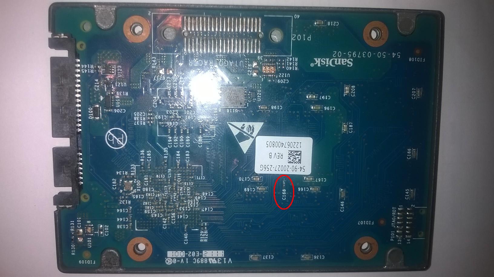

PostPosted: February 13th, 2015, 10:30
Posts: 1626
Location: Italy
I found short on C168.
PostPosted: February 13th, 2015, 16:51
Posts: 15538
"Van Gogh" appears to be the controller's in-house name.
    88SS9174-BLD2 - Van Gogh
    88SS9175-BJM2 - Van Gogh Lite
    88SS9187-BLD2 - Monet
    88SS8014-BHP2 - Da-Vinci
The same controller is used in Crucial's m4 SSDs.
http://www.anandtech.com/show/4253/the- ... ssd-review
http://images.anandtech.com/reviews/sto ... C_2634.jpg
http://images.anandtech.com/reviews/sto ... C_2635.jpg
I suspect that the JTAG pinout at the top edge of Crucial's PCB might match the 14-pin JTAG/RDT connections at the bottom right corner of the underside of your PCB.
Crucial's PCB has a 4-pin and a 5-pin header. I suspect that one may be a serial port. Perhaps your board's JTAGOTRACER connector provides similar functions.
Crucial's board has an 8-pin serial flash memory. I expect that your board would have one as well (U14 or U118?).
The shorted capacitor, C168, looks promising. It appears to be located at the junction of NANDs CH0, CH1, CH4 and CH5. Perhaps it is common to all the NANDs. Have you been able to determine if it connects to a NAND pin?
The other capacitors in that area appear to bypass the 3.3V supply. Each NAND appears to have a pair of bypass caps, ie C145/146, C186/187, C207/208, C136/166, C137/169, C170/198, C167/196, C197/218.
PostPosted: February 13th, 2015, 17:08
Posts: 1626
Location: Italy
Do you think i might connect my PCB to my computer serial port and get a prompt in hyperterminal?
It's possible to send commands via terminal and fix some issues as Seagate HDDs ?
Serial flash memory chip is ATMEL 25DF021 and is in position U118.
I'm not able to tell if C168 connects to some NAND chip because tracks go under NANDs chip.
C168 is located under NANDs in opposite pcb side.

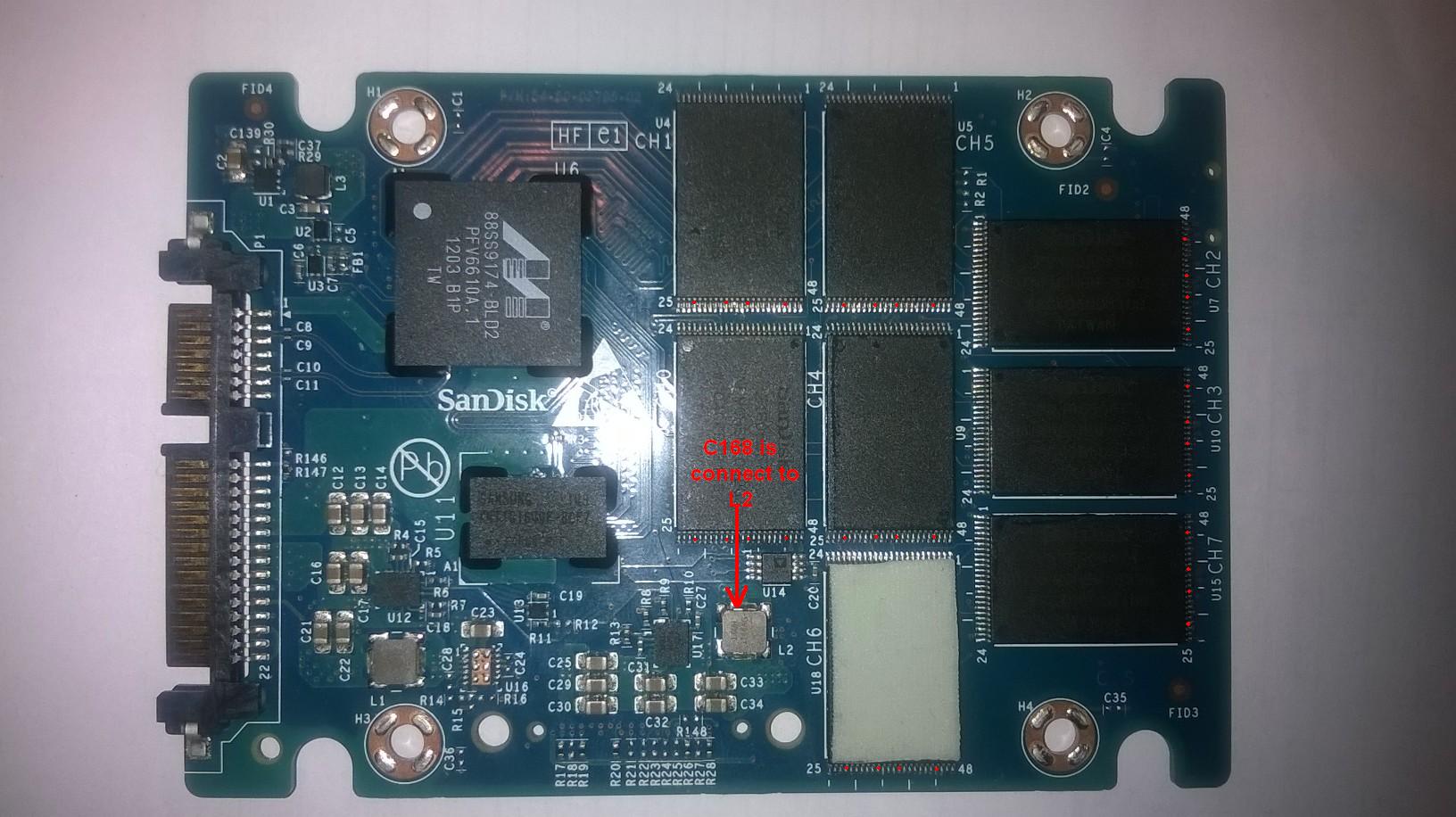

PostPosted: February 13th, 2015, 21:13
Posts: 1626
Location: Italy
I have found with my multimeter that C168 is connected (or shorted) to L2 pins, then i turned upside down PCB and found that L2 is connected (or shorted) to pins 28 34 38 45 of every NAND.
As for C168, I would measure the resistance between ground and each of the pins of a single NAND. Then consult the NAND pinout and determine which, if any, of the grounded pins is not actually a power ground.
i'm going to check this...
