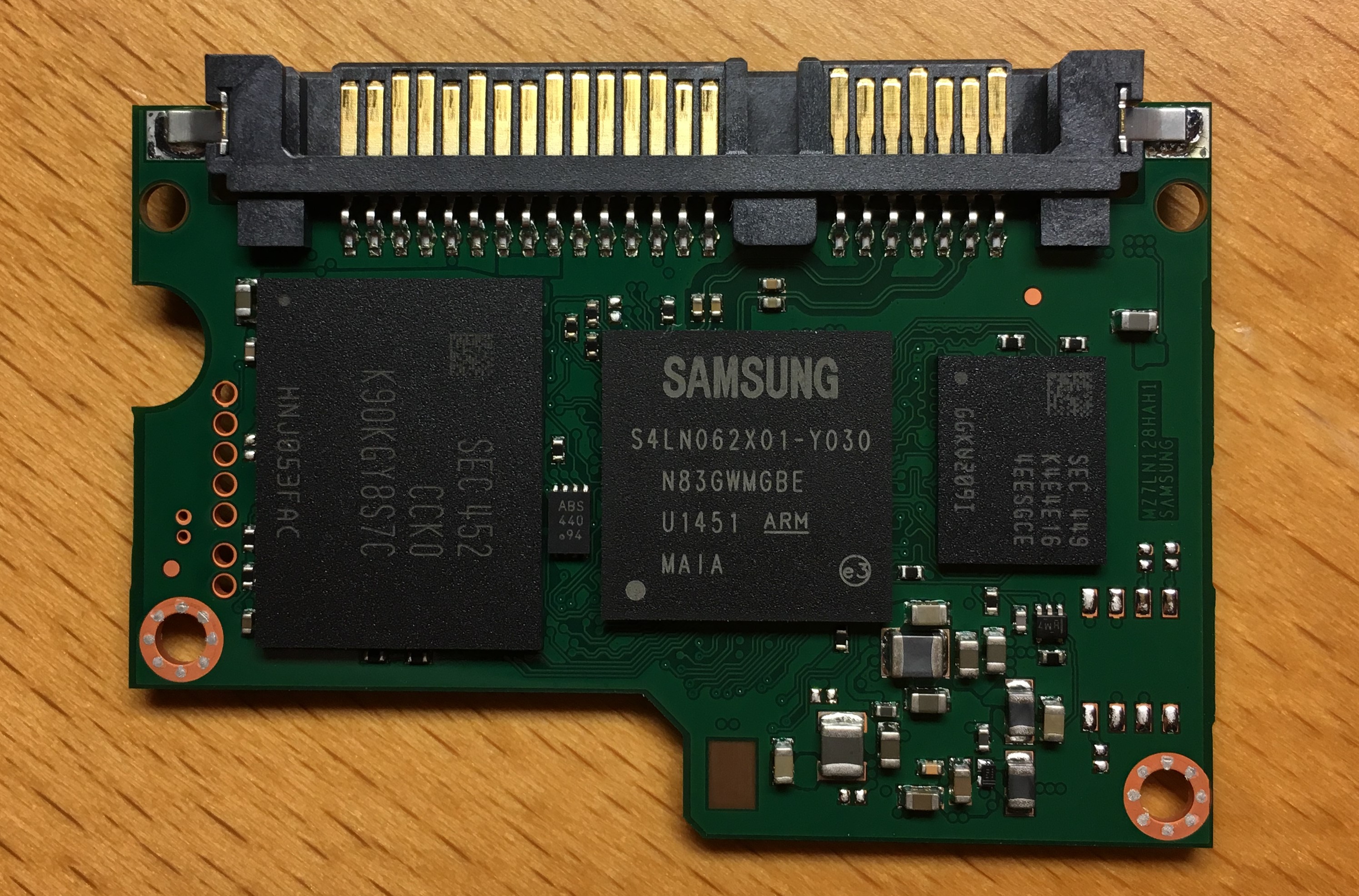

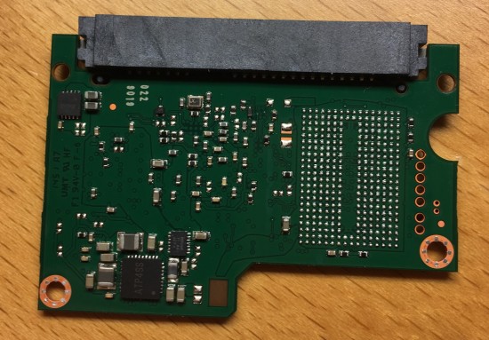

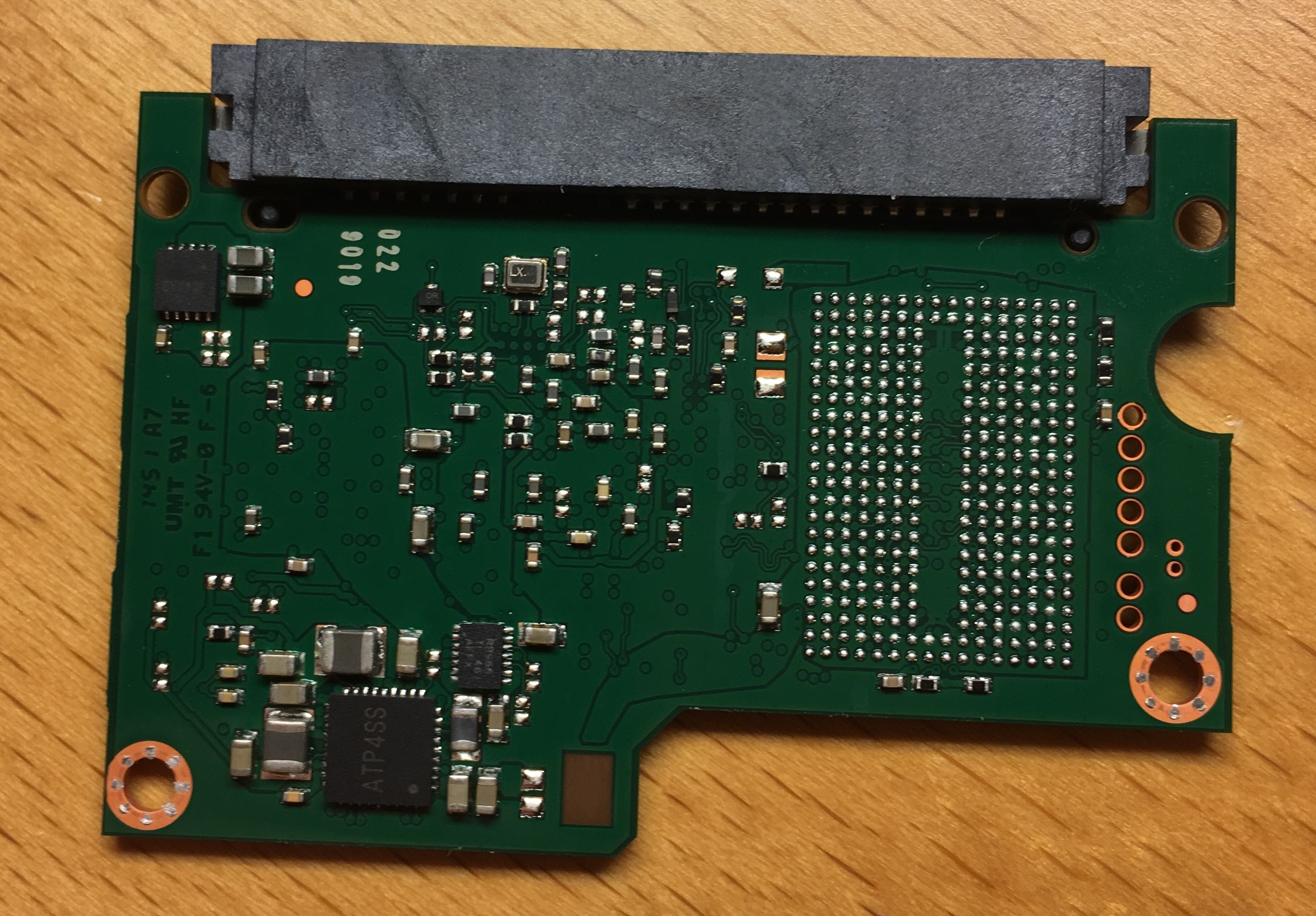

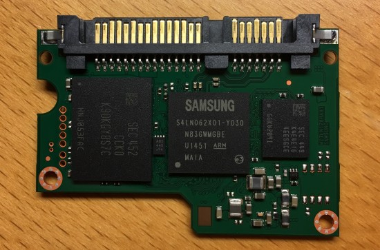

Pictures of both sides.
I read through the EVO 840 PDF and saw that about the SAFE mode, but I didn't found how I update the firmware by the SAFE mode?

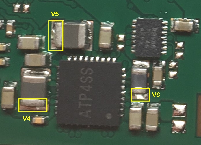

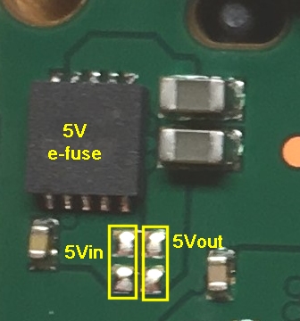

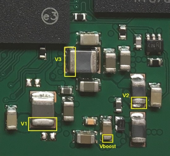

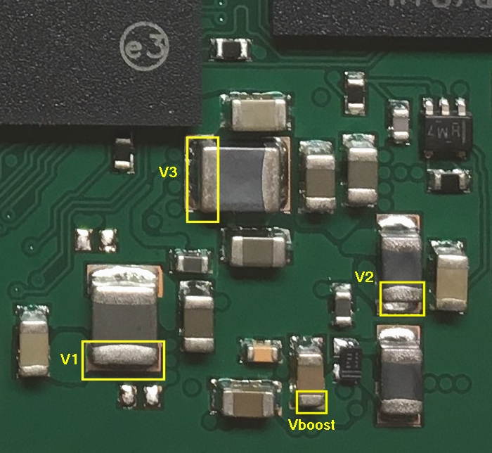

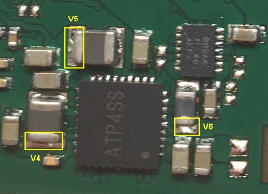

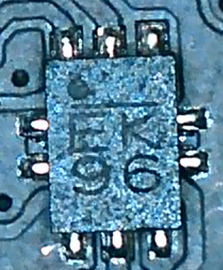

These appear to be the voltage test points:

Voltages seems ok?
VBoost = 12V
V1 = 1,1V
V2 = 1,8V
V3 = 1,2V
V4 = 3V
V5 = 1,8V
V6 = 1,1V
5V Efuse = Ok

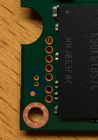

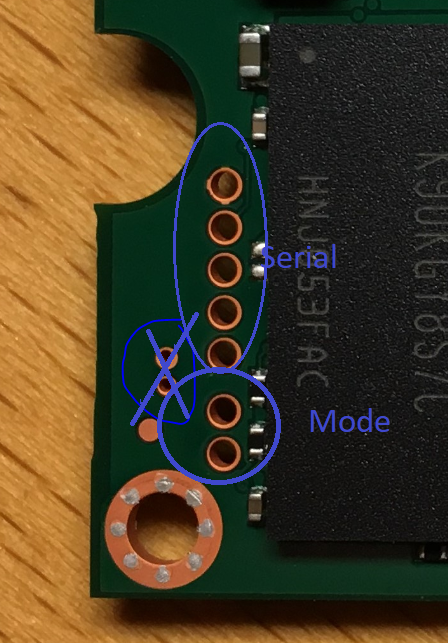

In SAFE mode (when you shorten the 2 pins next to the 5 pins), the EVO840 provides a 500 MB RAM-disk on the SATA interface, and you can do the normal firmware update (UPLOAD MICROCODE) over SATA. If Samsung Magician does not recognize the SAFE mode SSD, you have to decrypt the firmware and send it with hdparm.
But the biggest question is: Does it come available on SATA when you shorten the SAFE mode pins? (Or is the controller completely dead?)

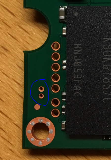

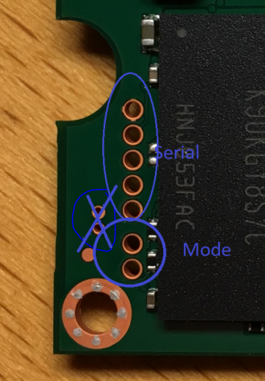

Could this two be for the SAFE mode? One is GND and the other is 1,8V.

 Post subject: Re: Samsung SSD 850 EVO
PostPosted: March 7th, 2019, 18:31
Posts: 197
Location: Vienna, Austria
No, I think it is the 2 pins right below the 5 pins on this photo.

The voltages look OK to me.

I shorted the two pins (next to the five) and started the PC but no difference, are you shore about the pins?
According to the 840EVO PDF:
The 2 pins right next to the JTAG (0V, 1.8V) pins are activating the “SAFE Mode” when shorted. The other 2 pins (marked 1,815 V and 1,819V) are a UART port, which provides debugging functionality in SAFE Mode.
The two smaller pins (marked) I have 0 and 1,8V and the two pin next to the five, its 1,8 and 1,8V = UART port?

Probably like this... Serial or JTAG plus safe mode, firmware mode or whatever you want to call it:

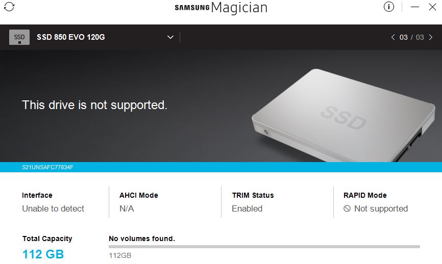

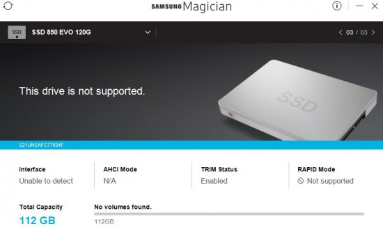

Notis today that if I wait for a time the disk will show up in windows, but with no info. Is the firmware still the suspected candidate? Anyone ho has the firmware in a hdparm format?
In hdparm:
/dev/hdc:
Model=, FwRev=, SerialNo=
Config={ HardSect SoftSect NotMFM Fixed Removeable }
RawCHS=0/0/0, TrkSize=0, SectSize=0, ECCbytes=0
BuffType=unknown, BuffSize=0kB, MaxMultSect=0
(maybe): CurCHS=0/0/0, CurSects=0, LBA=no
IORDY=no
PIO modes: pio0
AdvancedPM=no
Samsung Magician:

Please provide the relevant "dmesg" output. How long does it take to start the SSD? It's interesting that it actually shows the capacity correctly (it is 120 GB, isn't it?)
