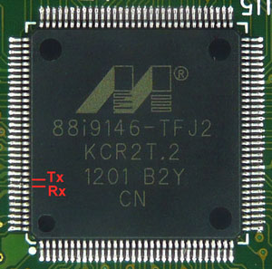

I've spent some time to figure how to connect to serial interface. I'm using PC's com port. I've got a rs232 to ttl convertor (max3232) in order to translate the 3.3v serial signals to something useful for PC's com port; in the end I couldn't find the pins to connect. the jumper's header doesn't emit any rx or tx signals when I switched to Terminal routine (xmodem)..by manipulating the code from jtag interface. I found some pins from the jumpers header, going straight into MCU (normally since they are used as IN to set some bits in "Config Port"). I found also the real TX,RX circuit (E7,E8 on this pcb), but this links 2 pins from MCU with 2 pins from SATA controller :?: . The Baud rate it's 38400 8N1. but how it's used since it doesn't have any useful pins to connect?

TX/RX also used in SATA interface. Nothing to do with UART RS232

maybe the serial interface it's somehow passed through sata chip...to the serial ata cable.
in this case, the xmodem code works with those 2 pins I indicated which are linked to the sata controller.

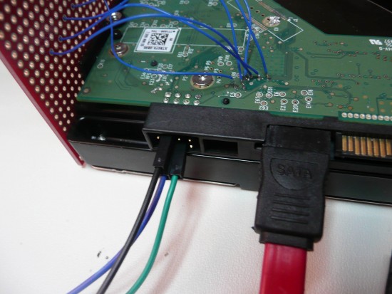

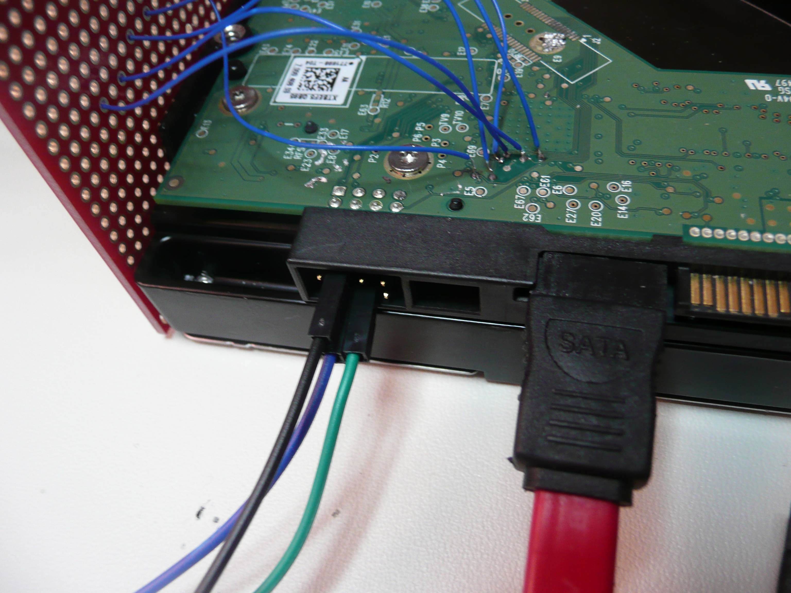

This is how I hooked up serial for my hard drive. The board contains a Marvell 88i9146 processor and con1 is the 38 pin version. Not sure what processor you have. The serial connection is brought out to the jumper header. I have JTAG connected and forced the drive into terminal mode by resetting PC. After that I had a prompt on the below configured serial port. The baud was set at 115200 8N1.
PCB Side of HD
| 2 | 4 | 6 | 8 |
| 1 | 3 | 5 | 7 |
Top Side of HD
Pin 4: Black Jumper = GND
Pin 3: Blue Jumper = RxD
Pin 5: Green Jumper = TxD.
PS: My notes aren't so good. Rx and Tx maybe reversed. So try both ways.
