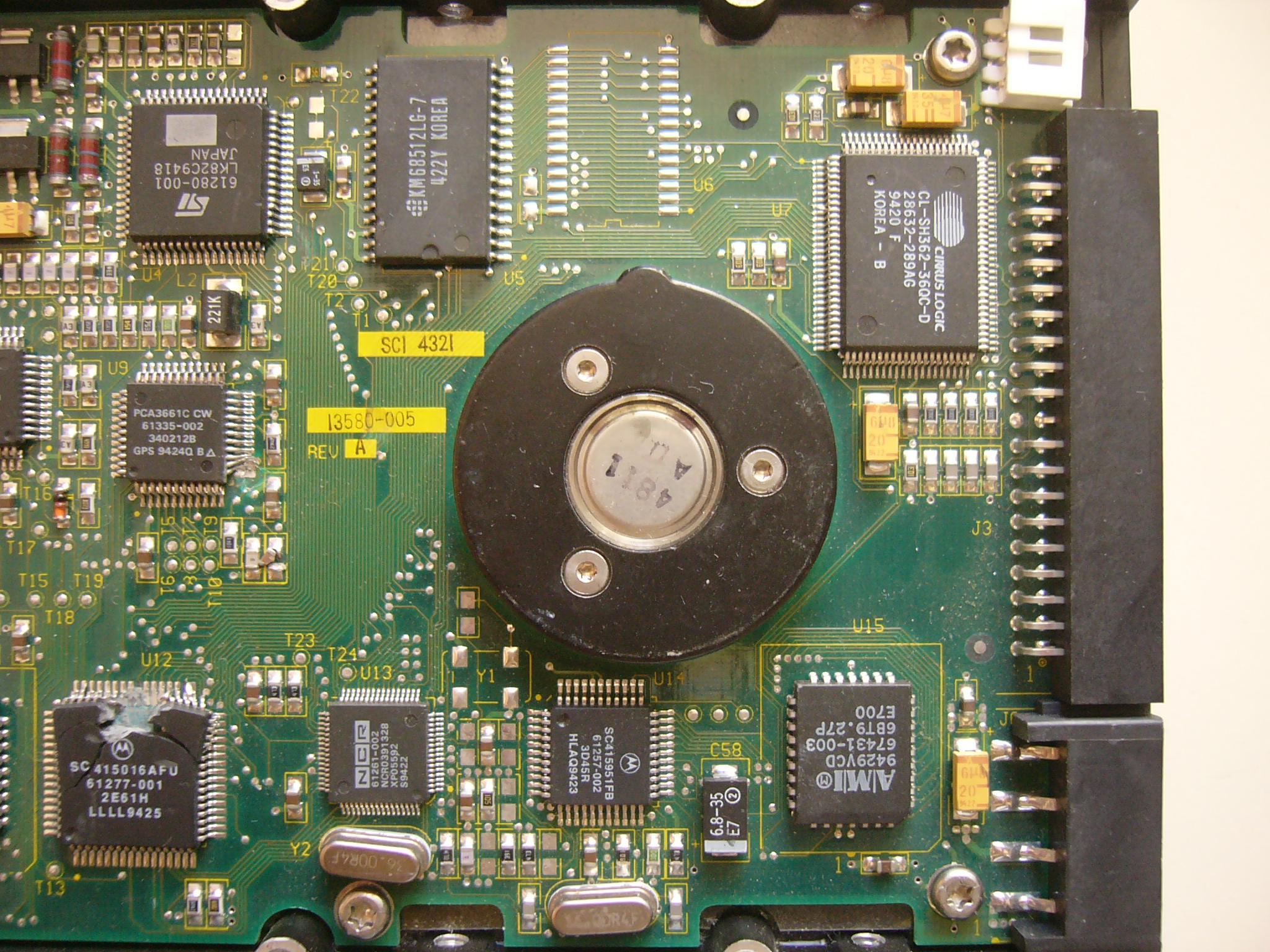

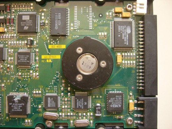

Hi gurus,
Well, after this foreword I begin my story, maybe someone can help me (free). I have a Conner CFS420A, that behaves the same way. Spins up and down a few times then stops. It was tested with a pcb from an identical model (own pcb was physically damaged), that has no such problems. So it is definitely a motor problem in my case. I can see 3 screws on the motor cover, has anyone been successful in repairing a motor failing to reach full speed? If I remove those screws, do I get access to the spindle shaft and adding some lubricants will help? Just want to repair the drive, if possible.
By the way I have an old ST157A, same problem, not reaching full speed (led blinking 16x) is there any remedy? Thank you.

I would start by examining how a working drive behaves under fault conditions.
If you isolate the HDA from the donor PCB on the donor HDD, does the donor spin up and remain spinning?

Spildit wrote:
What is the Conner MCU ? Motorola, Uxx, Ferro or ConnerTech ?
It appears to be Motorola. U12 is a Motorola special order (SC415016AFU). According to the following discussion, these were MC68HC MCUs -- 68HC11A or 68HC11E, or possibly 68HC16 or 68HC11F.

Probably worth moving patient U15 onto your donor board and trying again. Can you upload pics of top labels from both HDDs?

Here is a photo of the complete CFS420A PCB:
http://kirpantin.vv.si/img/hdd/img_4867.jpg
http://kirpantin.vv.si/hdd.htm
http://www.computerhope.com/hdd/hdd0020.htm (specs and jumpers)
U15 looks like a ROM for U14 (SC415951FB) while U11 appears to be the ROM for U12.

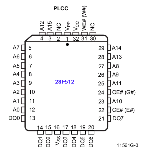

U15 is probably a mask ROM:
http://web.archive.org/web/199610280301 ... m/rom.html
I expect that the pinout would be similar to these flash EEPROMs (except for WE* and Vpp):
http://www.micropik.com/PDF/28f512.pdf
http://www.romservice.ru/datashee/M28F256.PDF
http://www.futurlec.com/Datasheet/Memory/28F256.pdf
Note that the CE and OE pins may be active high:
The control pin function and active level, as well as the memory contents, are user-defined.
