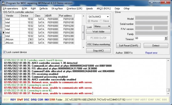

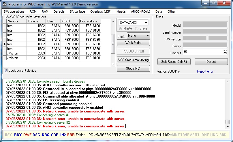

I want to advice that WDMarvel (which is an ukraine sw) has some issue with servers.
If you have activated a lifetime license, you will be unable to use it because the tool wants to connected theyr server with your PC.
If servers are offline or damaged (maybe due to the war), you will see reported server error and the tool goes in DEMO mode.
Other user are reporting same issue on Marvel forum:
https://wdmarvel.com/forum/ru/viewtopic ... 134#p26134
The strange thing is that older version as 4.02 and 4.03 are working fine because PC can connect to Marvel server... probably this versions run on different server from recent versions?

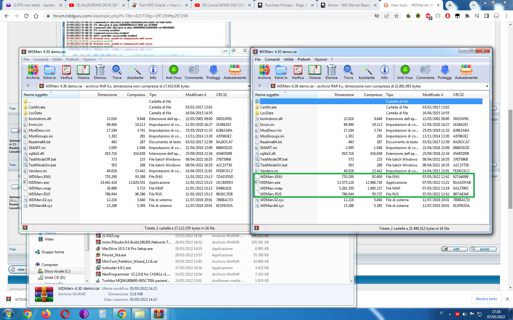

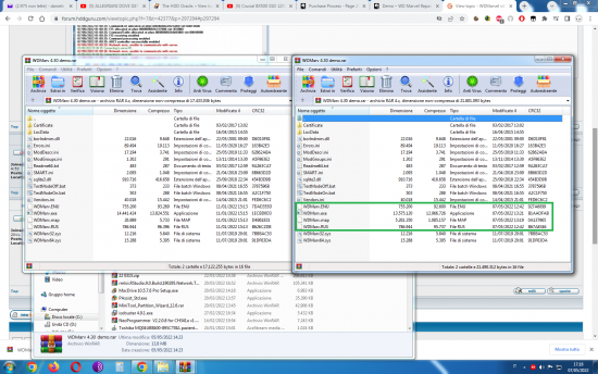

You can see that the marked files in the green squares are different comparing the new 4.31 version with previous 4.30

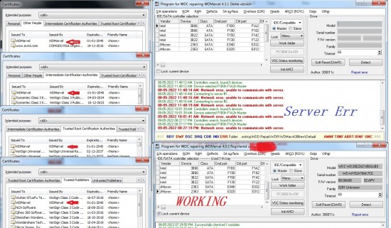

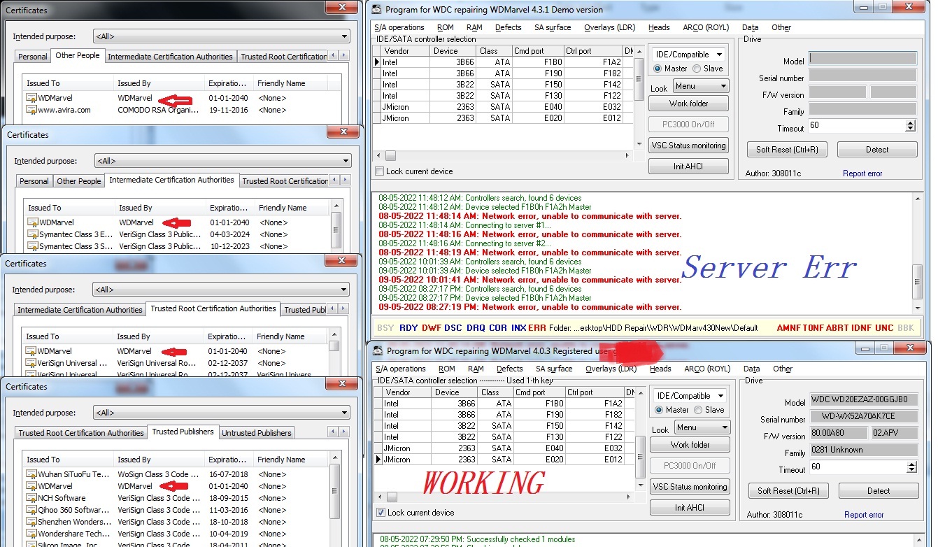

Certificate added from new version Still getting err
How to solve issue
