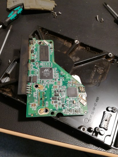

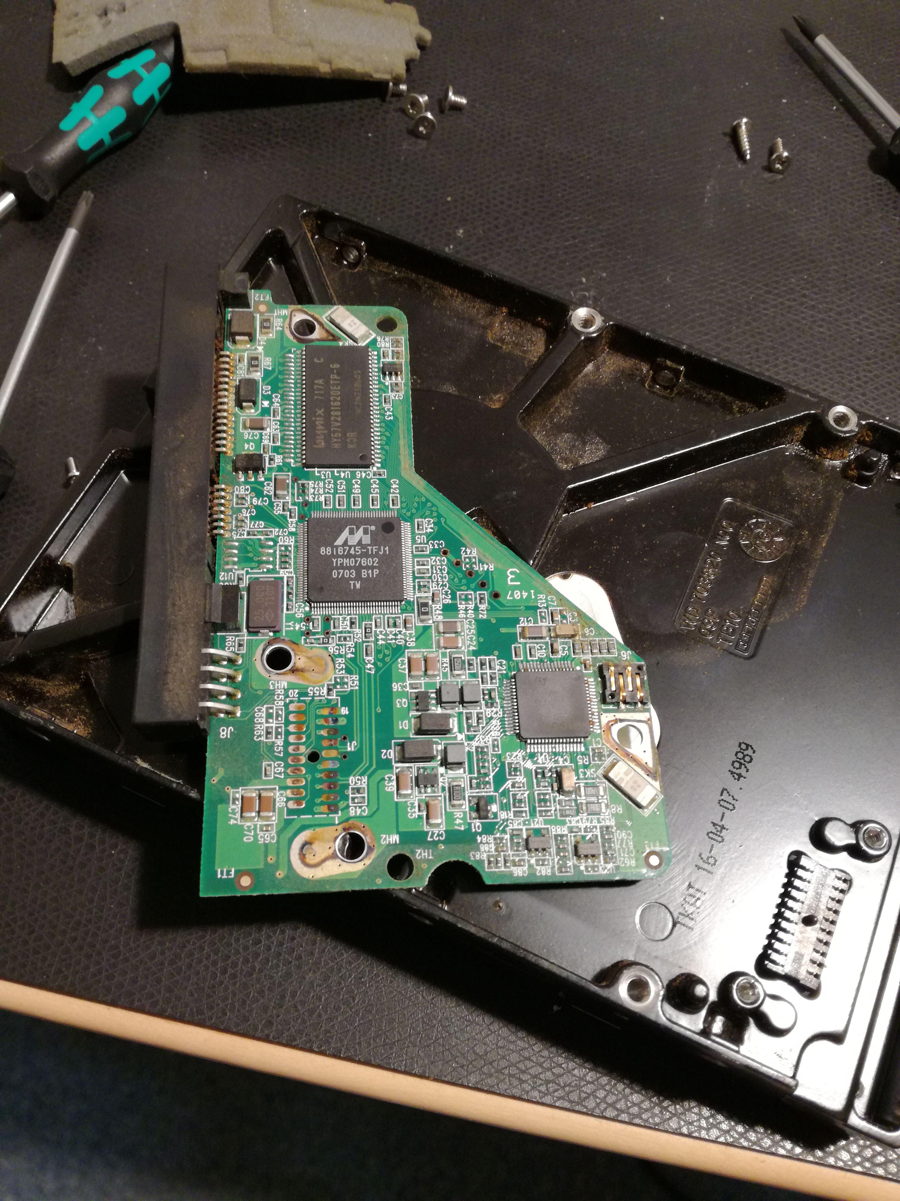

I didn't messed with the firmware, but with the PCB. Why? Take a to the picture of the PCB. Before I do anything with the heads of the drive, I try everything else. And I didn't mess anything with the firmware, I just rewrote it to a donor PCB.

is it just the lighting, or is one of the read channel pads lifted? I don't see how you could have read anything if it's lifted, so must just be the lighting.
