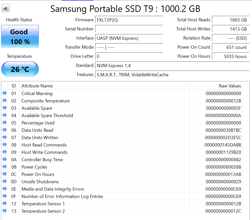

Can you retrieve a SMART report?

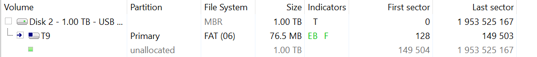

Can you show us the Partitions tab in DMDE?

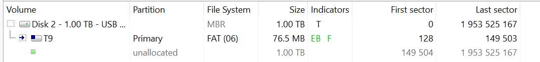

Thanks. Here is the SMART information and the DMDE Partitions tab.

Available Spare is down to 95% (= 0x5F), so the drive has already begun to degrade.
As for the 1TB partition, it appears to have disappeared from the partition table in sector 0, unless it is some quirk of Samsung's encryption. I would use DMDE to examine sectors 0 and 149504. Use Tools -> Copy Sectors to copy these sectors to a destination file on another drive.

Thanks. I checked both sectors with DMDE.
Sector 0 contains a valid MBR with the ~76.5 MB FAT security partition, and 149504 is completely zero-filled.
Since the T9 is still locked, I suspect this may be Samsung’s encrypted/locked view rather than the actual underlying data.
I can also attach the two 512-byte sector dumps if useful. :cry:
