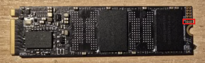

Hi hello. Need shorting points to enter safemode on this board.
Details:
Main Cpu MAP1602A Maxio
Nands: 2x Longsys YMTC 232L
Interface nvme.
Here is picture:
File comment: Lexar nm790.

This SSD looks similar:
https://www.igorslab.de/wp-content/uploads/2025/09/SSD-Naked.jpg
There is an SOT23-5 IC to the right of the Maxio controller. I suspect that it provides the VCC supply for the NAND flash. If so, then you could short its enable pin to ground. This will turn off the NAND supply and cause the controller to panic.

This is marked ic 8102.
A try make clearly from my phone but all the time picture is not clear.

I try, and nothing, can't detect drive, nothing. This IC is 1.8V for maxio chip, but for nands is PMIC
Marking code
EAEHcH or EAERcH

Yeah, nice. The pcb revision is PCM0002A1727.
 Post subject: Re: Lexar NM790/MAP1602A- need shorting point for ROM mode.
PostPosted: September 1st, 2026, 20:01
Posts: 17253
It is FAE:
https://www.comptoir-hardware.com/images/stories/articles/stockage/ssd/lexar/nm790/nm790_face_aoilp.jpg
You could at least determine which test points are connected to ground or the supply rails.

It would be SY8686K Marking FAExyz but i never seen any datasheet for this IC.

SY8686K, Silergy, High Efficiency and High Integration PMIC for SSD System, 3 bucks + 2 LDOs, marking FAExyz, CSP2.42×2.82-36:
https://us1.silergy.com/zh/download/downloadFile?id=6348&type=product&ftype=note

Yeah, Great, but as you can see, PMIC supplied SOC in my case SOC is Maxio so if i disable power for SOC this I won't be able to enter ROM mode.
PostPosted: September 2nd, 2026, 8:40
Posts: 17253
The trick to enter ROM/safe mode (or ERRMOD) in some Samsung SSDs is to short the I2C clock and data pins. You might try to determine if the I2C pins are present at the test points.

I found the shorting points needed to put the SSD into loader mode: short the two test pads directly above the screw mounting hole during power-on. In the first picture in this thread, these are the two lowest pads (of the 12) on the right side.

huibooo wrote:
Thank you both for this thread.
can you paint which are pins?

pikus_09 wrote:
My SSD is a "Lexar 2TB NM790 M.2 2280 PCIe Gen4x4 NVMe SSD". It looks quite the same, as in your picture, but I am not 100 percent sure.
File comment: Lowest two pads above the screw mounting hole.

I know only very little of Hardware. I tried to find the shorting points with the help of an AI Assistant and measuring the pads with a multimeter, but in the end I trialed a bit and then found the pins. I then got me some mass production tools from chinese websites (you gotta pay in chinese currency) and a external M.2 NVMe via USB enclosure to use them. But in the end I could not restore my drive to a working state, as the "Jump to system" after the R/W Test did not work. I've spent some 15+ hours trying to get the drive back to live, but to no avail. I wish you better luck :)
If you want I can dump a generated summary of my AI assistance of what I tried, but I don't want to clutter the thread here. I think the shorting points are the only real help I can give you, as the rest sadly did not work.
