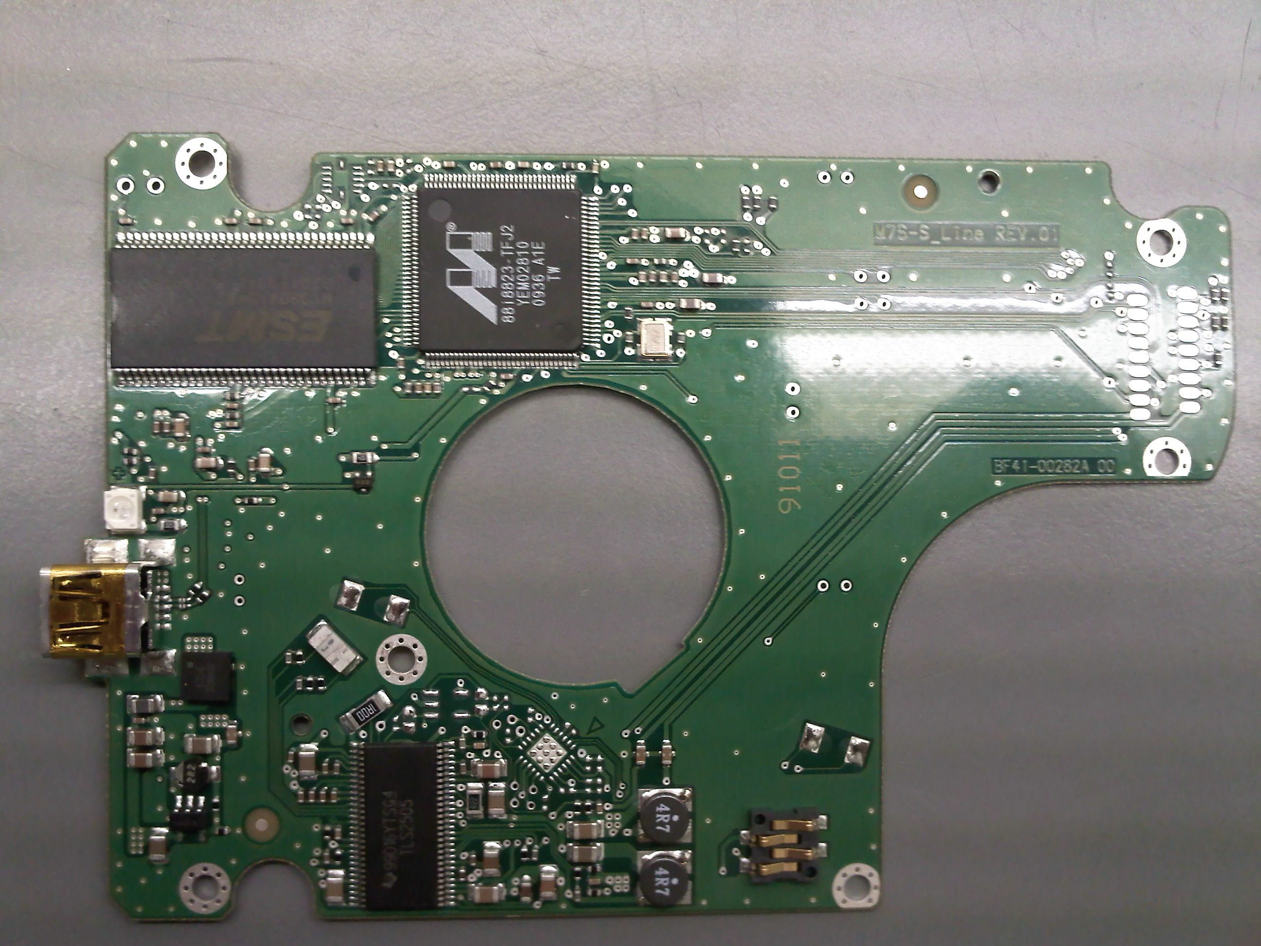

We have started seeing some of these Samsung 2.5" drives with only USB connectors on the PCB. No SATA or any other connectors. The one we have is a 500GB.
Has anyone been able to find points on the PCB to access the drive via SATA or terminal?

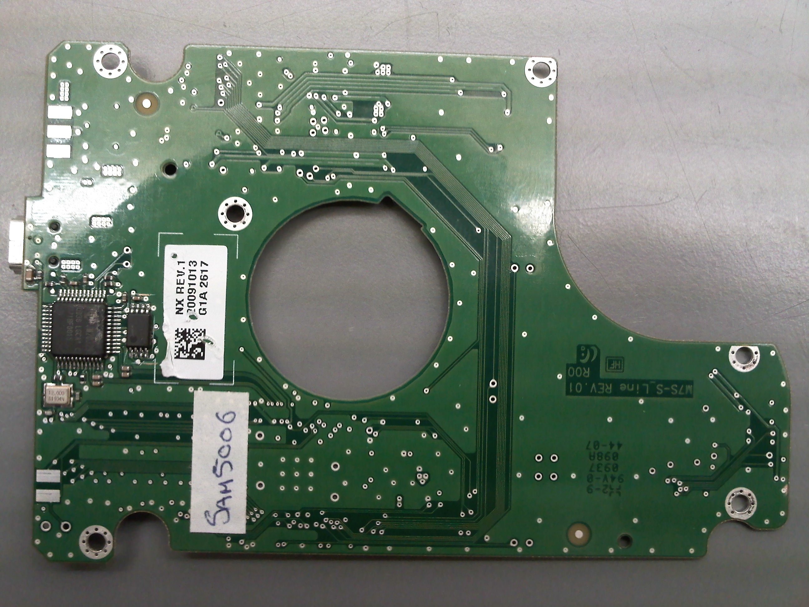

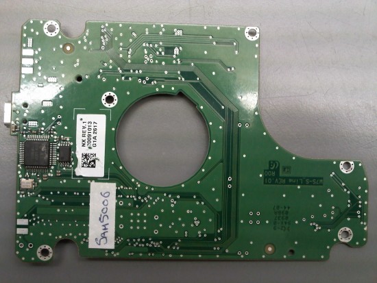

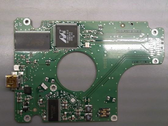

I have attached some PCB photos.
File comment: Another Samsung PCB Photo
File comment: Samsung PCB Photo

 Post subject: Re: Samsung HM502JX USB Only?
PostPosted: April 2nd, 2010, 2:49
Posts: 17038
This URL ...
http://usbspeed.nirsoft.net/?pdesc=SAMS ... 1&pid=9001
... suggests that the USB-SATA bridge is a JMicron chip. The VID and PID are 152d and 2329, respectively.
Internet searches suggest that the bridge is a JM20239.
Here is an application circuit:
http://www.hxwtek.com/upload/jm20329_st ... 20open.pdf
The pinouts are:
21 RXP
22 RXN
25 TXN
26 TXP
39 UA1
40 UA0

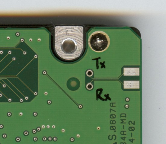

Here are the locations of the SATA and RS232 Tx/Rx pins:
http://www.users.on.net/~fzabkar/temp/H ... serial.jpg
I don't understand the function of the UART pins, but I suspect they provide terminal access to the JMicron bridge chip.

Connect the Rx and Tx points to a SATA connector according to the following pinout:
http://pinouts.ru/HD/serialATA_pinout.shtml
Remove the four coupling capacitors near the JMicron bridge chip.

Posts: 17038
The best course of action is to engage someone to resolder the USB connector.
The drive needs to be powered from the USB +5V and ground pins.
The "terminal" pins alluded to by Mikippp are for diagnostic access via RS232, not data access.
If you are intent on pursuing a direct SATA connection, then you need to tap into the SATA Tx/Rx signal pairs (not RS232 Tx/Rx) that run between the JMicron bridge and the Marvell MCU. You can see them at the bottom right corner of this photo clip:
If you follow the signal traces back to the JMicron bridge IC, you will see two pairs of capacitors. You will need to remove them. Consult the JMicron reference circuit to identify the individual signals.
