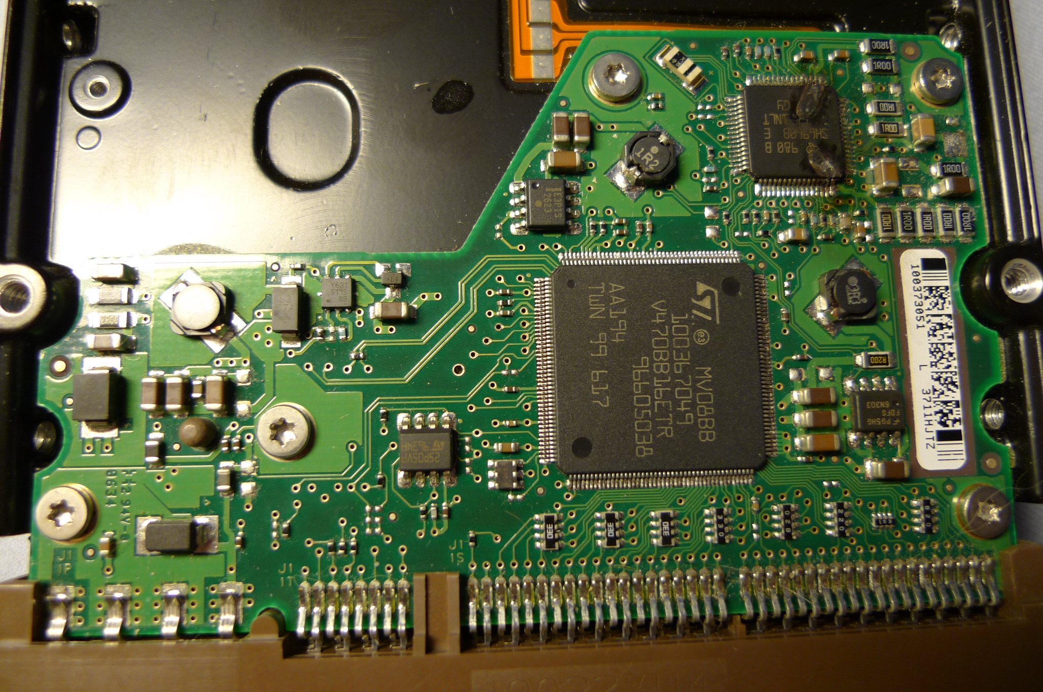

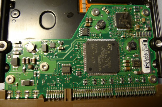

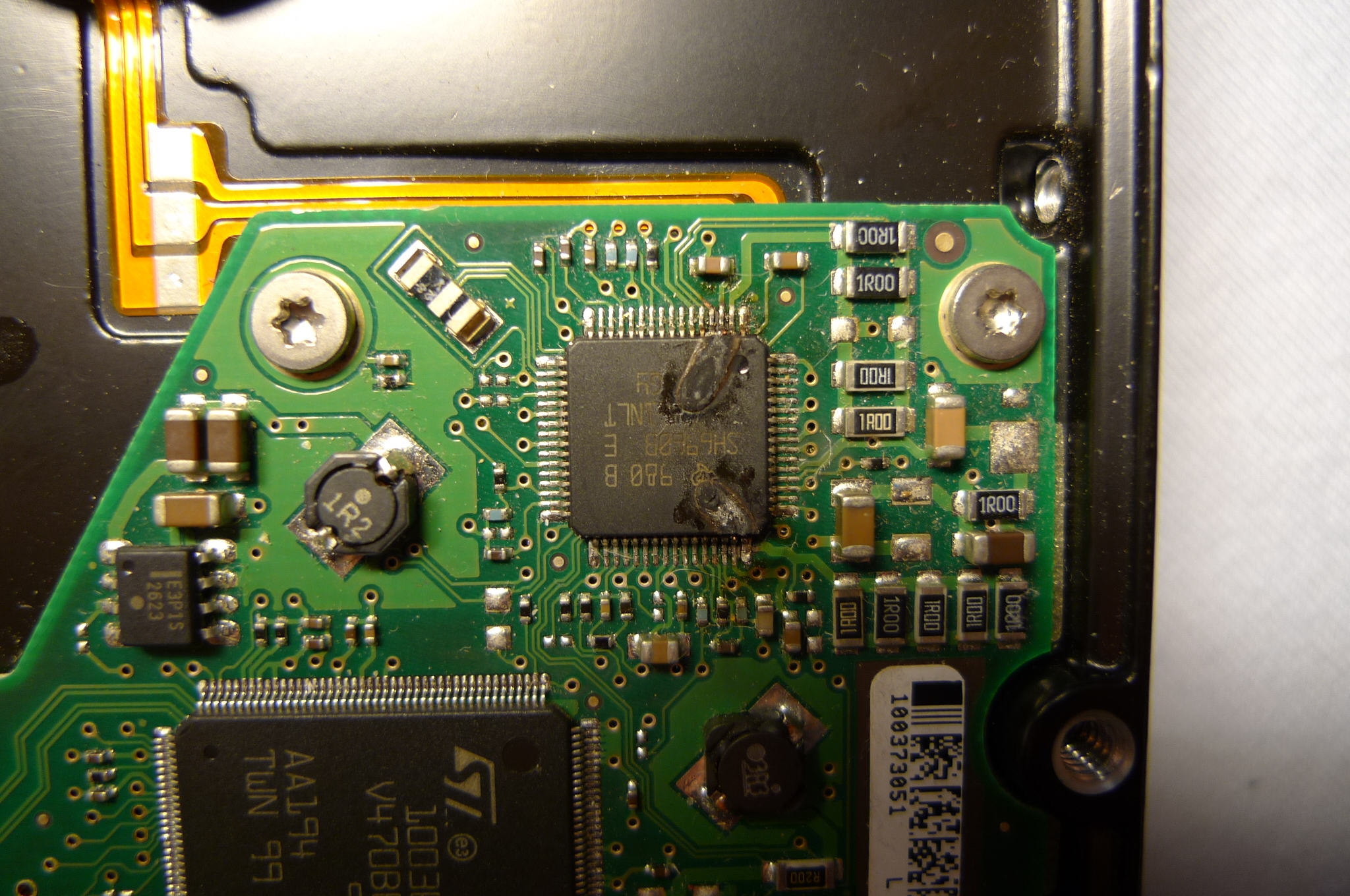

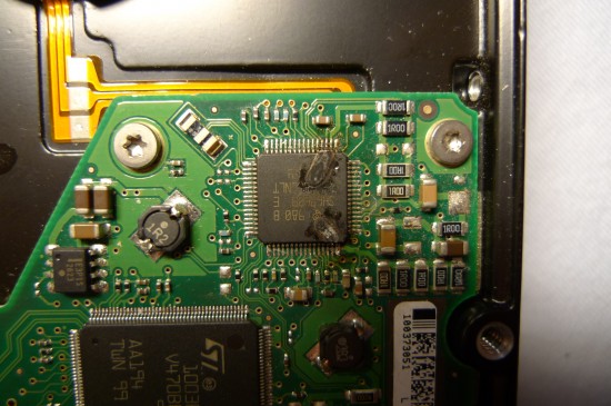

What I have in my hands is a burnt out HDD from my fiancee with all her high school / college photos on. If we had a 1000 dollars spare we would send it to a professional recovery service, her father is a computer professional and said he cannot fix it... I doubt that, since he did not spend much time evaluating the drive.
There is no spinning sound or any other noise coming from this HDD whenever it is on power supply.

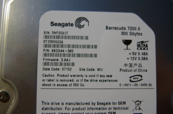

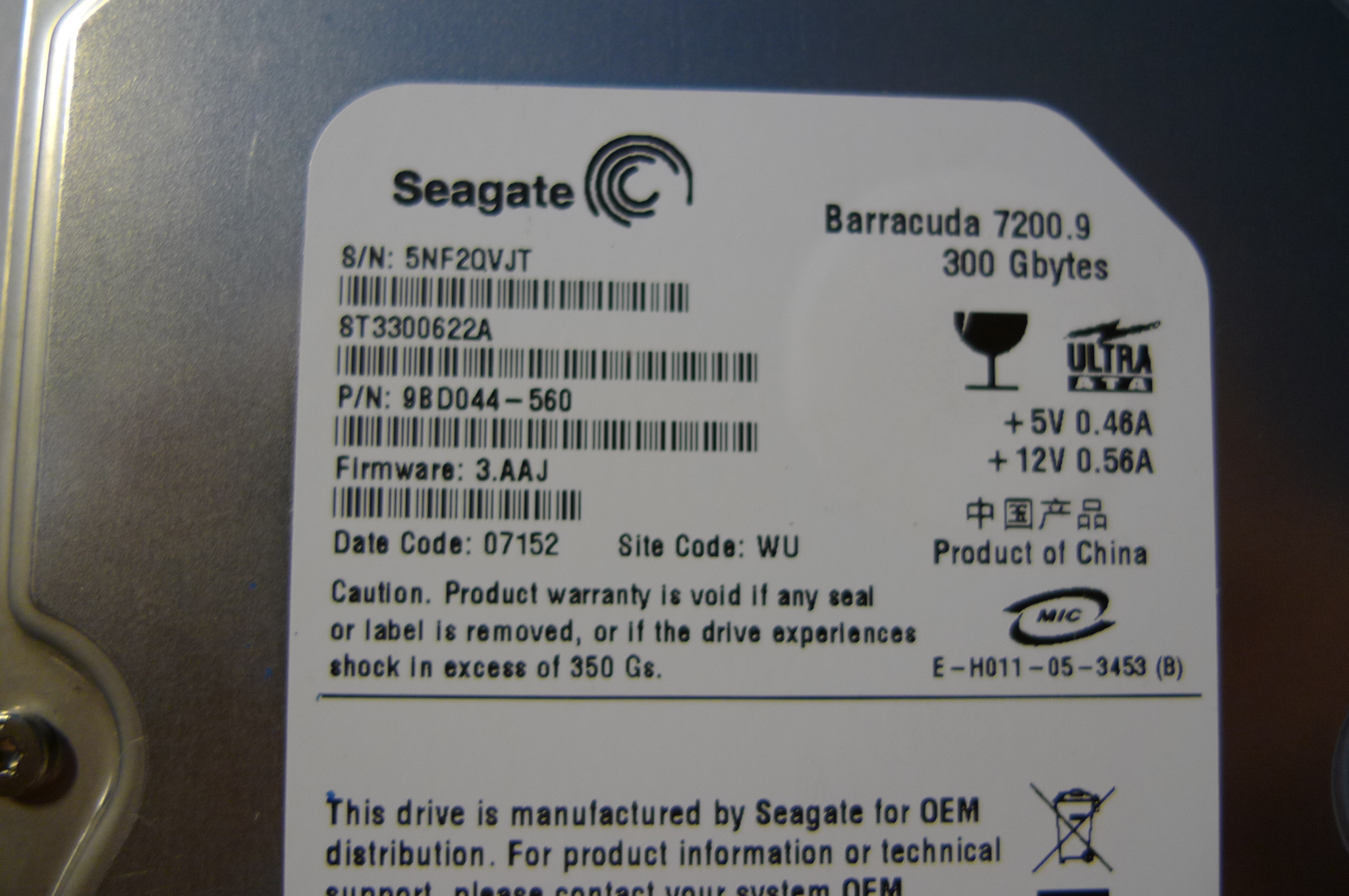

So my plan is to remove the pcb (I think the smooth chip is burnt) and replace it with one pcb of the same HDD type I found on ebay (ST3300622A). Since the pcb number is almost never listed on ebay, I was wondering if it is worth the try to use the donor drives pcb even if the pcb numbers dont match but only the ST numbers.
My pcb number is 100373051.
I would like to replace the PCB and have read over some posts.
How likely is it that there are other parts broken of the hard drive that I cannot see from the outside, e.g. if the preamp is blown? Was it just a voltage spike that could lead to such damage?
Why do I have to replace the EEPROM chip (which I read in your forum). Can I not take the risk and not replace the ROM chip or will it destroy the drive? I do not have a hot air gun handy...

The EEPROM contains information specific to your individual Hard Disk which the disk depends on for normal disk operations.
The damaged chip is responsible for spindle motor operation, and as this is bad there is a definate chance of damage to the motor.
The best option is to have this disk professionally evaluated to at least identify if there is further damage. If this is not an option, then you can try transferring the EEPROM to a good PCB which is required, but if there are in fact other complications you could make things a little worse.

these SMD's can be fragile to heat. You need to extract the chip quick. and put it onto the donor- quickly too and aligned properly with all legs soldered. the slightest static discharge will fry the chip too! take it to somebody who can transfer this for you- somebody who does it everday. give them a few bucks and try that. if it does not work- i suggest you save up for professional recovery. and keep all parts safe and properly marked.

FW-exact; DATE-close as AND SERIAL NUMBER XXXXyyyy x-Identical y-close as not critical.

Just check the number of the pcb , in your case its 100373051 . Get any pcb with same number and then swap ROM .
