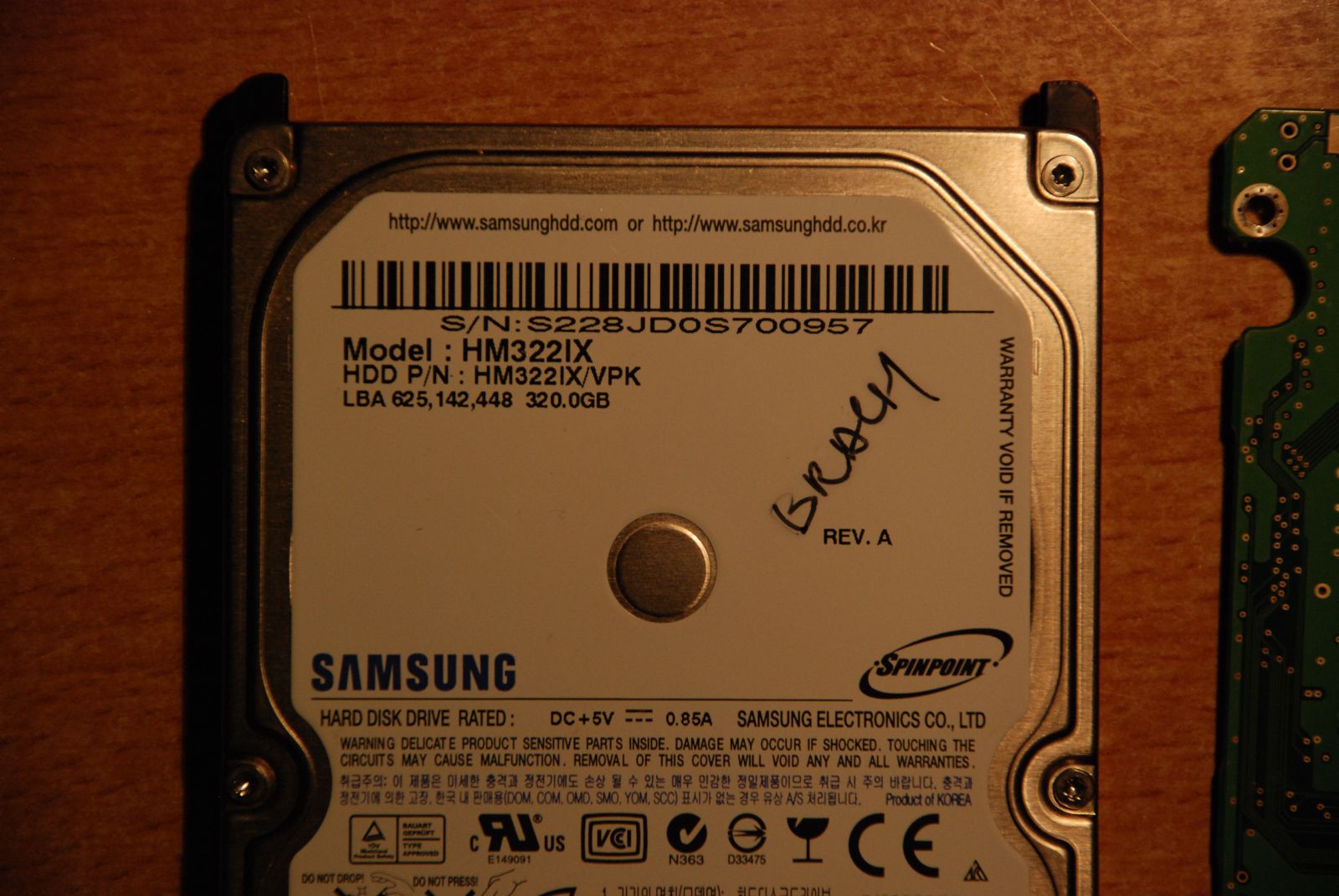

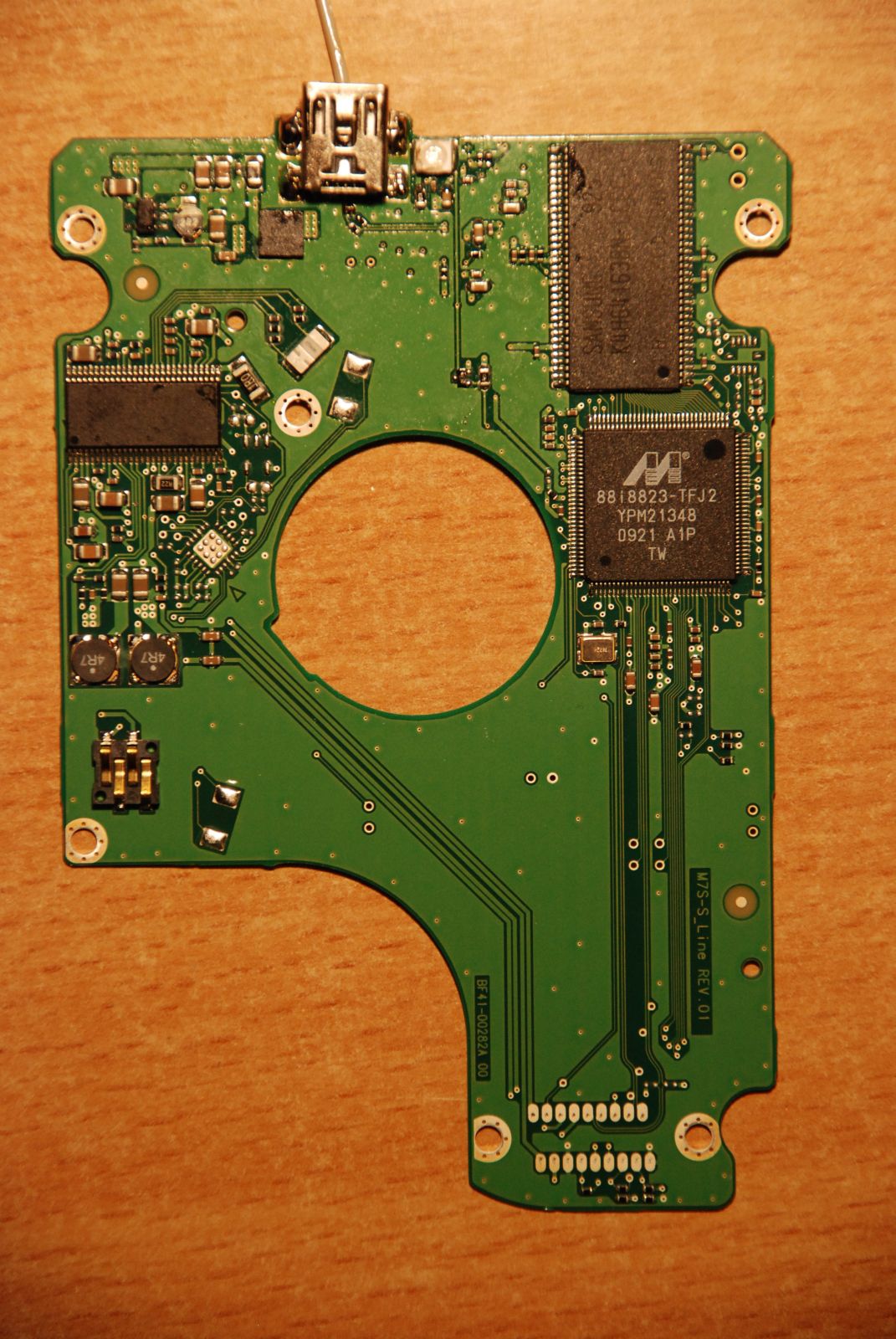

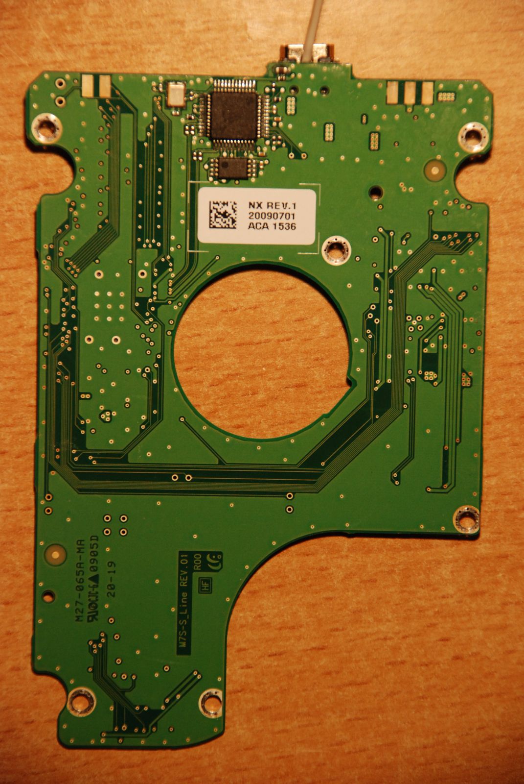

I have Samsung HM322IX. In this drive is USB interface only, which was cut off - it was under connection via USB. After solder new miniUSB plug, drive is not recognize - standard popup "USB Device Not Recognized". Probably USB controller is dead.
I don't have other the same PCB on stock.
1. Does anyone know, where I should connect SATA on this PCB - pinout?
2. Maybe there is SATA PCB compatible with this one. Which?
Marry Christmas to all :)

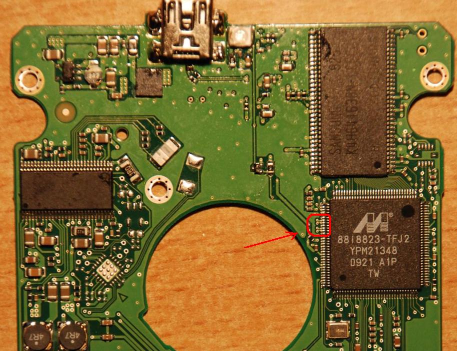

The first thing I would do would be to verify continuity between the various pins in the USB connector and the pins on the USB-SATA bridge chip. To this end it would help to know the part number on the IC -- the USB Data+ and Data- signal traces disappear under the IC. Is it a JMicron, Initio, Oxford Semi, Cypress chip?
You may achieve easier access to the USB pins by connecting a USB cable and testing for continuity from the larger host end.
The SATA Tx/Rx pairs are easy to identify. You can see two thin pairs of capacitively coupled traces exiting the left side of the bridge chip and running down the board towards the MCU. To gain SATA access, remove the capacitors and then tap into the 4 inline plated through holes at about 10 o'clock on the circumference of the centre circle.
I believe these are the correct pins:
http://www.users.on.net/~fzabkar/HDD/HM ... A_TxRx.jpg
http://www.users.on.net/~fzabkar/HDD/HM ... _minus.jpg
The order of the SATA Tx/Rx pairs would most likely follow the same pinout as a SATA interface connector, to allow for a neat PCB layout.

Thank you fzabkar, I check your hints.

USB controller: JM20329 0915 LGCA1 C 370VW0015.

I connect SATA interface, data recovered 100% ;) Thank you fzabkar for good info!

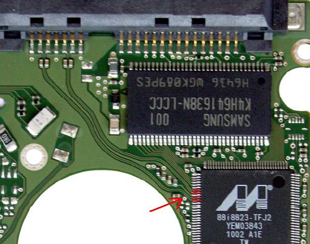

arvika, I had the same problem today with my HDD same model, i need more information about the Sata connection. Do you have pictures?
 Post subject: Re: Samsung HM322IX USB interface fail
PostPosted: January 6th, 2011, 4:30
Posts: 1091
Location: Angel Data Recovery
A little attention and you could find yourself , compared with usual PCB.

Exactly ;)
