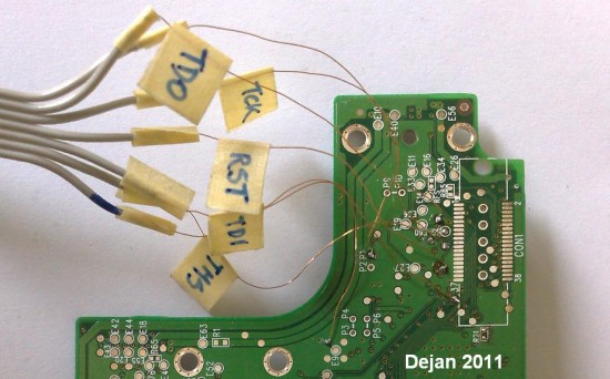

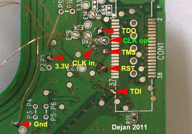

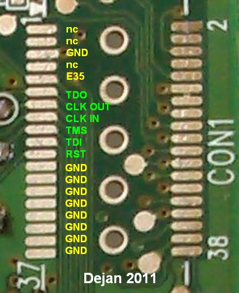

It seems that nobody wants to help me, so I've find JTAG pins by my self!
Hope that somebody will be interested.
JTAG pins are on board CON1 and it seems that is same on all boards?!!
I tested on 2061-701335-c00 Marvell 88i6545 and 2061-701499-e00 Marvell 88i6745n.
Both chips have same ID 0x259663d3 !!!
Here is connection to 2061-701499-e00.
And closeup connection to JTAG test points.
And closeup connection to JTAG CON1.
B.R.
Dejan

CONNECTION TO Marvell 88i6745n:
As you can see in my previous post there are JTAG pins:
Pins that MUST be used!
GND
TDI
TMS
CLK in
TDO
Pins that can be used or not depend on your JTAG interface!
Vcc 3.3v - for powering JTAG interface or for reference.
CLK out - for VERY FAST JTAG interface that support CLK out
RST - for JTAG interface that support RST
For Xilinx III JTAG interface only GND, TDI, TMS, CLK in, TDO, Vcc 3.3 is used!

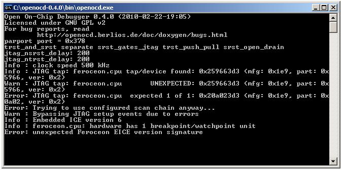

5. Go to openocd\bin and type: openocd.exe -f jtag.cfg.txt -f feroceon.cfg
If everything is ok you have to get something like this:
As you can see device ID is 0x259663d3 and since OPENOCD do not have appropriate loader
we can use "feroceon.cfg".
If you get ANY other error try to read OPENOCD documents!!!

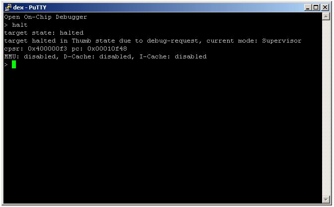

7. In telnet type: halt
If everything is ok, it will look something like this:
That means that you have FULL controll over Marvell 88i6745n !!!

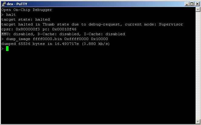

It is on addr 0xffff0000 in size of less than 0x2000
@All
To dump bootstrap from Marvell chip, after "halt" from OPENOCD type
dump_image ffff0000.bin 0xffff0000 0x10000
If everything is ok, it will be something like this:
And file "ffff0000.bin" will be created in openocd\bin dir.
In my case SHA1 of "ffff0000.bin" is 5ab6b58869a6cf40aaa60626e8440c0abc186ae8
Now you can use any ARM disassembler to analize code!!!

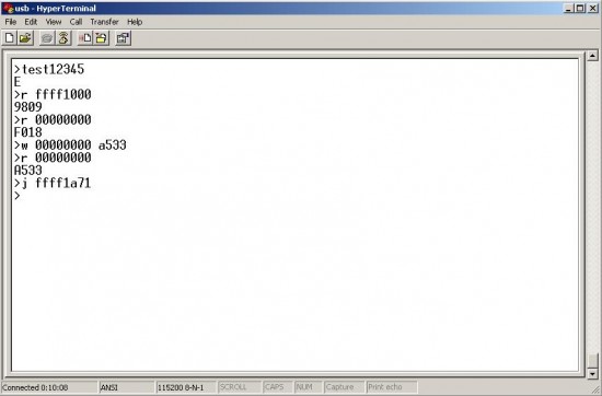

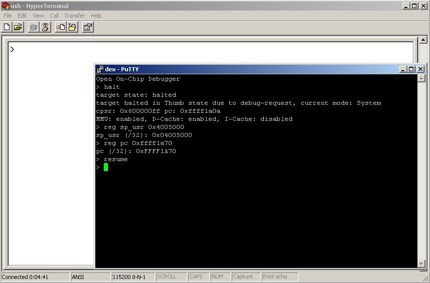

Function "start tiny console"
After HW reset, CPU test port 0x1C00A84E. If bit 13 is set it runs "start tiny console"!!!
Tiny console have only 3 function:
r <32bit address> ;read one half word(16 bit) from address
w <32bit address> <16bit data> ;write one half word(16 bit) to address
j <32bit address> ;jump or call code on address
With those 3 functions we can do everyting with CPU on low level.

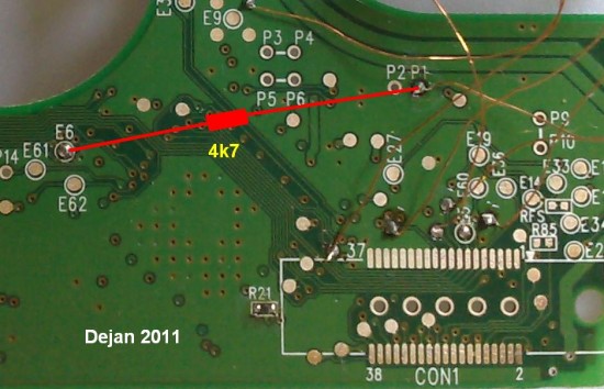

Problem is how to set bit 13 on 0x1C00A84E.
Port 0x1C00A84E is connected to 4 pin (8 pin on 3.5'') jumper header, so bit 13 have to be
connected to some pin or by using some combination of jumper header!!!

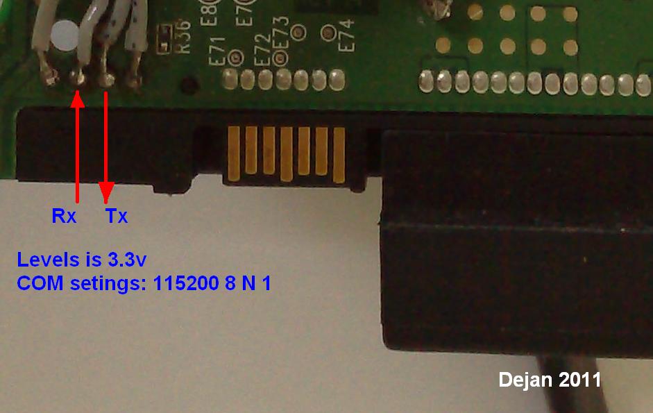

I tested tiny console by calling it using JTAG:
Connect COM or USB to COM port with 3.3v levels to board:
Set you COM port on PC to 115200 8 N 1 using Hyper Terminal and run.
Now, run openocd:
halt
reg sp_usr 0x4005000
reg pc 0xffff1a70
resume
Hyper Terminal will be prompted! Now you can switch to Hyper Terminal and type for test:
If we can find a way to run tiny console, then we can access CPU without JTAG!
B.R
Dejan
I doubt that
More likely it will live on CON1

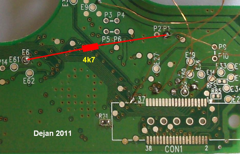

"Tiny Console" is activated!
Connect resistor 4k7 to P1 test point (+3.3v) and E6 test point.
Connect Rx and Tx line to COM port.
Connect SATA POWER conector.
Run Hyper Terminal on PC with setings 115200 8 N 1.
And that is it!!!
B.R.
Dejan
 Post subject: Re: Marvell 88i6745n JTAG
PostPosted: August 30th, 2011, 15:29
Posts: 3598
Location: Chicago
So you made "5" (or maybe it was 0x1C00A84E)
If you make it "3" you'll get X-Modem
Great work
