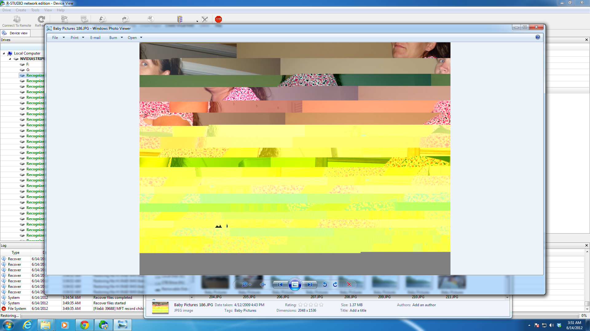

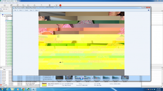

Hi. I am new to this board and have been reading for hours before registering and more hours after registering trying to find some answers and help. I have 2 640 GB WD Caviar Black drives that were in a RAID0 array with 2 partitions. 1 986ish GB part and 1 205ish GB part. 205 Part had windows 7 on it, the rest was just storage. On a 3rd hard drive not part of the array I was running Windows XP Pro.
I was using BCEdit for multibooting, took the winxp out of the menu, rebooted and all was good, no menu, just booted into Win7 fine. I figured I was safe to format the 3rd IDE drive with xp on it. Boy was I wrong. NTLDR missing problems and the like endured. In my bios i deleted mbr on array and deleted array. Put Win7 on IDE drive and re did array in bios, used Hiren's Boot CD in windows and used DiskGenius to recover the partitions I had in the array, I have the 986GB partition back, but none of the files work and the 205 gig part would just show up as unallocated, so I formatted the unallocated back to NTFS just to get a drive letter to try and do some recovery with. I have been using R-studio to try and recover the data. out of the 7-800 gigs of data I can live without there is about 7 gigs of photos of my son from when he was born and when my wife was pregnant. I have attatched 2 files of what I am getting back as photo data.

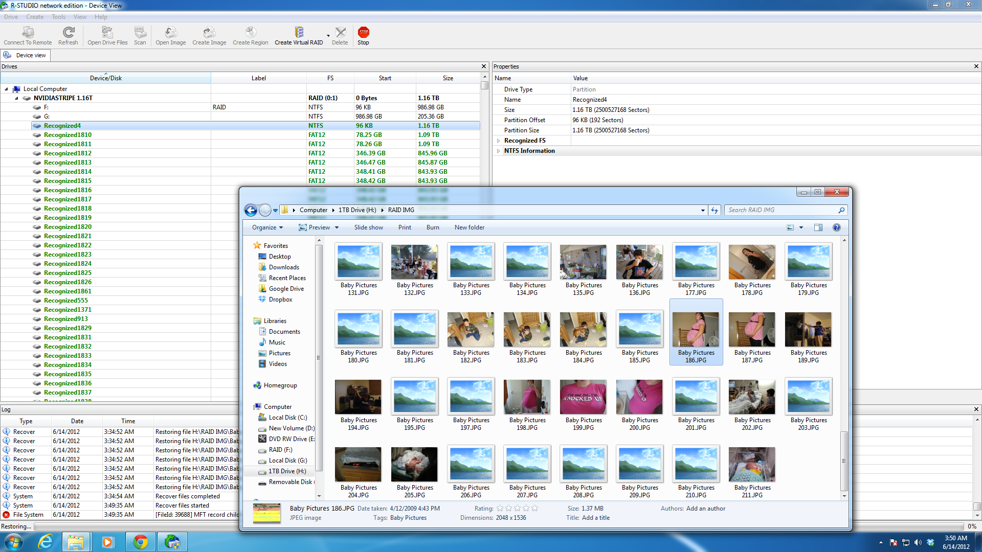

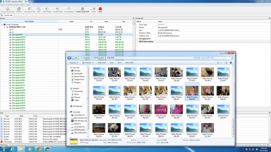

I have some understanding of why the picture is the way it is, but I do not completely understand what to do with R-Studio to get it to recover the files correctly, what I am really looking for in the hex info and such. Please help me guys, I see Dr. Kiev is a RAID genius and recovery expert, any and all insight will be so helpful. Oh, also after I recovered the 986 gb part, chkdsk ran for AWHILE and did some MFT security id replacing and some other stuff. Am I just totally f**ked?

I don't have time for a long reply. As you might have guessed by now, you've made some mistakes in your steps so far, compared to those appropriate for data recovery - specifically reformatting and running chkdsk. This may exceed the complexity which can sensibly be assisted via a web forum, so you need to consider the risks of doing any more DIY recovery attempts yourself (i.e. you could make things even worse).
I have 3 questions, based on a quick review of your story so far - of course other readers may have more or different questions / suggestions:
a) Did you reconstruct the RAID 0 volume identically to how it was before? If so, and given that some image data still exists (so the disks were not zerofilled during the volume (re-)creation), then I don't see RAID as being part of your problem.
b) You seem to say that you re-formatted the 205GB partition. You don't mention re-formatting the 986GB partition. Is that correct? I'm not sure we have all the steps listed, that you performed...
c) Where are the photos that you want to recover - on the 986GB partition or the 205GB partition, or both?

Somehow in the steps you have done, you seem to have damaged the filesystems in both partitions, but specifically we're interested in the photos in the 986GB partition. The corrupted ("jumbled") large image in your first post is typical of large files which were fragmented in the filesystem, and which are being recovered using a raw recovery (i.e. without using the original (correct) filesystem information). The thumbnails are much smaller and are typically contained within just one cluster or two clusters, so they are often not corrupted, as you can see.
Without knowing exactly what DiskGenius did, I can't be sure of the exact step where filesystem damage occurred - if I had to guess, it might be the chkdsk step, but it could be something that DiskGenius did. However, this situation is now beyond what I would try to assist with remotely via a web forum.

P.S. Looking at the R-Studio screenshot, I'm surprised about the device you seem to have chosen for it to work on. Isn't the 986GB "drive F:" the appropriate drive letter to choose?

what you see is the scan information done on the NVIDIASTRIPE 1.16TB. F and G are the drive letters now of what used to be F: = E: G: = C:

Looking carefully to the both pictures you gave, it easy to understand your mistakes :
You mixed drives order , second drive should be first , and other way around.
Block size = 64kb =128 sectors , this setting is correct.
Thats why r-studio found Boot sector (your green Recognized4) offseted (128sectors+63sectors).
And thats why on the big photo, top part of woman's head goes after middle part.
About thumbnails pictures, Vulcan is right.
