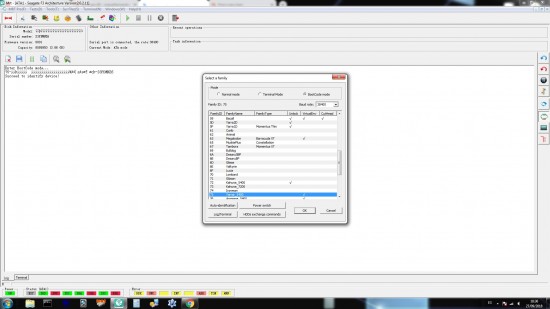

Failed to recognize in bootcode.
It shows wrong characters. In normal f3 normal mode it detects it well.
2 clicks and the mortor stops.
It is a case study, no matter the data.

It is a broken unit.
It does 2 clicks and it stops in 1 second ~.
If I do not connect it to the mrtlab, it does not detect it and the engine stops immediately.
Once I stopped the engine if I detected it with mrtlab I detected it as SEAGATE and then as generic.
I'm going to select it as a thin laptop and it has short-circuited the ROM and if I read it I upload it.
Thank you.

By isolating the PCB and selecting the Yarax family 86 HDD model instead of the one detected by the MRTLAB (Yarrar_5400), the terminal works correctly.
It gives me the wrong head type failure, but it is normal the PCB is isolated.
I assume they are the heads that are wrong. I have visualized CAP, SAP and RAP and they seem to be correct.
