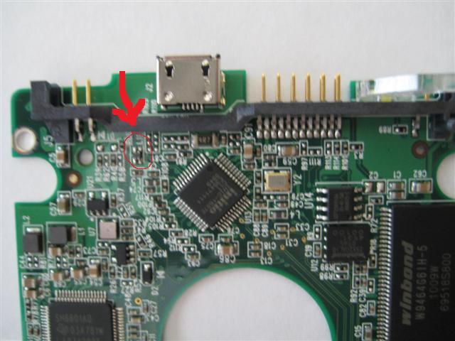

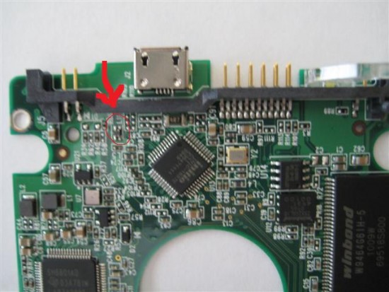

I don't know if this is the right place to ask something about my wd mypassport, but please help me, otherwise I will try the sata way.
what is this thing because it burned on my pcb and i don't know what is it to replase it
 Post subject: Re: WD10TMVV
PostPosted: September 3rd, 2011, 7:18
Posts: 927
Location: uk
Is it 'Lxx'? As it looks like an inductor. I might be wrong though as the photo is not very clear.
I would remove it and check the board for any short circuits to ground across the +5v rail on the usb connector. If board seems ok then use a suitable replacement and check again. Do not use a solder bridge!
You might just be lucky!

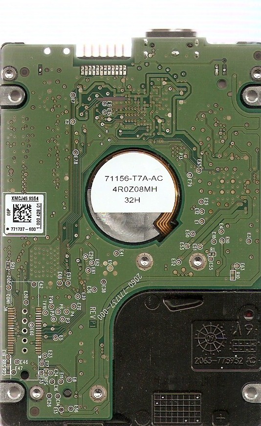

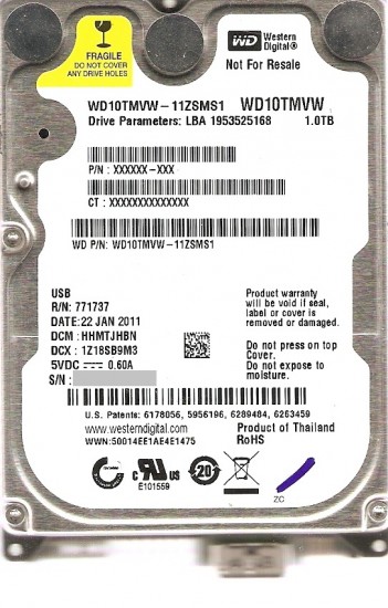

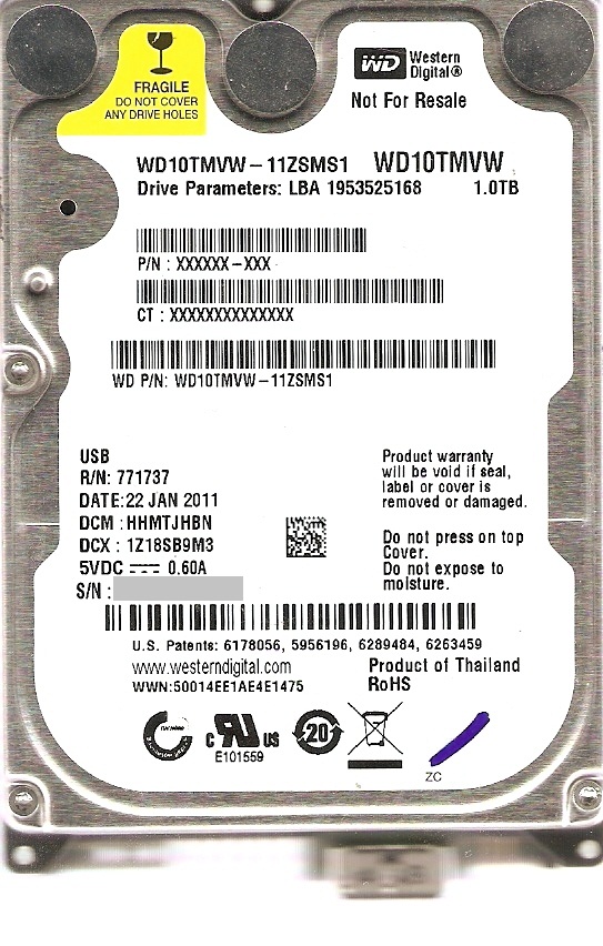

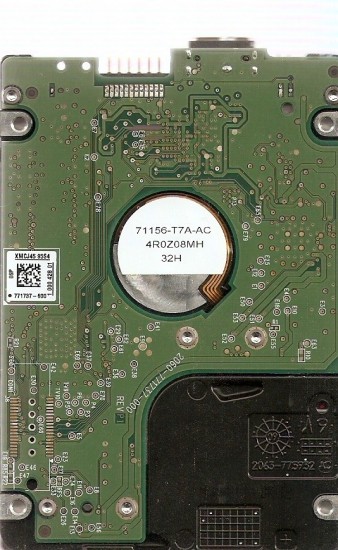

Hi, gurus!
Have the same problem with my HDD, but the model is WD10TMVW, need to get my data.
I hear that it spinned OK, I suppose that the problem with controller. The instruction posted above dosnt have the same pins to connect to SATA.
I am very gratitude for help! Any help, any methods.
Best Regards,
Boris Glebov
PostPosted: November 2nd, 2011, 4:06
boris888 wrote:
Hi, gurus!
Best Regards,
Boris Glebov
If it spins ok then PCB is less likely, more likely to be a firmware issue or bad sectors preventing windows/smartware mounting it properly.
That said, recently I've had a few cases of drives from WD Essential cases that refuse access via the USB and had to be converted to SATA. Not had one like that from WD Passport thankfully, as we'd have encryption to deal with.
I suggest you get it looked at professionally.
