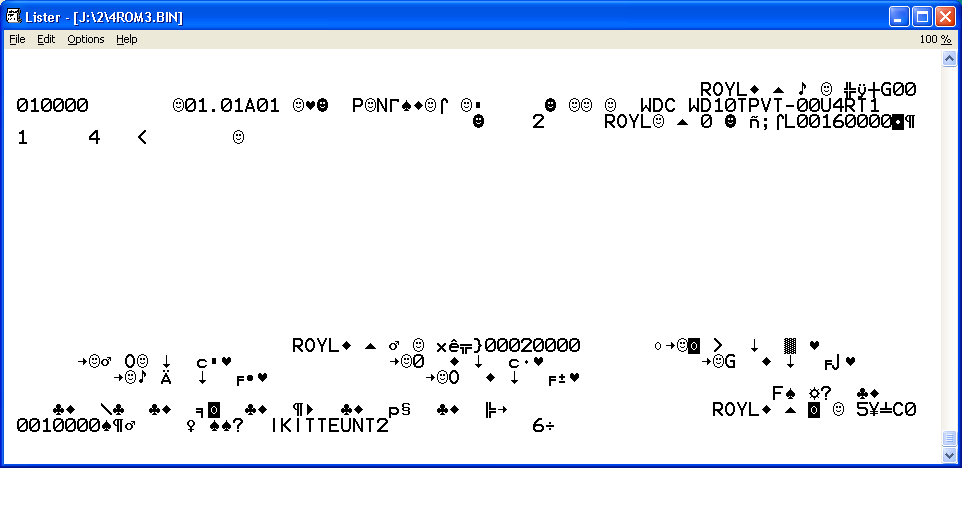

In attempt to determine which one, I executed three SCT scripts for Royl.
1. Reading ROM - success, but it doesn't seem to be complete ROM image.
2. SA rom extraction - it seems SCT command is rejected.
3. D-ram table scan (it would give cyl # and sectors/tr value) - as above
See attached log. Does it help to determine whether it is PCB or headstack?

Here it is modified Jura script to read 256K ROM. It looks like it is the size of this ROM, see strings from last bytes (picture).
