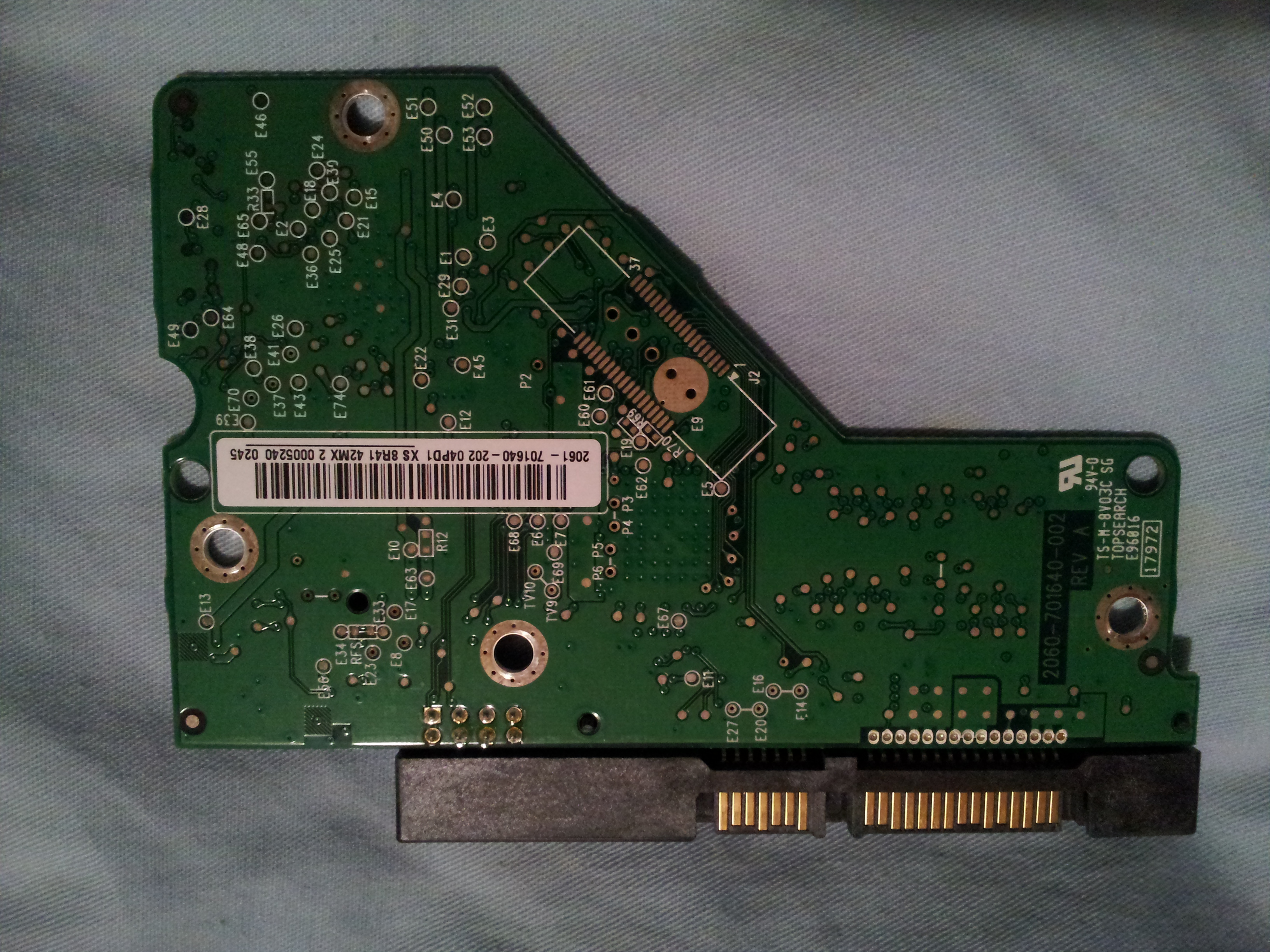

My best friend had this drive failed a few days ago. The HTPC where the drive was mounted was powered on (for at least 2-3 days) and then suddenly he found the system crashed. After reboot he found the WD5000AADS no more recognized by BIOS. The other drive mounted in that PC (a WD10EADS)is still working fine.
He obviously tried to remove the drive and check it connected to another port, in an external box and in another PC, without success. The drive appear to start but it seems it doesn't complete the boot phase and it's not recognized by BIOS.
I attached to this post the recording of the sound produced by the drive, can you please check if helps in understanding what's wrong?
I must say also that my friend, having another drive with a pcb apparently identical, didn't resist and tried to swap the PCBs. It seems the drive reacted in a different way but obviously not worked. Did this attempt compromise data?

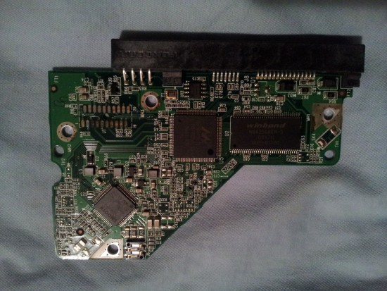

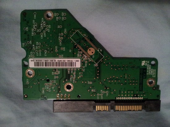

Attached you will find also the photo of the PCB (that we hope it's failed..).
Can you advise? The drive contains valuable personal data (photo and documents mainly).

One swaping out PCB will cause the drive to click and heads to not seek correctly because the PCB contains adaptive data for this drive stored in the sprom. You will need to swap out the eprom to read drive correctly.
Second you problem is not in the PCB but in the drive itself. You might have a failing head on this drive. Advise not possible for you to swap out heads. Two this could be an issue in the SA and some critical modules damaged. Again not possible for you to repair this one. You have to have this diagnosed correctly before it can be repaired. You do not have the know how or knowledge to do this one and the only way to do this is from a professional DR company.
You are located in Italy and can recommand that you contact BlackST here on the forum and send him your drive. He is a valued member here and can hand this for you. You will need professional tools in order to diagnose this problem correctly. Any attempt to try DIY on this one will only fail if you do not understand how the WD drive works. If you value this data and it is important to you are you say it is then you will need a DR company with the proper tools to work on this drive. Good luck

Almost every one we see with this symptom is heads-related. A bad PCB is a possibility, but the "odds" are that it's not the PCB. Of course, there are exceptions to everything . . .

According to what I hear in recorded sound file, drive calibrates and start to load FW but cann't finish. Preamp, head(s), modules issue... who knows, it can be anything of that.

First of all we would like to thank everybody for the advice. We understand the advantages of professional recovery services but we would try another attempt. We tried to clean the J1 contacts with a rubber without success.

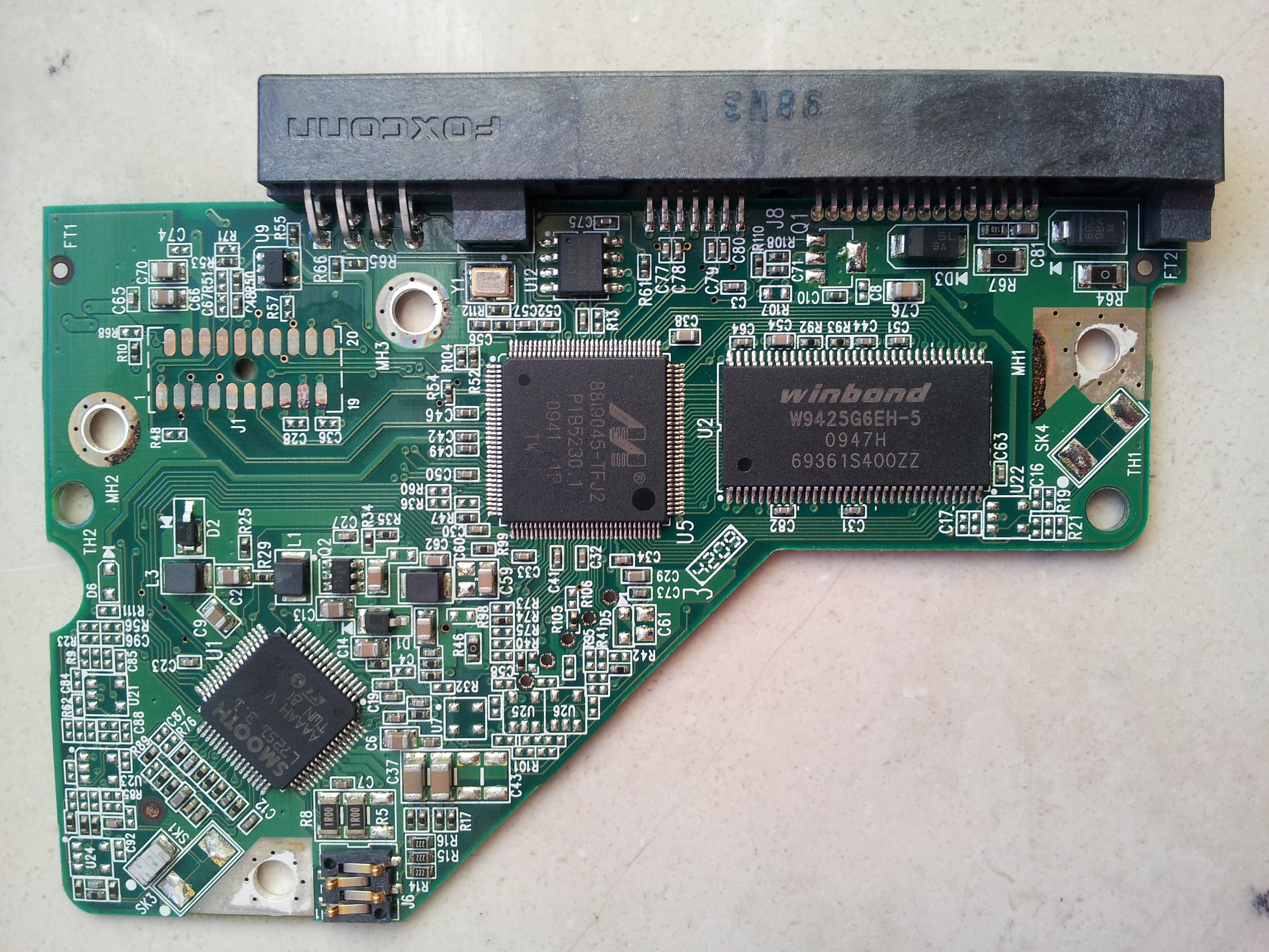

Now we would like to try the change of the PCB swaping the chip in U12.
For this we thought 2 options:

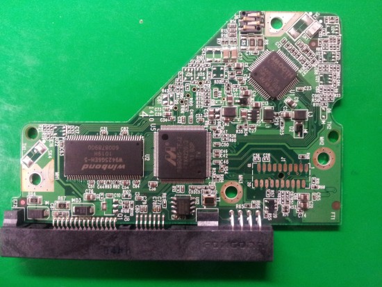

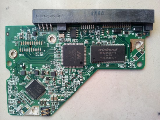

1. use the PCB from the another disk, a WD10EADS (that is still working). The details of this disk are the following: model WD10EADS-00P8B0, DCM HHRNHV2MA, DCX 0007P1W81. I attached 2 pictures of this PBC.
2. buy this PCB from ebay: http://www.ebay.it/itm/PCB-Controller-2060-701640-002-WD5000AADS-00M2B0-Festplatten-Elektronik-/230931715690?pt=DE_Elektronik_Computer_Computer_Festplatten&hash=item35c49a566a&_uhb=1#ht_526wt_957.
Which one is the best? Is the PCB from the WD10EADS suitable?

Spildit wrote:WD5000AADS-00M2B0
and
WD10EADS-00P8B0
ARE NOT COMPATIBLE ATT ALL AND WILL NOT WORK.
Don't want to hurt anyone but couldn't resist this time. You already did one mistake with your assumption , and you are doing 2nd one in same topic . Don't you ever seen desperate customers when they lost their data forever coz this unprofessional help ?
Spending money to buy another PCB for this drive is total wasting time and money .
jono-ats was right about most possible issue .

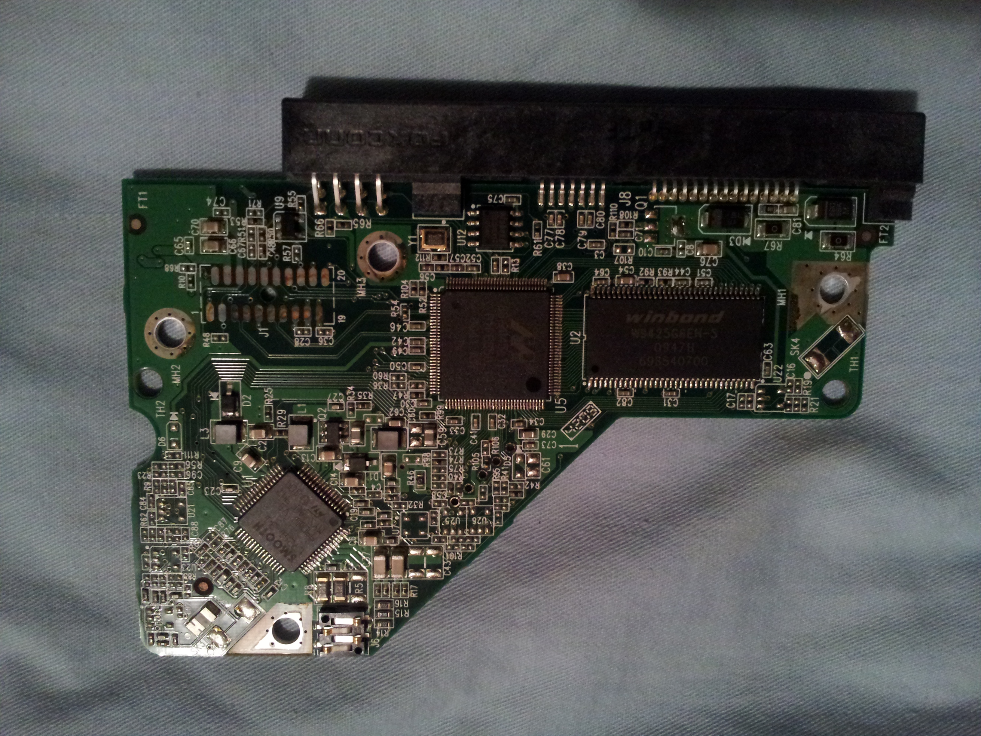

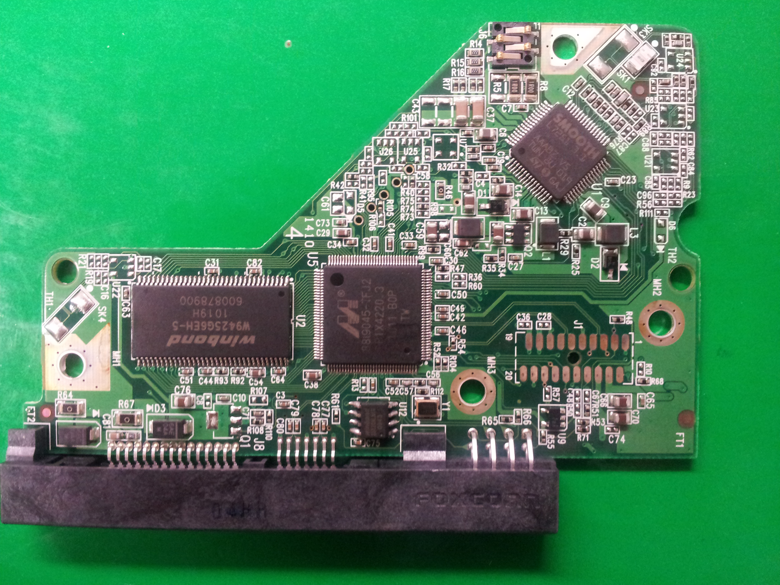

Hi guys. We decided to take the risk and ordered a PCB.
The PCB arrived and we tried the PCB swap "as is". As expected it didn't worked(win a lottery is really difficult :) !).
Today we swapped the U12 chip as well and there is both good and bad news:
1. the disk is now recognized in BIOS and it started working almost normally (no more strange noises apparently);
2. the File system is not recognized and Windows says it needs initialization.
Can you please advise on how to proceed?

1. No, we can't clone the drive at all. We tried but the software we used (R-Studio) remains stuck for days without detecting anything and giving error only I/O errors (1117). Unfortunately our first attempt stopped after 3 days with a black-out (lucky guys here :)) and we didn't try anymore;
2. The noise appear normal (no more clicking noise), please check the attached audio recording;
3. MCU name is the same only for the first row, see the first pic in the initial post and the attached pic. Original PCB MCU code is 88i9045-TFJ2 P1B5230.1 0941 A1P, new PCB MCU is 88i9045-TFJ2 P1X4220.3 1011 B0P;
4. Drive name reported both on BIOS and OS is WDC WD5000AADS-00M2B0, the same as printed on the HD label.

Here you the audio recording and the new pcb pic...
pcb new rear
NoiseAfterPCBReplacement.3ga.txt
audio recording after PCB replacement(rename pls)
