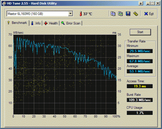

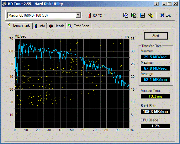

I believe theoretically I should be seeing 150Mb/second transfer and 9m/s Access Time
After setting acoustic performance to max:
HD Tune: Maxtor 6L160M0 Benchmark
Transfer Rate Minimum : 2.5 MB/sec
Transfer Rate Maximum : 3.2 MB/sec
Transfer Rate Average : 3.1 MB/sec
Access Time : 19.4 ms
Burst Rate : 3.1 MB/sec
CPU Usage : 50.2%

 Post subject: Re: Maxtor 6L160M0 TR=3Mb/s AT=20ms Passes all tests!
PostPosted: September 28th, 2013, 17:40
Posts: 17323
Your drive is behaving as if it is stuck in PIO mode. Windows XP will downgrade the interface from DMA mode to PIO mode if there are an excessive number of CRC errors.
There are some solutions and workarounds here:
http://winhlp.com/node/10
The following article explains how to edit your registry so that 6 consecutive CRC errors rather than 6 cumulative CRC errors are required to trigger a switch to PIO mode:
IDE ATA and ATAPI disks use PIO mode after multiple time-out or CRC errors occur:
http://support.microsoft.com/kb/817472
It involves adding a "ResetErrorCountersOnSuccess" entry.

Thanks so much for that response.
It's almost like as if it doesn't matter whether this is the right area to look at.... it just shows that there are problems like this. 8)
Note also, the PC in question is a Dell dimension 5100.
Node/10 talks about this being a dell problem.
BTW..... I've just loaded kubuntu, and there is always DOS.
Are there any progs available that can provide data rates outside of a windows environment?
Hopefully this is a PIO issue.
I'm on it.... so this weekend may see it solved :wink:
Thanks again :)

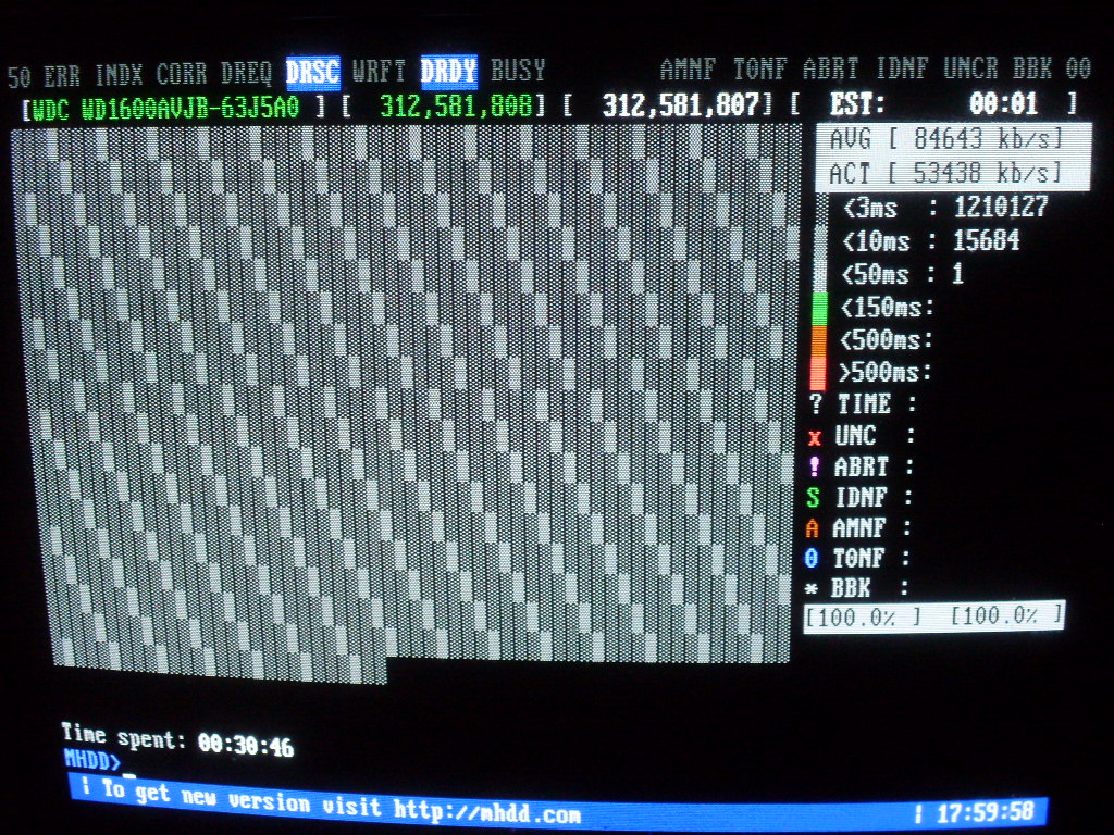

You could use MHDD to perform a full surface scan of your drive. It provides a full report which includes an average transfer rate figure. It should tell you if the drive has any "slow" sectors.

Here is the documentation:
http://real-world-systems.com/docs/MHDD_en_manual.html
Here is a screenshot from a recent thread:
download/file.php?id=7143&mode=view
The AVG (average) transfer rate in kilobytes per second is displayed at the top right corner of the screen.

I wonder what was happening with the 'tram line' display - perhaps relating to the disk manufacturing process?
What do the warnings mean?
(I was thinking of a prog I worked on for a while - 'the diskette workshop'.
At the time the thinking was that weak sectors could be strengthened by regular read/writes)
I note that the transfer rate of around 50Mb/s is around a third of the claimed specs, and access time is around double that of the specs.
Is this typical?
OR is the drive actually performing quite badly?
Either way, the speed is clearly better than 10 times the speed shown in windows, so it is increasingly looking like a PIO issue.
.... A bit of reading is required :wink:

The transfer rate of 150MB/s is the SATA link speed. It is reflected in the "burst rate", ie the transfer rate to and from the drive's cache RAM.
The drive's sustained transfer rate is much less, and reflects the data rate between the RAM and platters.
See this HD Tune read benchmark:
http://www.hdtune.com/results/Maxtor_6L160M0(2).gif
The transfer rate at the outermost zones is about twice the speed at the innermost zone because there are about twice as many bits per track.
Here is a slightly slower version of your model:
http://www.hdtune.com/results/Maxtor_6L160M0.gif
I suspect that the difference is in the number of heads, ie the faster drive may have 3 heads while the slower may have 4.
Another thing to examine would be the drive's SMART report. Look for reallocated, pending, or uncorrectable sectors. Also check the error rates, including read, write, and UDMA CRC errors. I realise that HD Sentinel reports 100% health, but a closer look at the raw values may be advisable.

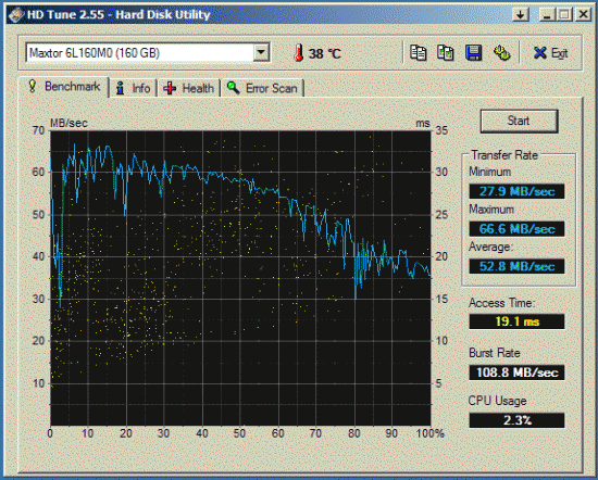

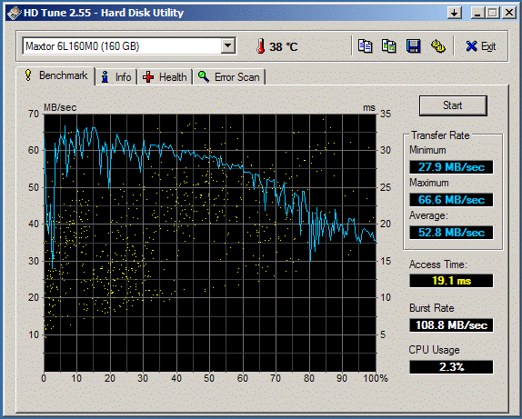

Have a look at my HD Tune graphs (post DMA reset dealt with in another post :) ):
Certainly not as neat as the the two you posted; and note the scatter-gun effect.
To be honest, I'm not sure what we can discern from that (analysis help needed).
They are clearly not well 'banded' as per the two 'benchmark' graphs previously posted.
The PC was inactive vis a vis running applications.
02 test was carried out directly after 01 in order to establish how consistent the tests are:

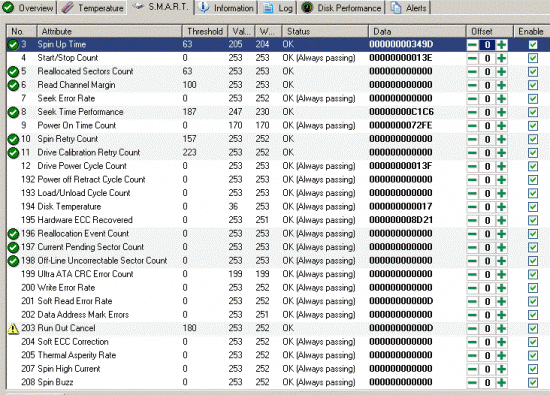

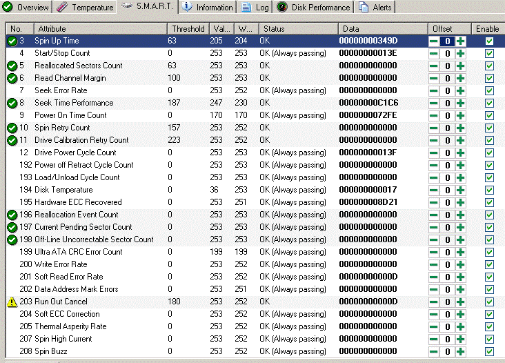

Here we can see the S.M.A.R.T. output:
Overall, the drive 'graphically' doesn't match the benchmark graphs, yet HD Sentinel is very happy with both performance and health (effectively 100% for both!!!).
I note your concern over this disparity, and am also 'a bit at a loss'.
The graph is merely a 'format representation' ideal for 'at a glance' human comprehension.... yet the actual results surely must be easily quantifiable for a 'percentage based assessment'.
Looking at my first post, it is clear that HD Sentinel has the spec for the drive (150Mb/s and 9ms).
Yet the results above do not, in any way, match the specs, neither in MHDD direct access, nor via WinXP O/S.
Even accepting your premise, that "the spec rate is based upon 'burst' ", the drive is still down by 30% (approx 100Mb/s vs 150Mb/s spec and double the access).
............. I do recognise commercial imperatives.
It may be that there is a wide tolerance applied to drive performance (just thinking aloud).....
... For HD S to give such a glowing bill of health (that flies in the face of the stats in front of us) makes me think that 'the drive is within acceptable performance tolerance'.
IE.
In engineering terms: is it a spindle @ 10mm -10 thou.... and a hole @ 10mm +10 thou.....resulting in 20 thou of slop, yet still within design tolerance?
Perhaps the SMART data can help.

Your SMART data look OK to me. In fact I compared them with the following sets which I found with a Google search:
http://www.ihdd.ru/forum/uploaded_image ... to01_1.jpg
http://www.elektroda.pl/rtvforum/topic1757692.html
https://www.ddo.com/forums/showthread.p ... ae89c67cc2
http://torufoorum.net/files.php?pid=17105&aid=2807
http://www.trainsim.com/vbts/showthread ... are-issues
http://www.progtown.com/topic364173-and ... grade.html
The 150MB/s transfer rate is equivalent to the 1.5Gbps spec for the SATA link rate. You seem to be having difficulty comprehending this figure.

As for you concerns regarding the scatter in the access time graph, it does look bothersome. I would normally be concerned, but I can't see any relationship between this scatter and your other results, so I can't suggest a reason for it. AIUI, the access time is given by the following relationship:
access time = seek time + rotational latency.
That is, the total access time is the time required to seek to the target track plus the time required for the target sector to pass under the head. In the case of a 7200RPM HDD, the latter time can vary from 0 to 8.33ms (8.33ms = one full revolution). Therefore, in the case of an ideal drive, one would expect to see a tight band of data points approximately 8ms wide.
AFAICS, if the drive were experiencing read problems, then one would expect to see an additional band of data points corresponding to read retries, and this band would be separated from the first band by 8ms, ie the time for an additional revolution. That said, I don't know what to make of your data, but it does appear to be suggesting that numerous retries are happening. The UDMA CRC Error Count is 0, so this would appear to eliminate the SATA cable as a potential culprit.

RE: The Access Time Graph
I am wondering whether the scattered band of results is an indicator of cause, or merely coincidence.
It is always interesting when an established member posts "I can't suggest a reason for it" and "I don't know what to make of your data".
Normally, such admissions would trigger an avalanche of 'suggestions' and 'reasoning'.
However, in this case, nobody else chimed in.
So is the drive running correctly?
I don't think so.
It doesn't sound right.
Back in IBM PC days we'd be listening for a perfect 'I am your automatic lover (automatic lover)' ringing out from the hard drive.
Nowadays, we're listening for somebody drumming their nails on a metal sheet, to tell us something is not quite right.
A severely fragmented hard disk.... not in this case.
Other than memory, I don't now have a reference (for the sound), as it is a PC from 2005; but it does seem to me that there is too much clicking.
We could just leave it at that - the PC has certainly become usable after the fix.
But still..... there's always going to be that nagging question, as to why the Access Time band (what band?) is all over the shop.
Does anybody have any ideas, before we put this one to bed in the 'unsolved' filing cabinet?
