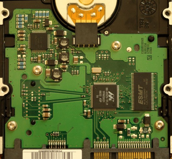

I have a problem with a Samsung HD400LJ. The drive does not spin up and I suspect the PCB after a power problem. Can I replace the PCB without firmware transfer? Does anyone have this in stock or know where I can get it? The PCB number is BF41-00107A.

Can you upload a detailed photo? Many times the problem is confined to the TVS diodes and fuses near the SATA power connector. Often the solution is an easy no-cost DIY.

Sounds promising, I have uploaded a photo of the PCB.
File comment: PCB Samsung HD400LJ

Go to the next step - use your Ohm meter :D

Both diodes looks fine, I think it would be the Marvell chip or motor controller IC or something else.
Anyway I hope it's just a TVS problem.

Are we talking about the 2 diodes bottom right? Normally I get a quick blip on the meter whatever way I put it on, but these two are different. Putting a tester on these, the left had one is showing a short both ways and the right hand one seems open. Maybe this is the problem. But I am not sure what results to expect testing this in situ with a diode test on a multimeter.

remove the one shorted

Felt like I was choosing between the red and the blue pill for a moment, but I chopped it out of circuit and the drive just powered up with all my data. Thanks for your help. What a big saving of money!

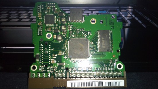

Hi
Can someone hell me ? The problem is mostly the same ( it doesn't start) and i think it was because a bad plug off.
I already tried another board and it worked Samsung HD300LD but i cant keep the good board so...

Posts: 17386
Measure the resistances of the labelled components on the 200 ohms range of a digital multimeter:
http://www.users.on.net/~fzabkar/HDD/HD ... switch.jpg

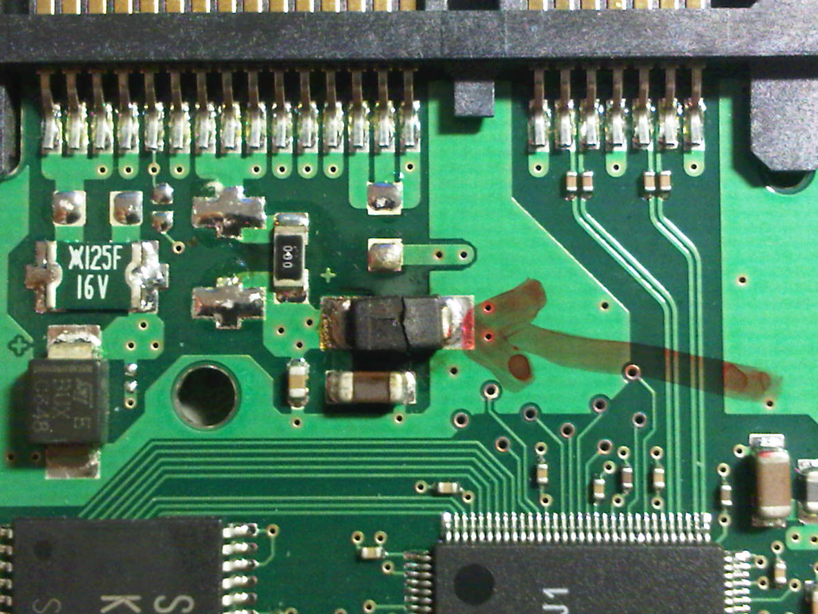

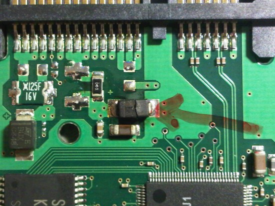

Hello, I was searching the internet for my particular issue and found this item about the Samsung hd400lj pcb bf41-00107a, I have the same pcb and my problem is that the larger black smd near the satapower connector is zapped/smoked, it looks like it has a number on it of 722, I am thinking this is a resistor but not sure. I have swapped pcbs to prove this is a defective one. There may be other issues, I just know this is smoked, you can see the crack on it. Any help would be appreciated or if someone knows where I can find a SD, that would work as well.
If you are referring to the 12V TVS diode, just snip it out with side cutters. This will remove the overvoltage protection from the +12V supply, so be absolutely certain your PSU is good.
BTW, the "722" marking appears to be a YWW (Year / Week) date code, ie week 22 of 2007.

Fzabkar, I am posting/attaching picture with arrow pointing to smd that has failed, is this what you are referring to?

Posts: 17386
That's the 5V TVS diode. Remove it and check that the 000 resistor measures 0 ohms. If it is open, bridge it with a wire link or a blob of solder. You could use the vacant spot to the left of it (with the "+" shaped pads) to solder your wire.
You may want to first check that there is no additional shorted component on the +5V supply by measuring the resistance between the diode's pads on the PCB after the diode is removed.
