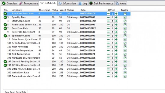

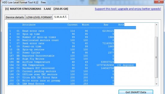

Help guys, i've :
maxtor diamond max 21 STM 3250820AS
s/n : 6qe1s03d
p/n : 9dp13e-326
firmware : 3.aae
date code : 07527
site code : SU
some time it doesn't recognize in bios, and some time does, can anyone tell me how to fix this, and oh this hdd has been short circuit before and i have RMA to the store and i don't know if they replace it with an new or just replace the short circuit pcb.

 Post subject: Re: maxtor diamond max 21 sometimes doesn't recognize in bio
PostPosted: October 9th, 2011, 9:25
Joined: October 8th, 2011, 22:03
Location: unknown
@Vulcan, thanks, here the SMART raw that you needed , i hope this can give you more information,
File comment: using harddisk sentinel
PostPosted: October 9th, 2011, 14:04
Joined: May 6th, 2008, 22:53
Posts: 2138
Thanks for that information.
As I said before, the SMART info might give some useful evidence. In this case, there is no obvious sign of internal disk problems - but that does not prove that everything is OK with the disk, as some disk problems will not (cannot) update the SMART data on the platters.
One area of slight interest in that SMART data, is the count of interface CRC errors - attribute 199. For SATA disks that is the CRC error counter for SATA frames received by the drive. I'm not going to give a full tutorial about why this doesn't give "the whole story", but this might be indicating a problem in the area of the SATA interface (motherboard, cables, disk drive). However, you said that the disk drive behaves normally when it is recognised, and if there was a SATA interface problem, I would expect that problem to occur during runtime as well.
You could try using a different motherboard SATA port and SATA data cable, to see if that makes any difference to how often the disk is not recognised by the BIOS - but I am not expecting a change in behaviour, based on your information supplied so far; this test would just be for elimination purposes.
So in summary, I see this SMART data as inconclusive - SMART data can never prove that the disk is OK; and it does not always evidence of every fault, even when a fault exists. Sometimes we are lucky that this data does obviously indicate a problem, but not this time IMHO.
If this was my disk, and if I had lots of time to spend on a 250GB disk (which I don't!), I would investigate areas including whether the SATA CRC incremented after each time that the disk is not visible in the BIOS; check the answers to the questions which I asked earlier, about the exact disk behaviour & noises, when it is not recognised in the BIOS, as this may give evidence of problems with the disk initialising; use the disk's terminal output to see what is reported by the disk when it is not recognised by the BIOS etc. etc. However, with the language limitations here, and the fact that the data on the disk is unimportant, this level of troubleshooting would not be worthwhile IMHO.
The only part that I can see where you might be able to fix a problem yourself, would be if the problem is outside the drive, with the SATA interface (motherboard or cable). A drive PCB fault causing this symptom is very unlikely IMHO, and there is nothing else you could fix with the disk drive yourself.
Sorry I don't have good news for you. Someone else might have a different opinion. Good luck, whatever you decide :)
