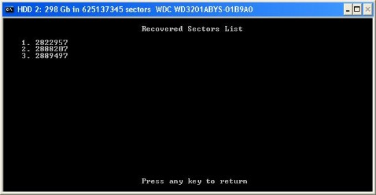

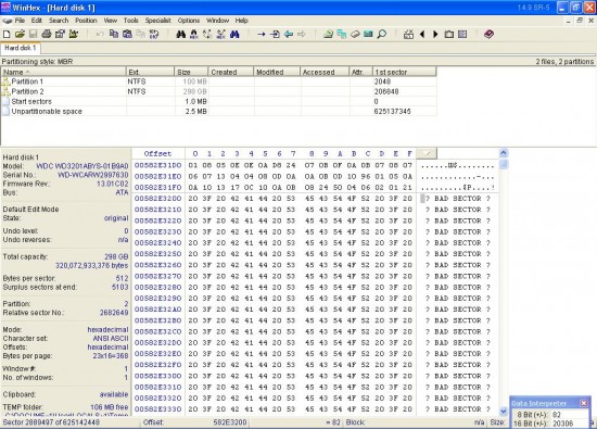

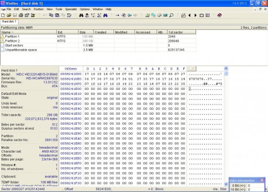

I decided to verify the claims that I knew were not possible. For testing is used hdd with 84 working days in good shape but not used for about 1,5 year because of a PCB problem. After successful fixing the problem and starting it I found that there are three UNC sectors.
Then I decided to do "Corrupted data recovery (making unreadable data readable)”.

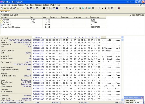

There are interesting, albeit expected, results of "salvaging" the data:
None of the three "rescued" sectors unrelated to the previous or next in the series and it is clear that what is "rescued" is not really what is lost and what is lost is "trully" lost. It is unclear then why the author states what he states and charge for it $99.99.
However, I am particularly interested from where the hdd picked up a sector content to fill "recovered/restored" sector 2.889.497 ?
As you can see, it is the first sector of the hdds own module 6F which is normally located in SA. (Hdd was never used for hdd FW storage so no FW files in UA)

This is a crucial point on which I focused in this testing!
That's why I chose the hdd where the data is recorded long time ago, non powered for 1.5 years so I assumed that there are sectors who are bad magnetically but good physically.
After this tests, I conclude that the HDD Regenerator is just trying to read unreadable sector several (or several dozen or hundreds) of time and at the end:
- writes back successfully read sector
- reallocate physically unusable sector (hdds own function)
- writes crap data when unable to successfully read physically good sector
In the third case there is NO WARNING that data is FOREVER lost!
Instead, the software prints a clearly visible large green letters message REGENERATED.

All of this still doesn't answer the mystery of how the contents of a firmware module ended up in a user sector. Could there be a bug in the drive's own error handling? Are you sure that the same sector doesn't exist elsewhere on your drive? Did you actually scan your drive for this sector? Are you certain that the 6F data are from the drive's own SA (where else could they come from)?
Edit: Just to be certain, you began by referring to a WD5000AAKS model, but your WinHex screenshots show a WD3201ABYS drive. :?
 Post subject: Re: "Recovering and restoring" with HDD Regenerator
PostPosted: June 6th, 2014, 4:49
Joined: July 18th, 2011, 5:40
Posts: 95
Location: Serbia
@fzabkar
I scanned the entire available UA surface and no such a data. The "recovered" sector and drives FW 6F moduls first sector have same 512 bytes data. They match.
The test is performed on WD3201ABYS. WD5000AAKS mentioned in the first sentence of post has nothing to do with the drive that has been tested.
And yes, the question how the contents of a firmware module ended up in a user sector is still open.
