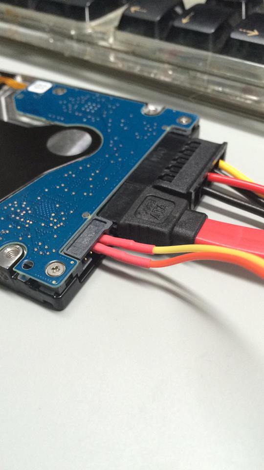

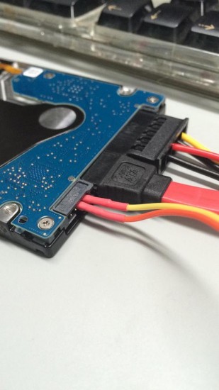

I have connected a TTL adapter to the drive as described on this page http://atola.com/products/insight/manua ... ction.html The drive does not display any information over the serial port.
The site does not list a Ground connection, I am assuming they are using the ground in the USB to SATA bridge. For S&G I have attached a ground to the case of the drive as I do not want to land a ground to a +5 and let some of the magic smoke out of something. I still get no data in the terminal with the ground connected.
If any one can reflash this board please let me know and msg me with a price..
Sam

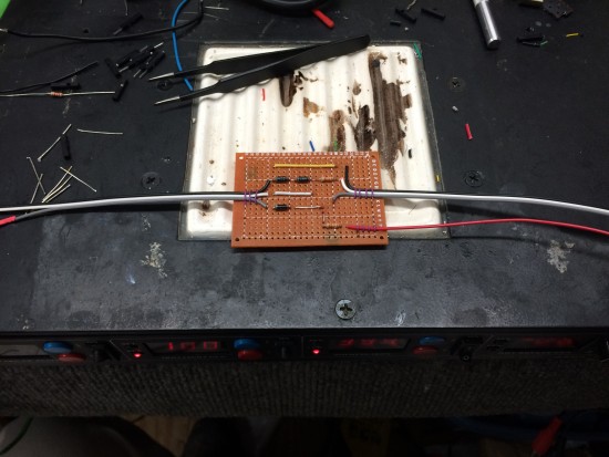

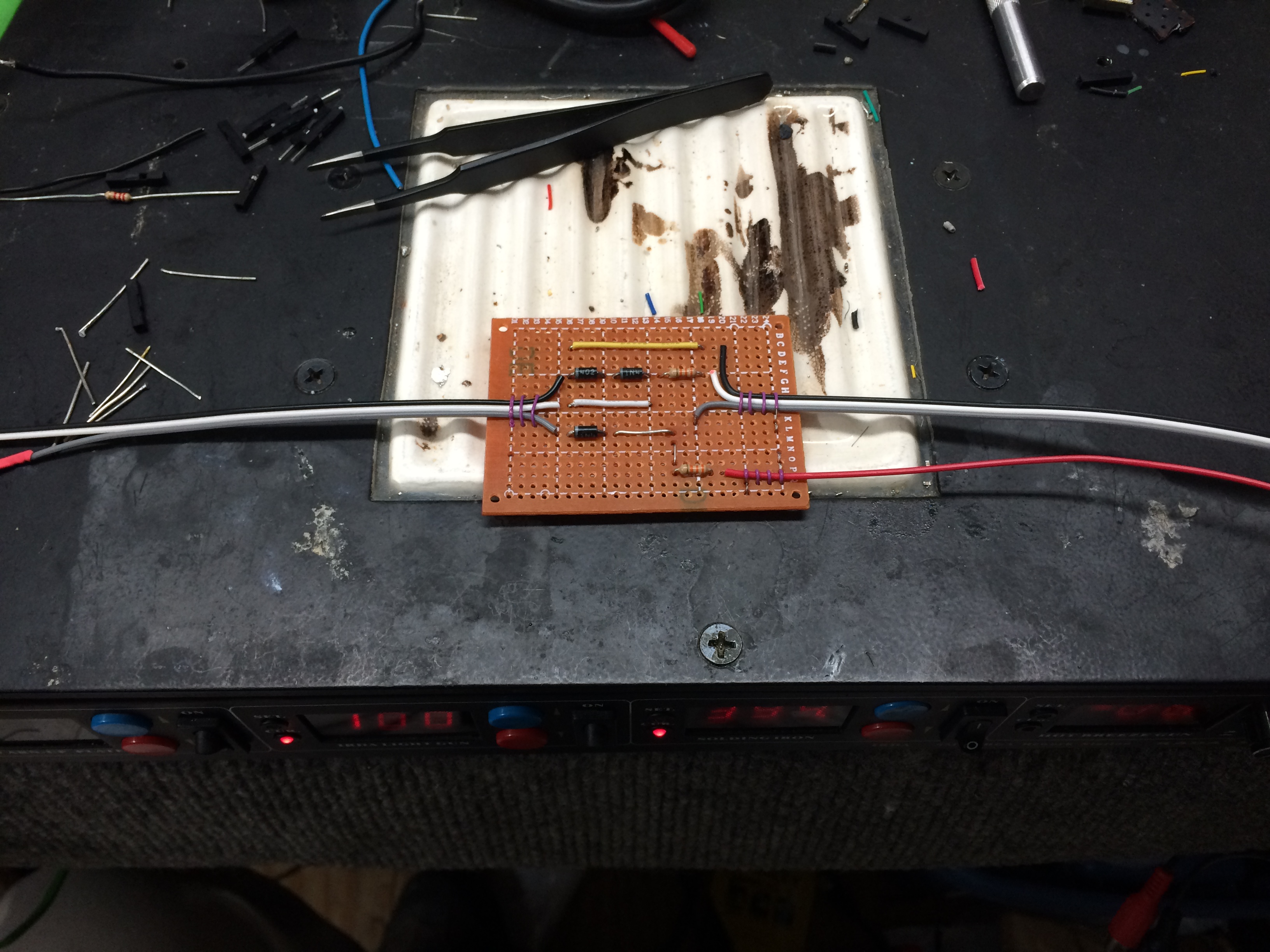

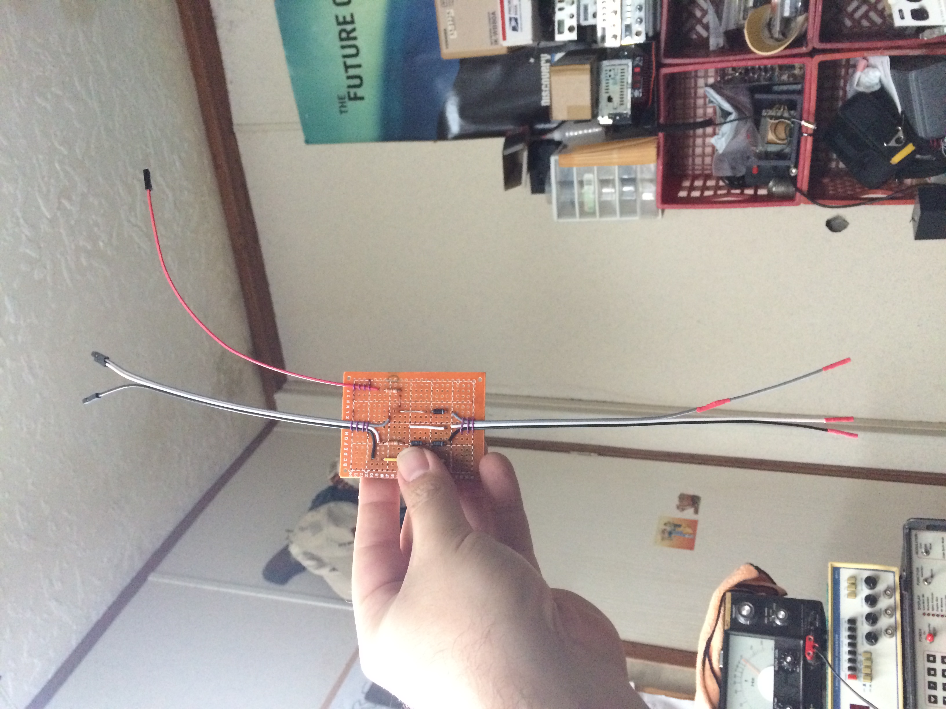

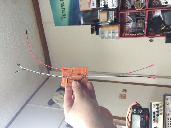

I am working on building a bi-directional TTL converter, I just got a call with a customer that has a network outage. I am going to trouble shoot their problem and jump back on building the TTL converter..
I normaly put my SETI@home Signature here, but HDDguru only gave me 30px.
So if you want to see my stats click http://goo.gl/5R64s1
 Post subject: Re: Seagate st2000lm007 board issue!
PostPosted: December 26th, 2016, 21:24
Joined: December 26th, 2016, 13:11
Posts: 12
Location: Louisiana, USA
Ok, made a bi-directional 3.3v to 1.8v and it still does not like it. I am ordering a 1.8v ttl now.
Sam
