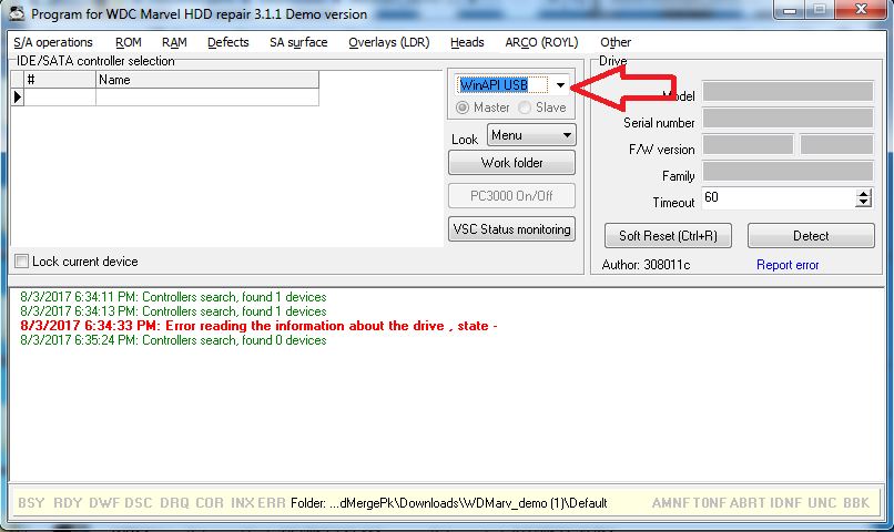

Alright, i'm finally back...
The new donor drive came in and the serial and other manufacturer numbers were very close to the original drive. I purchased a cheap plastic/nylon head tool and I swapped it over. The drive spins up and I can hear the heads moving. This time around, the drive actually shows up in the WD Drive Utilities AND under Windows Disk Management, however, the drive is reading as a RAW drive now....it doesn't show any drive capacity.
Also, when I go to Disk Management, it prompts me to initialize the usb hard drive. None of this happened during the last head swap. What would you suggest I do from here? I would initialize and then try some kind of data recovery software, but since you guys are way more experienced I'll wait to hear from you.
Thanks for taking the time to assist me.

Just out of curiosity, I downloaded and ran iCare Recovery Pro and ran the scan for Lost Partition Recovery and it ran in 2 seconds and had nothing to report back. Don't know if that software is any good, but wanted you guys to know this info. Hopefully it doesn't mean much and you all have a better option to try.

MindMergepk wrote:
there are further things to be addressed after swapping heads, patching FW, adapting a Sata PCB, deal with encryption etc. The best is to keep the drive safe and make a budget for it, there are cheap options available if you are willing to send drive out of US.
glad you made this far.
if drive is spinning fine with absolutely no abnormal sound, you should search slow fix here and apply it, keep in mind the best is to clone the drive sector by sector to another drive to safe extract data, the drive may hang if you continue to copy data through normal means.
good luck

MindMergepk wrote:
good luck
Thanks for the reply! I do have another 1TB external drive I can clone to :).
I searched for the "slow fix" and one of the recommendations was to try WDMarvel (I don't have linux so I couldn't try hddsupertool). Started up the WDMarvel tool and only my internal SATA drives show up in the list. It claims it supports USB drives...
I'm assuming I need a USB --> SATA adapter or something like that?

I think it does support USB drives, BTW i can help you remotely if you want.
