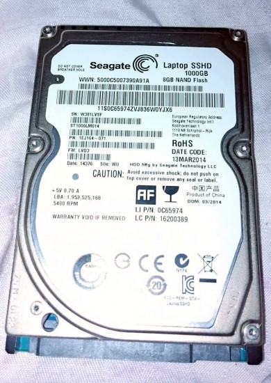

Switch to mobile style
 Post subject: Seagate ST1000LM password
PostPosted: August 1st, 2017, 7:46
Joined: April 25th, 2017, 3:00
Posts: 6
Location: Romania
Hi, I have this Seagate 1TB drive that is ATA locked. I`ve put it on terminal, I have access to the commands but searching on the internet, didn`t find anything clear about how to. I`ve tried ZOC script and got nothing, tried formatting the user partition with m0,D,3,,,,,22, also m0,2,1,,,,,22, they both completed succesfully, also cleared smart, still locked after these. Any idea? Thank you!
19578807_1544589672258359_1258224231_o.jpg [ 634.56 KiB | Viewed 5911 times ]
 Post subject: Re: Seagate ST1000LM password
PostPosted: August 1st, 2017, 13:00
I hope you're not expecting to recover any data from this. Trying all those things blindly is a great way to botch it up for good. ATA lock has nothing to do with the things you're trying.
 Post subject: Re: Seagate ST1000LM password
PostPosted: August 1st, 2017, 14:09
Posts: 791
Send it to quartz data recovery in Bucharest
https://www.mjm.co.uk/
 Post subject: Re: Seagate ST1000LM password
PostPosted: August 2nd, 2017, 2:21
Joined: April 25th, 2017, 3:00
Posts: 6
Location: Romania
Hi, the data has no value, I got the drive fairly cheap, just to use it as a backup. I managed to get the password by reading 30A sys file via terminal.
Users browsing this forum: No registered users and 327 guests
