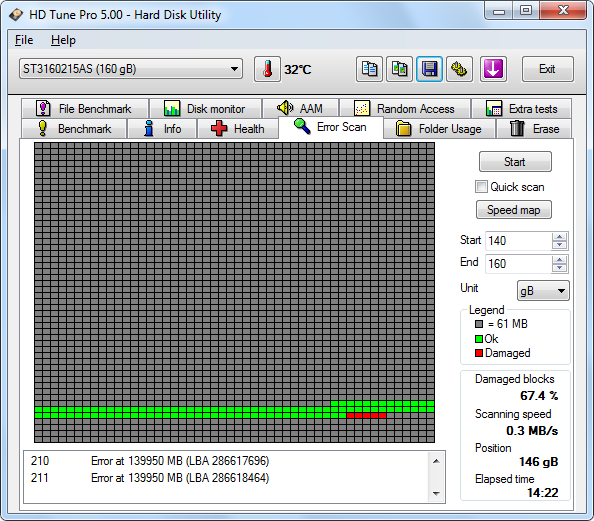

yes. drive come back with F,,11 command.
and i actually don't know name of F,,11 command. looks like clear smart . maybe clear smart is N1 on these drive..
drive has many bads on last part.. you can see ..
is anyone know what do F,,11 command?

The hard disk was clicking some at boot before I tried.
only R1 and R2 command was useless but F,,11.
all data succesfully recovered. also.. drive is good. there are many bads after 145 gb. but it's not important.
even if your drive is fully healthy you must not exceed %80.
i have read this.
