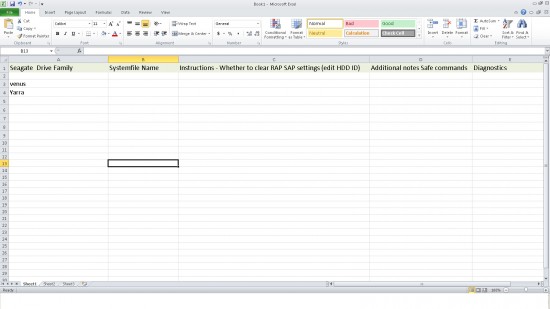

I was having similar case , I erased NRG list , Alt list and erase smart. But original symptoms aggreavated and even restoring backup did not improve situation.
I think erasing NRG list and ALT list is equally dangerous .
If someone give details of crucial system files for each family ,that will be of immense help as Ace manuals are not updated and are not having information of individual sysfiles.
Something like this --
Seagate Sysfiles.xlsx [9.71 KiB]
Downloaded 448 times
