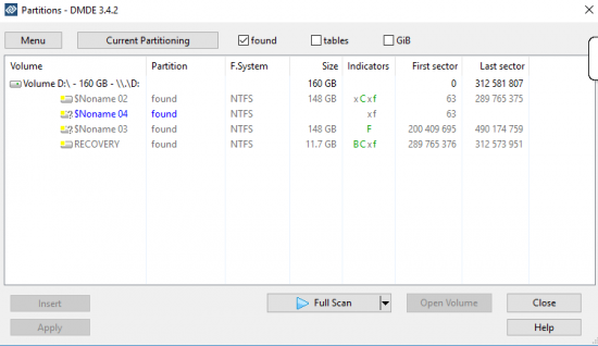

Could you start by showing us DMDE's Partitions window?

Whoops, here's that screenshot as requested.

It looks like you have cloned your source drive to a partition on the target???
Normally you would clone a physical drive to another physical drive, or to an image file.
Also, I don't understand how $NoName03 can extend beyond the last sector of the physical drive. In any case $NoName02 appears to be the most likely candidate, although the Indicators are telling us that its Boot sector and MFT are missing.

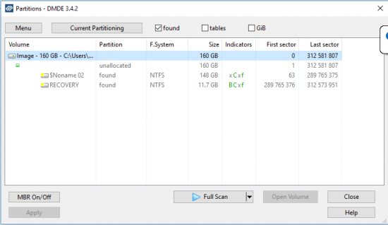

Now what do you see in the Partitions window?

This is what I see now.

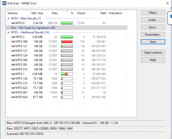

I would perform a Full Scan of $NoName02, with the NTFS and Raw checkboxes ticked. Hopefully there will be no MFT offsets this time.
BTW, how was the file system damaged/corrupted?
 Post subject: Re: NTFS Raw Drive Error- Recovery with Clone
PostPosted: September 19th, 2018, 22:04
Joined: September 10th, 2018, 21:35
Posts: 8
The results from the scan are in a picture below. I also saved a copy of the log for future reference. I'm not liking how much red I'm seeing.
TBH, I'm not quite positive on how it was corrupted. This is a friend's laptop. They told me that the battery died, so they had ordered a new battery from HP. I'm not sure if it happened right after, or what the specific time table was, but they couldn't get windows to boot. I've plugged the drive into multiple Linux, Windows and MacOS machines and none of them saw any data. They all showed the drive as unformatted/raw. I'm hoping that at the minimum, I can save some of their wedding photos that are on the drive. I've made a few successes pulling off some data, but a lot of what I have been able to pull of is corrupted. I'll attach a copy of one of the files that is corrupted. The thumbnail appears fine, but the image is not.

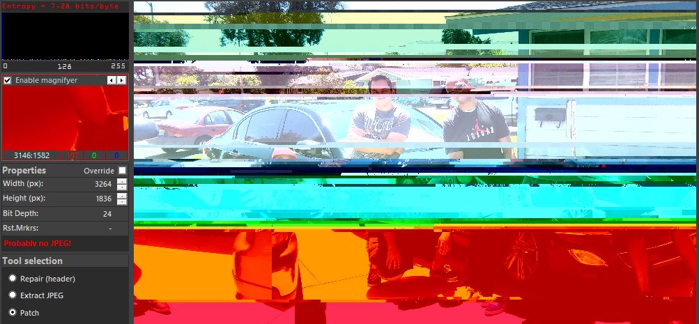

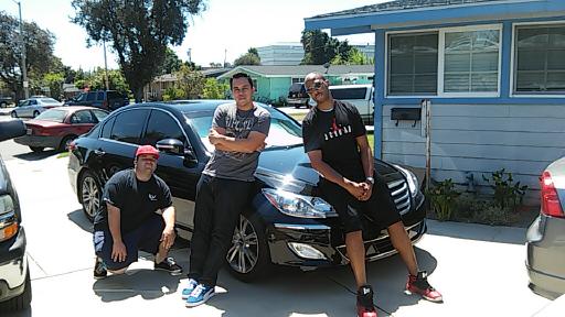

I know it's an old thread. Just for future reference. I got a JPEG fetish so I had to look into it. Issue with that file is not that it's not complete. It's just corrupt as heck. After removing corrupt data that prevent file from decoding you can actually see the data is there.
