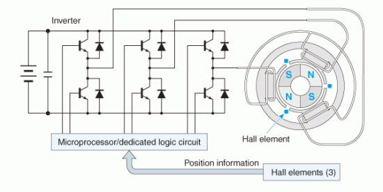

@JMCortinax, can you hear any faint sounds when you press your ear against the drive? If so, then you may have a stiction fault.
Are the motor windings of equal resistance, approximatley 1 ohm?
 Post subject: Re: Seagate Barracuda ST2000DM001 Recovery
PostPosted: October 13th, 2018, 6:14
Posts: 474
Location: spain
+1
Between any two pins of the motor it has to give the same resistance of just 1-5 ohms (the reading will vary depending on the motor and the calibration of the multimeter) ..
There is no sound at all being made.
mhp666 wrote:
+1
After checking first with my spare WD HDD you were right and I was getting readings between 1-2 ohms from each of the motor wires? running under the HDD.
When trying this with the Seagate I was getting no readings at all.
If it helps, the dock I use has a white light that stays on when the WD has spun up. When plugging the Seagatte into the dock, the light just keeps flashing as if it's not recognised.
