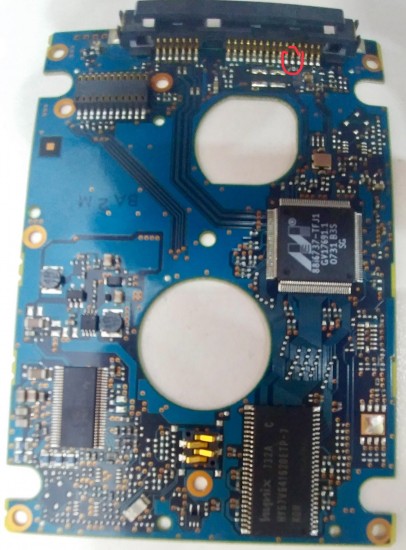

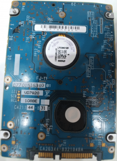

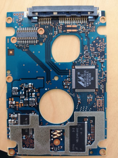

Hello
I have a Fujitsu drive that need to replace the PCB (Model: MHY2160BH, PN: PN: CA06889-B377000T)
The PCB doesn't contain an external ROM chip.
I found a PCB with same PCB REF (CA26344-B32104BA), same HDD model and same hdd PN.
- PC3000 support told me that its not enough and other numbers on white square on PCB need to match too (see patient PCB)
- DonorDrives told me that it should work (See donor drive)
Can anyone tell me please what are the criteria for Fujitsu PCB replacement to work?

 Post subject: Re: Fujitsu PCB compatibility criteria
PostPosted: April 10th, 2019, 5:59
Posts: 17232
Did you check the fuse?

Posts: 849
You can use any PCB for the same model unless it has an external flash chip.

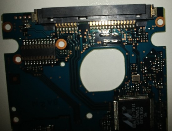

PostPosted: April 10th, 2019, 14:14
Joined: May 21st, 2007, 16:10
Posts: 1592
Location: Gothenburg/ Sweden
For new Pub, match 44 and 31

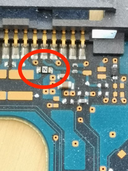

It’s a poor photo, and I’m not at work to check a PCB.
That coupled with fat fingers on an iPad to edit the photo doesn’t make for an accurate edit of the photo, but I think this is the fuse (or a zero ohm resistor). Black component with a white “O” on it.
Check it for continuity....

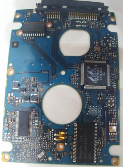

Posts: 197
I re-checked that part of the PCB, it looks good.

Did you measure that part? not just looked at it?
