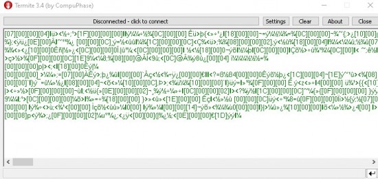

I have used my USB 2.0 a TTL tool. I tested it using a terminal program (Termite 3.34) and connecting Rx and Tx pins using a wire. The tool tested ok.
Then I connect the Rx pin of the tool with the Tx pin of the HDD. And Tx pin of the tool with Rx pin of the HDD. The HDD was powered on using a SATA conection from a PC Power Supply.
Since the conection was started, binary characters starts to appears in the terminal windows of Termite program and don't stop to appear until I close the conection.
What am I doing bad??

Wrong baud rate? Missing ground wire?

Thank you for your reponse! I have just tested with differents baud rate (from very low to very high). No change. The binary characters start to appear when I conect the SATA power cable from POwer Source to HDD (before I power on the Power Source - jumping PS-ON pin to gound).
I have tested conecting GND wire beetween the TTL tool and HDD. No change. The binary character continue appearing.

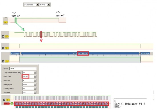

Simple method to calculate baud-rate on unknown UART:
1. Connect TX to any logic analyzer
2. Set big buffer and big sampling rate in LA
3. Turn on the drive
4. Short terminal transfer appears on disks' TX (green frame)
5. Magnify this transfer and select any fragment with dense transfer - it's one bit (red frame)
6. Magnify this one bit further and measure time - you have your baud-rate
7. Set up UART with this baud-rate in logic analyzer on received transfer, in my example you can see decoded text "Serial Debugger V.1.0 ENG>"
8. Or you can just connect to disk with standard COM terminal, using calculated baud-rate
