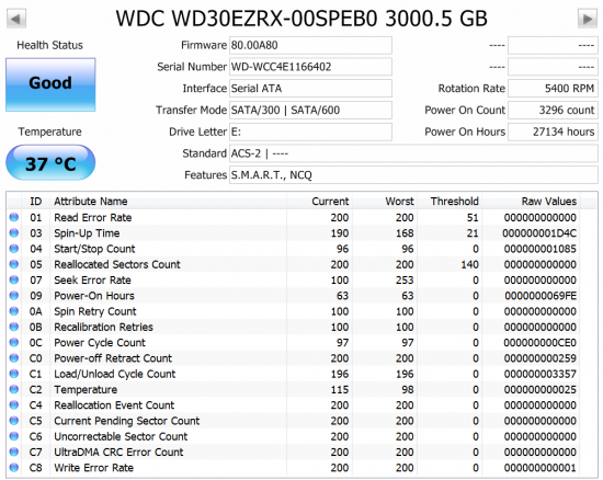

As the title says i somehow had a corrupt MFT file and all the error messages said use chkdsk which i did (foolishly), now the MFT is fixed, but erased, so the disk is accessible but all the data is gone.
I cloned the drive with ddrescue to another drive and got some of the data with recuva
What else can i do? recuva did find $MFT files one is 2GB but it's probably a fragment.
testdisk says mft and mft mirror are now the same so no issues, 256 kb :(
Running DMDE now which seems to have found a lot of the original MFT structure magically.
As for the drive details:
WDC WD30EZRX-00SPEB0 3TB
