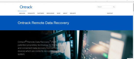

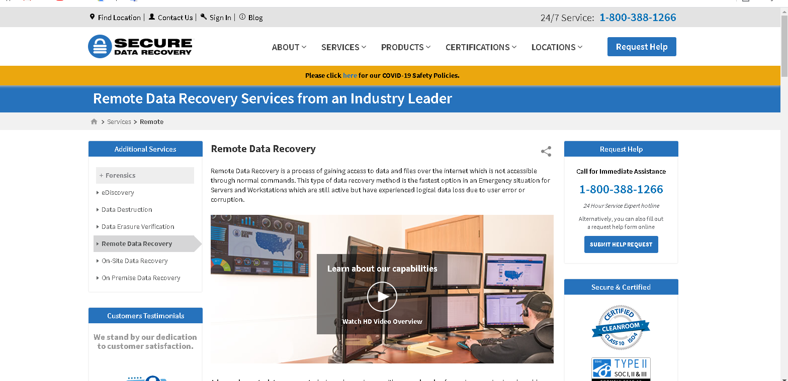

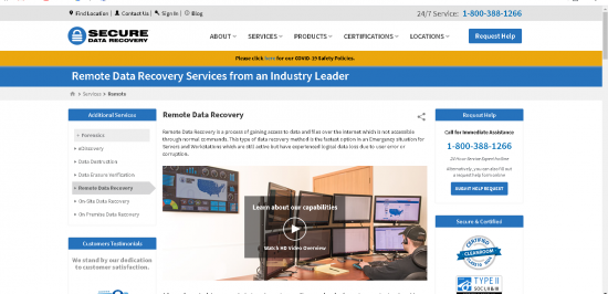

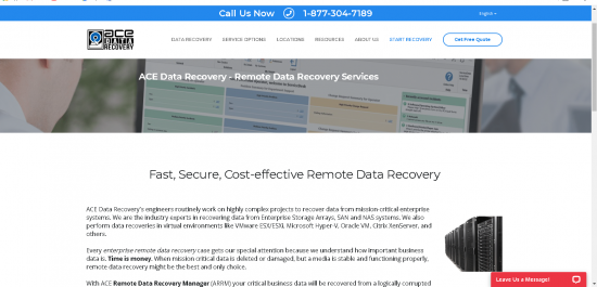

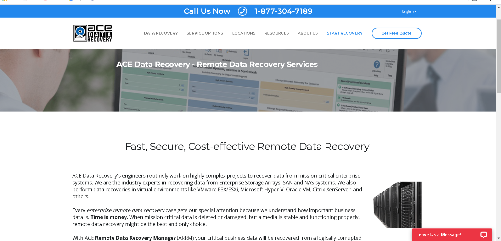

Ontrack is offering remote recovery besdies ace in all over usa.

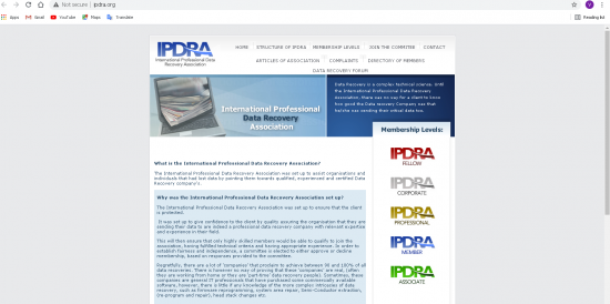

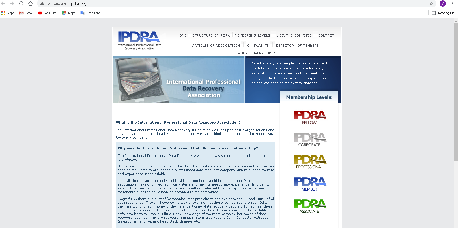

Hi Lardman
Actually I have nothing to do with GDPR as I don't operate in europe . I was keen to know whether there is any standards in Data Recovery services .
A framework which is authorised by international agency or any respected national agency like NIST etc.
for example while giving data sanitization service we often refer to standards like DoD 5220.22 -M etc.
some times corporate customers ask about details of the process done ,we can claim we adhere is so and so standards.
Sometime back there was some organization who used to certify data recovery business based on there skills ,infrastructure and other criteria.
I was looking for a such kind of thing.

I am not aware of any professional regulatory body or association, but some of the larger training organisation do offer accreditation to their standards.
I'm not sure recovery could even be covered like that, some of the unconventional things we do to get data from a drive :D Over here parts are covered by legislation such as the data protection act / GDPR and there are other frameworks such as ISO 9002 and Cyberessentials which more corporate clients may want the flags waved about.
If you're working with a more forensics bias it probably best to discuss any legal requirements with the client or a solicitor as they're probably going to be regional/nation.

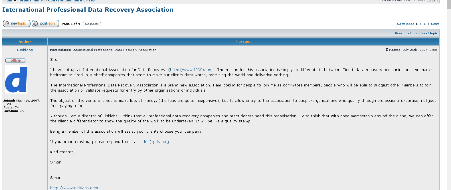

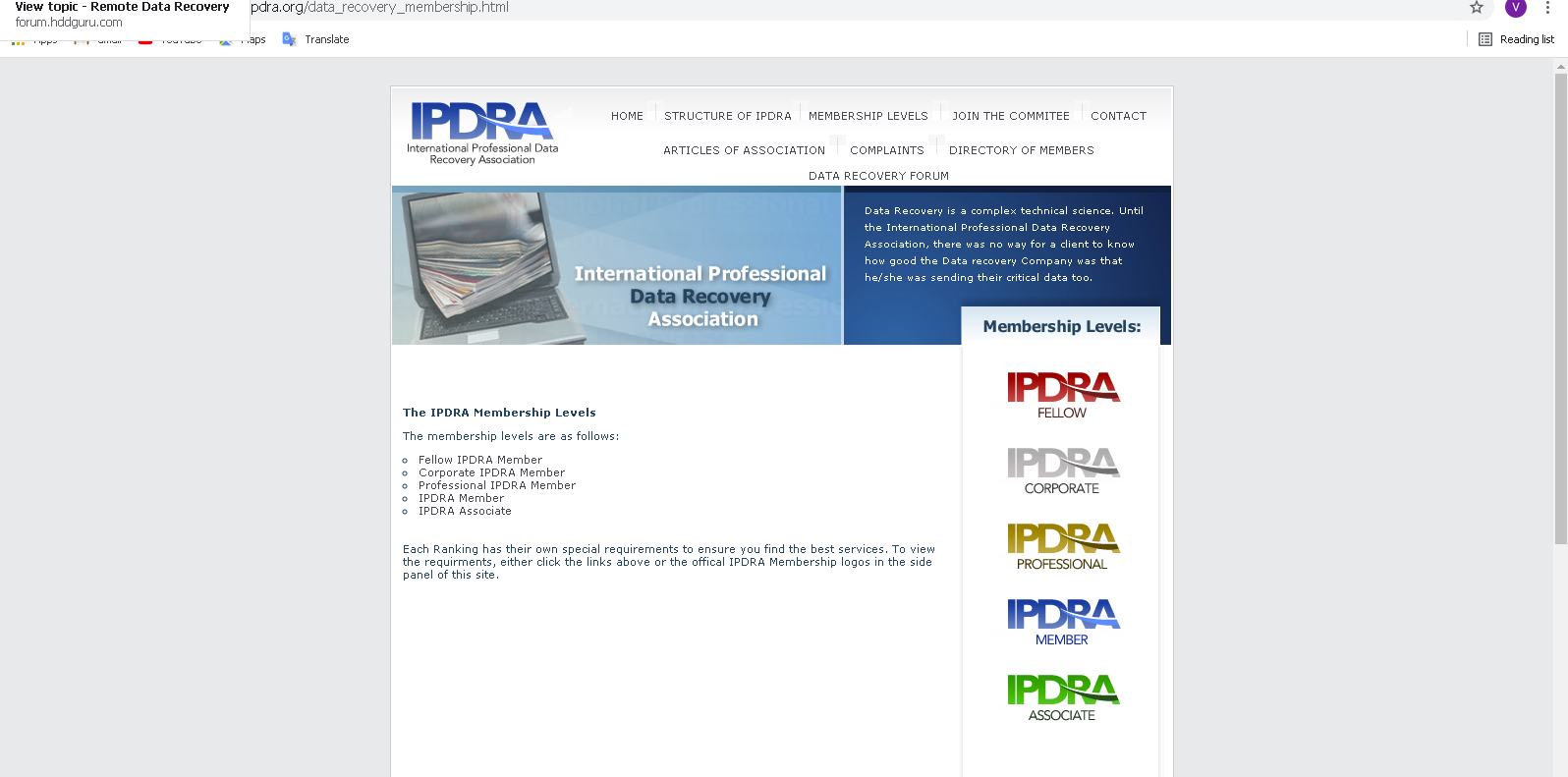

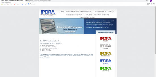

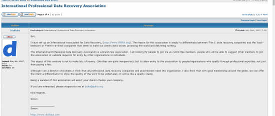

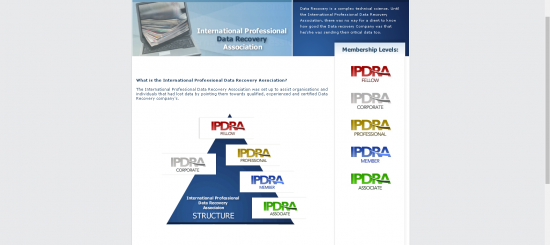

This association was present long back , in fact Data Recovery association related thread is also present in our forum .
But this seems not working now.
Thanks all of you for expressing your views.

You may also find reference to "Global data recovery alliance" I know at least 1 UK based site claims to be a founding member. They're to my knowledge just membership schemes.
