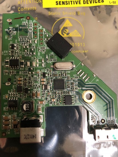

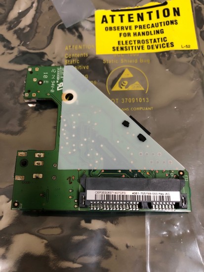

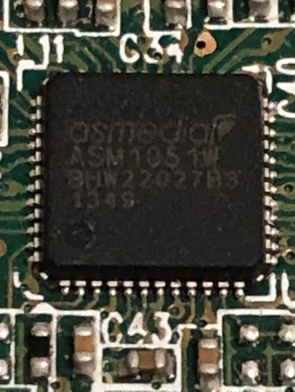

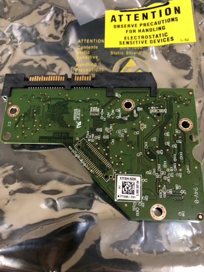

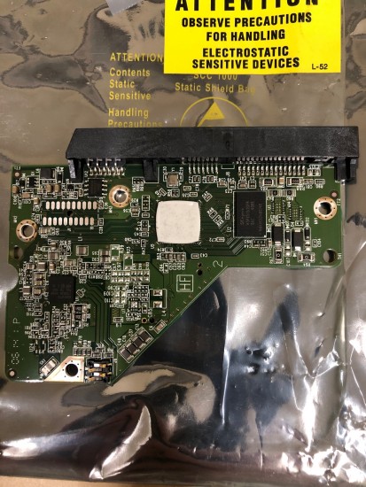

ejlion wrote:
and just gives repeated three "gentle" clicks.
This suggests that you are most probably guessing right: The heads are dead. There is a tiny little chance there is some issue with the firmware, but I doubt it. But in any case there is nothing more you can do anyway.
If data contained in this drive is important, my best advice would be to give up DIY attempts now and send your drive to a pro.
Where on the East Coast are you located?
I suggest you get in touch with Jon at Datasavers (https://www.datasaversllc.com).
I believe they have a flat rate which is far away from "several thousands". They're located in Atlanta.
