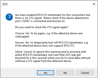

Hi, So I tried to connect with ZOC by using the configuration I found on this forum with the attached file except using COM3 instead of the \\.\COM1 listed obviously because I'm connected on COM3. When I go to connect, I get the message that I've attached as a screenshot and selected No. It then proceeds to connect. I then selected Script and selected the first ST_congen script you directed me to use earlier, and when it runs the script it populates a message with Y/N and N is already entered for each step. I kept entering through N until it finished but I am assuming it didn't do anything to the drive. Please advise what I should be doing as in should I be changing it to Y for each step? I do not want to do something wrong again and while I won't be upset if I can't recover the drive, I would like to accomplish its' recovery myself. I am obviously not a HDD recovery expert and am relying on your guidance. Please pretend I know absolutely nothing when you are guiding me. I know enough to be dangerous which is what I'm afraid of. I await your reply.

Answer Yes to each prompt except for the Media Cache parameter. I could be wrong, but I don't think Media Cache applies to this model.
