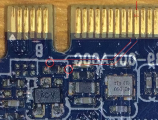

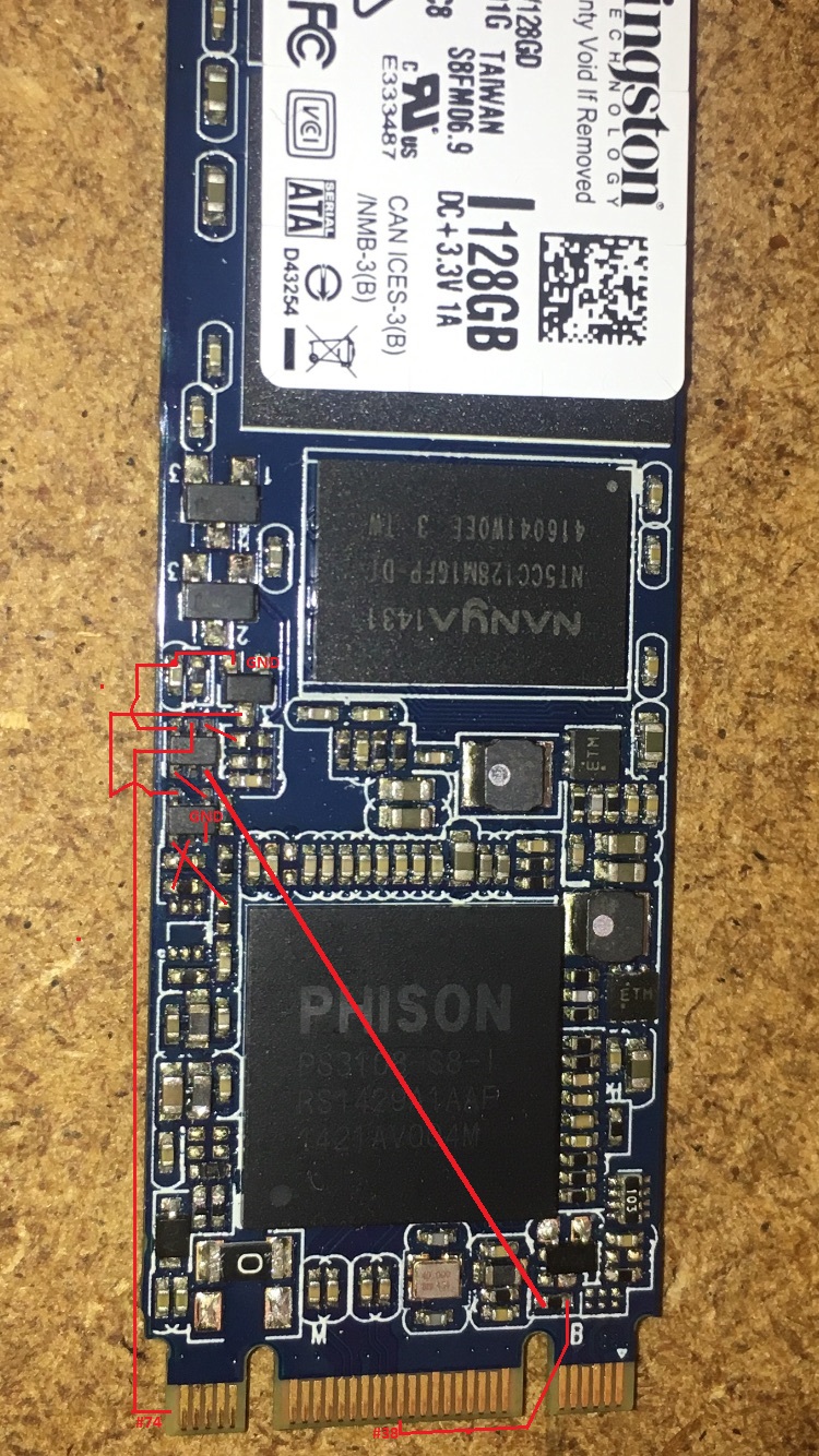

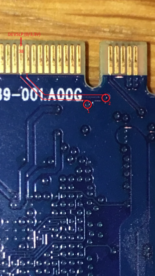

I had a look on the back side and followed the circuit.
Pin 38 looks goes according to the picture. I made an overlay of front and back to see where it goes and it seems to match.
One thing that doesnt make sense is that I cant measure any contact between those two points. Guess its many layers in the PCB.
Edit: Forgot to mention that the solder point on the front side where it looks to be connected is at 3.3V.

Adisa wrote:One thing that doesnt make sense is that I cant measure any contact between those two points. Guess its many layers in the PCB.
No, you are having a brain fart. :-)
The photo of the underside counts from pin #2 whereas the component side counts from pin #75, ie you are comparing opposite ends of the PCB.

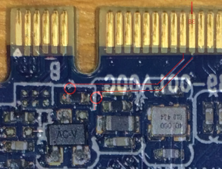

Oh, yes, you are right..Sorry :)
This should be correct. And this time I have connection between pin 38 and the component.
The thing is that it looks to be 3V. Should I try grounding it?

Can you check whether there is any continuity between pin #38 and the T3 MOSFET switches?
Grounding pin #38 would seem like the thing to do, but I would like to know more about your dock/adapter. In particular, why would the dock be putting the SSD to sleep?

#38 -> Pin 1 = 58,8 kohm
#38 -> Pin 2 = 34,4 kohm
#38 -> Pin 3 = 11,6 kohm
This is a M.2 -> USB dock. I will get USB->SATA tomorrow to see if there is any difference.
I doubt that the 3V at pin #38 is comming from the adapter. I isolated the pin from the adapter, but it was still 3V.
When grounding pin #38, the adapter shut down.

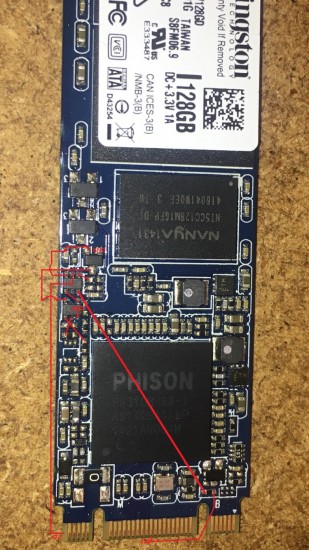

Im starting to give up on this.
Been trying to understand this but cant get it to work.

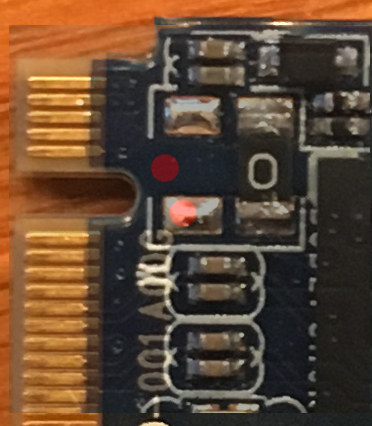

I've tried to short pin 38, but there is no difference.
Here is a picture of how some things are connected.. dont know if its for some help.
Re: Dead Kingston M.2
January 27th, 2018, 15:56
I think we are very close to a solution.
Pin #38 would be directly connected to power pin P3 (+3.3V) of your SATA cable. If you short this pin to ground, without doing anything else, then you will be shorting your SATA power source. Instead I would flow a blob of solder between pins 2 & 3 of C35.
I'll post a diagram of this area of the circuit shortly.
