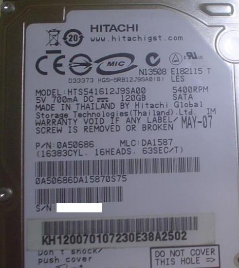

Hi to all!
hd binds and turns the engine but it does not read nor model and nor fw...
DRSC DRDY ABR
Label in photo!
Thanks advance!

Well, at least check the modules for starters.
Re: HITACHI 120 GB
October 17th, 2008, 11:55
check firmware. if firmware cannot be accessed, check nv ram, if nv ram ok, check pre amp.
Re: HITACHI 120 GB
October 17th, 2008, 12:25
Very common for head failure. Even when no clicking, heads can still be at fault. Can you access SA at all? Does table of modules show accesibility?
Re: HITACHI 120 GB
October 17th, 2008, 12:50
(very beginers idea: warning, can ignore) a long while back we had one that did same, (trys to remember if it spun or not) spun up but no read, heads had stuck on the ramp after a jolt. freed them up and all ok. they seem either: to fall of the BACK of the ramp, or to get stuck between platter and ramp.

if the heads are really bad, I mean completely broke open or cut the platters badly, these drives don't even move them...
Re: HITACHI 120 GB
October 17th, 2008, 23:20
Hy sempre if doesnt show u SA structure could be
Head 0 Problem
Re: HITACHI 120 GB
October 18th, 2008, 1:05
Does it make seeking noises?

U ARE USING THE WRONG UTIL. (at least) But the problem is probably head related.
as I already mentioned somewhere... I don't remember exactly.
Re: HITACHI 120 GB
October 21st, 2008, 18:25
Hi Sempre,
J9 - quite common failure, probably some head not working perfectly.
Mostly media not damaged.
Check heads and if they clean under microscope replace original heads back - works quite often.
If native heads don't work swap with donor.
For research, (if native heads clean) swap native heads into donor - works quite often.
Note : Assumes pcb is perfect.
Seldom see J9 wth fw or nvram problems - like seagate almost always heads.
I think these heads so finely small they just lose location or something like that.

The best option is to read it by heads in Data Extractor and then swap heads later if needed.
If you start reading sequentially or by files it will go clicking very soon.
