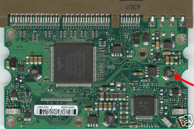

by accident I connected a wrong powersupply to my HDD and fried the PCB
Modell: ST3320620A
Firmware (FW) 3.AAE
Productnumber (PN) 9BJ04G-305
Mainchip on the PCB: 100404195
PCB number on the small sticker under the barcode: 100406534
Can anybody tell me which characteristics of the PCB or the HDD, that I have to buy, must match in order to replace the fried PCB?
Thanks in advance,
tae

Craig: Why the platter remover? Are overvoltage problems causing seized motors these days. :roll:
Re: Seagate Barracuda 7200.10 PCB
November 24th, 2008, 0:05
Usually you just have to remove the dead TVS unless the damage is more extensive.

November 24th, 2008, 6:49
here an image of the pcb, I am not really sure if that round thing is the TVS. ....thought those are the rectangle ones.
this part (red arrow) is completely fried, all others seem/appear ok.
I just got a disk with the same specs, except for the type of main controller IC. Otherwise the number of the board, FW, PN are the same.
Would this work, or would it not work at all. Disk is still sealed, so, in case there is not a relistic chance to revive my fried HDD, I would not break the seal.
thanks
November 24th, 2008, 6:54
the TVS is the black square component an inch or two above the part you have highlighted, just to the left of the top right screw hole.
November 24th, 2008, 6:55
but what is that round part that is fried....guess this board itself cannot be repaired???

Your fried PCB has a code of 100404195, what is the code of this new PCB?
Also, do you have the equipment required for soldering the 8 pin ROM chip over to the donor PCB?

Just swap PCB, you may be pleasantly surprised 8)
post your results here

Potentially a wrong controller chip as in ST vs. Agere.
Your new PCB is from a drive that is significantly newer, based on its datecode.
Matching PCBs can be a pain.
Then again, you may have the right PCB, as the disk spins up, but you may have other damage. Wrong ROM, damaged firmware, damaged preamp/heads. Those are listed in order from bad to worse in terms of costs to recover and require specialized software and knowledge to correct.
