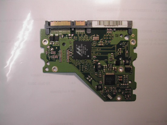

I put a 19 Volt alim on my external HDD box which caused the HDD not to work anymore. I bought a new HD753LJ in order to replace the PCB. I replaced it but I don't see the HDD in Disk Manager although it is present in Panel Control. The bios recognized it well. On the new disk the date of manufacturing is 2008/10 as for the old disk it is 2007/11.
I sent a message to a pro who told me to remove the TVS from the original board. I read few topics and saw that every time someone had to remove the TVS, a burnt area appeared on the PCB. In my case, I don't see any burnt area. Please see the pics.
Thank you for any answer.
New PCB on original Disk
Original PCB (back)
Original PCB

Finally, a friend came with a metrix that showed the TVS was fried so I remove it. By remove, does it mean simply remove the thing without doing anything else ?
Re: SAMSUNG HD753LJ - power surge
March 16th, 2009, 14:53
Just remove it !
March 17th, 2009, 11:28
It worked. Thank you very much ! :P :P :P

Hi, i think i have had the same problem right now, a smoke was emanated from that area (as shown "dead" above) because of a jumpy supply, my Hard disk is samsung HD753LJ, the same in the pics.
i want to know if i can remove the TVS (the burnt part) by my self or i have to go to a professional ?
should i remove the motherboard to remove the TVS ?
can i replace it (TVS) with a new one that works ?
are my datas lost because of this problem ?
please, if have a idea.
thanx in advance.
April 21st, 2009, 15:54
Better to send the HDD to a pro.
Probably there is also burnt preamp or something else.

October 5th, 2009, 10:34
my HDD is aliiiiiiiiiiiiiiiiiiiiiiive :D
I took a long time because I forgot it.
few days ago, I have gone to samsung shop, a "nice" vendor help me to remove the black "fuse" damaged (the one beside the dead one in the pic above), the idea is that the black fuses when they burn (one of them) they cut the electricity to protect the composites of the motherboard, so you have just to remove the burned fuse.
thank you again for your help, all the datas are in perfect state.

I am unfamiliar with the abbreviation "TVS". Some comments on this thread call it a "fuse", which is believe is likely inaccurate. That's no matter. What I DID find is that on my board, the component that is circled and marked "bad" in the picture reads like a diode (on the board, I have not removed it) and the component immediately next to it reads ".183" with the leads applied in both directions with my meter on the "diode" function. They both read "open" using the continuity check function.
Am I to understand that I can expect my drive to return to functionality by removing one or both of these components?
Please be specific in your answer, and thank you for your time.
December 11th, 2009, 11:15
TVS stands for Transient Voltage Suppression diode. In the event of the surge it will fry itself and create a short. Removing the fryed TVS after a short will allow the drive to power up again , baring any other problems.
