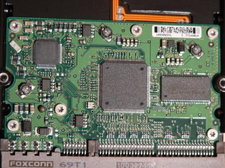

Will check out other posts regarding TVS but for now please see attached a pic of the PCB in question. Let me know if you need further info e.g. full details of what's printed on the chips etc.

Check the two black components bottom left, one going up/down, the other left/right.
Check them for continuity, they should NOT be shorted.

I got a multimeter and identified the shorted TVS - it seemed to be just one of them giving a '0' reading in both directions. I'm pretty sure it was the one on the 12V line (based on it's location near to that side of the power input connector).
The other one was giving a "1" in one direction and something like "485" in the other.
I used some mini cutters to snip out the shorted TVS from the PCB.
Then out of curiosity I turned the multimeter to measure DC Volts, turned on the original external enclosure power supply and measured the volts across each of the pins in the power connector (the one that was originally plugged into the Seagate HDD. The readings were a steady 12V and 5V across the relevant pins.
Then I salvaged an old Fujitsu 7Gb HDD off my very old tower PC, plugged it up to the external enclosure power connector, attached an IDE->USB convertor cable, and switched on the power.... the old HDD then spun up with no problems and when I plugged the USB cable into my laptop, it came up fine and I could read the data on the drive.

I've checked again with the multimeter - there's no short across the power input connector pairs now - both the 12V and the 5V pairs read "1" in one direction and "438" (5V line) and "832" (12V line) in the other direction. These same readings are given directly across the remaining TVS, and the place where the shorted one used to be.
Looking at the PCB I can see another component that looks like it might be a TVS near where the orange motor lines emerge from beneath the board. If you look at my original photo earlier on in this discussion, it's just below the "C" on the white sticky label, in the top right hand corner. I've measured this though and it gives readings in both directions so I assume it's not the same thing!
