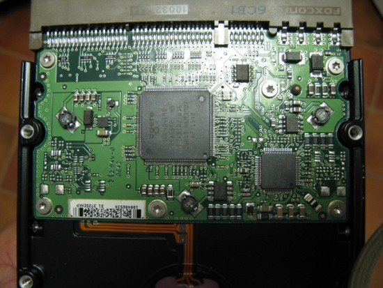

Hi all,
Friend connected her laptop power supply to her Maxtor External HDD, end result HDD no longer works. I removed it from it's case and put it in as a slave in my PC to try & retrieve the data, once the HDD is connected the PC won't start at all, as soon as it's disconnected PC starts fine. I have been doing some reading of these forums and thinking it may me just the TVS if it indeed has one. No idea what it looks like so am posting a pic to see if someone can point it out for me so I can remove it, not interested in keeping the drive just want the data off it if possible.
The HDD inside the enclosure was a Seagate Barracuda 7200.10, 500GB
S/N - 50G0Q4S0
ST3500630A
Firmware - 3.AAE
Thanks in advance...

You need to remove the 2 big 2 pin component under the FOXCONN line, next to the screw of the top right corner.
If the drive does strange sound or does too much heat in the "smooth" labeled part, than shut down the power immediately, and seek for professional help.
This is all what you can do, but this is not 100% safe, because you can have damaged preamp as well wich can erase the magnetic domains from the surface, or damaged pcb wich can do the same thing or burn out the good preamp and so on....
If you want to be 100% sure, seek for pro now.
results-the-yourself-solutions-t11912.htmlBest Regards,
Janos

Hi Janos,
Just a follow up "Thank You"
Removed the offending TVS (after testing them both with a multimeter) and voila once plugged in the PC started fine,copied all the data as required...I had one very happy friend thanks to you.
Cheers mate!

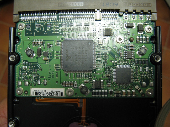

I have a very similar unit to this, the board looks identical in layout. It's suffering tha same issue, as soon as the power cable is connected to the disk, the PC refuses to power on (power LED flashes). I can't see any damage to the TVS, is it possible it's broken without visible evidence?
The unit is a 500GB Barracuda
ST3500630A
9BJ046-500
F/W 3.AAC
Date Code 06522
Site Code AMK
The disk is a neighbours, I have no history of what caused the disk to stop

Yes, it can be damaged without appearing so visually.
If you have a multimeter, you can test the component.

Can't remember the values off the top of my head. You can pick one up cheaply somewhere like Maplin. If you have a similar drive, you can check the values on it.
You can always just remove the TVS, it won't cause any short-term issues. If your drive then powers up, copy the data and replace the drive.

Thanks for the help, removed both TVS units, it was the larger of the two at fault although neither appeared damaged. The drive now powers up and doesn't sound damaged, although it now has no voltage protection and needs replacing on that basis alone.

I measured the two TVS diodes on my hdd's PCB with a multimeter on Diode setting. Right TVS (closest to screw hole) is 627 mV and other is 481 mV. The second seemed a little low but it's close enough to the cross-over threshold and I would considered it a good TVS.
My Seagate ST3750330AS is bricked right now - not even spinning up. Unsuccessfully tried the solutions for BSY state and LBA 0 (bad firmware SD15???) B4 I came here. I was considering the solution in this thread: taking out the TVS's to get it going. But looks like i should hold off and check some other values around this PCB. Did a search for similiar PCB and so far turned up nada.
Anybody have suggestions for other measurements? My untrained eye can't spot any anomalies on the PCB to raise my suspicions. Only other possible cause outside a bad PCB component is a stuck spindle and tif this is the case I am in the water for a DIY.
February 11th, 2010, 2:41
If it doesn't spin up, then it isn't a firmware issue.
If the motor is seized, you should be able to hear or feel some slight vibration or buzzing.
Can you upload a detailed photo of the PCB?
