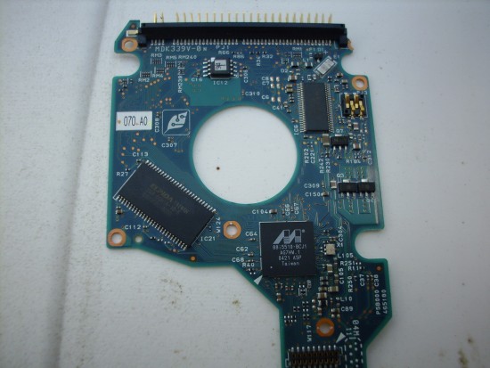

As stated, I am trying to revive a Toshiba HD 2188 hard drive. It is a MK8025GAS B ZE01 T. ( This is my friend's hard drive, he can't afford a data recovery place, so I am doing my best here) Here is the story. The laptop got some water on it, and then all it would do is a continuous booting cycle. I Have his identical laptop, so i tried his hard drive in mine, and it pretty much did the same thing. I tried to run checkdisk, and it said " it has one or more unrecoverable errors" The hard drive would not spin on startup. I located a PCB, with the same model and firmware number that I stated, the only difference being the the controller chip. My controller chip is 88i5510-BCJ1, the controller chip in the new board is 88i5510-BCJ. I installed the new board, and pu it in the laptop. The laptop would not recognize a hard drive being installed ( it did with the old board) but the hard drive spun up and ran without a problem ( which it did not do with the old board) This is where I am now. I am trying to locate a board with the same controller chip now. Given what I have done so far, could I possibly recover the info on the disk?

A simple PCB swap on a Toshiba drive will NEVER work for you. These PCB's contain adaptive (drive specific) data embedded within the CPU. Swapping the CPU requires expensive equipment and skill as the chip type is BGA.
You could find a local electronics specialist with the right gear for BGA rework and have them swap the CPU to the new board.

You don't need to change the CPU on this model - just swap IC12, an 8 pin DIP.

Without seeing the PCB, I suspect that IC12 is a serial EEPROM which stores part of the drive's firmware and the "adaptives" that were mentioned elsewhere.
Just search for the part number, eg 29LV512.

Jono is right about this one, I haven't looked at one of those PCB's for a while. If you want to be 100%, post a pic of the PCB
Re: Toshiba HDD2188 hard drive revival....
September 20th, 2009, 13:03
Here is a picture of the board....
September 20th, 2009, 13:21
Ok, if all I need to do now is change out IC12, do I still need to get another PCB with the same controller chip? The original board is 88i5510-BCJ1. The one on the new board is 88i5510-BCJ. Both boards are MK8025GAS B ZE01 T, same firmware. If the eeprom is switched over, does the controller chip matter?

I've read a few other post here and on another forum where swapping the IC12 chip to the new board has been successful, so I will try this. I just need to know if that controler chip needs to be the same # as well. If so, I need another board. if not, the donor board I have now should work. That is where I am sitting as of right now.

just do it....and if it doesn't work, then go searching for an exact match pcb. You have nothing to lose at this point.
